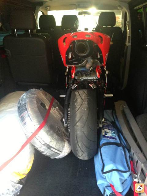

  16. Bike loaded into van for Mugello. The Bikegrab works great :)
