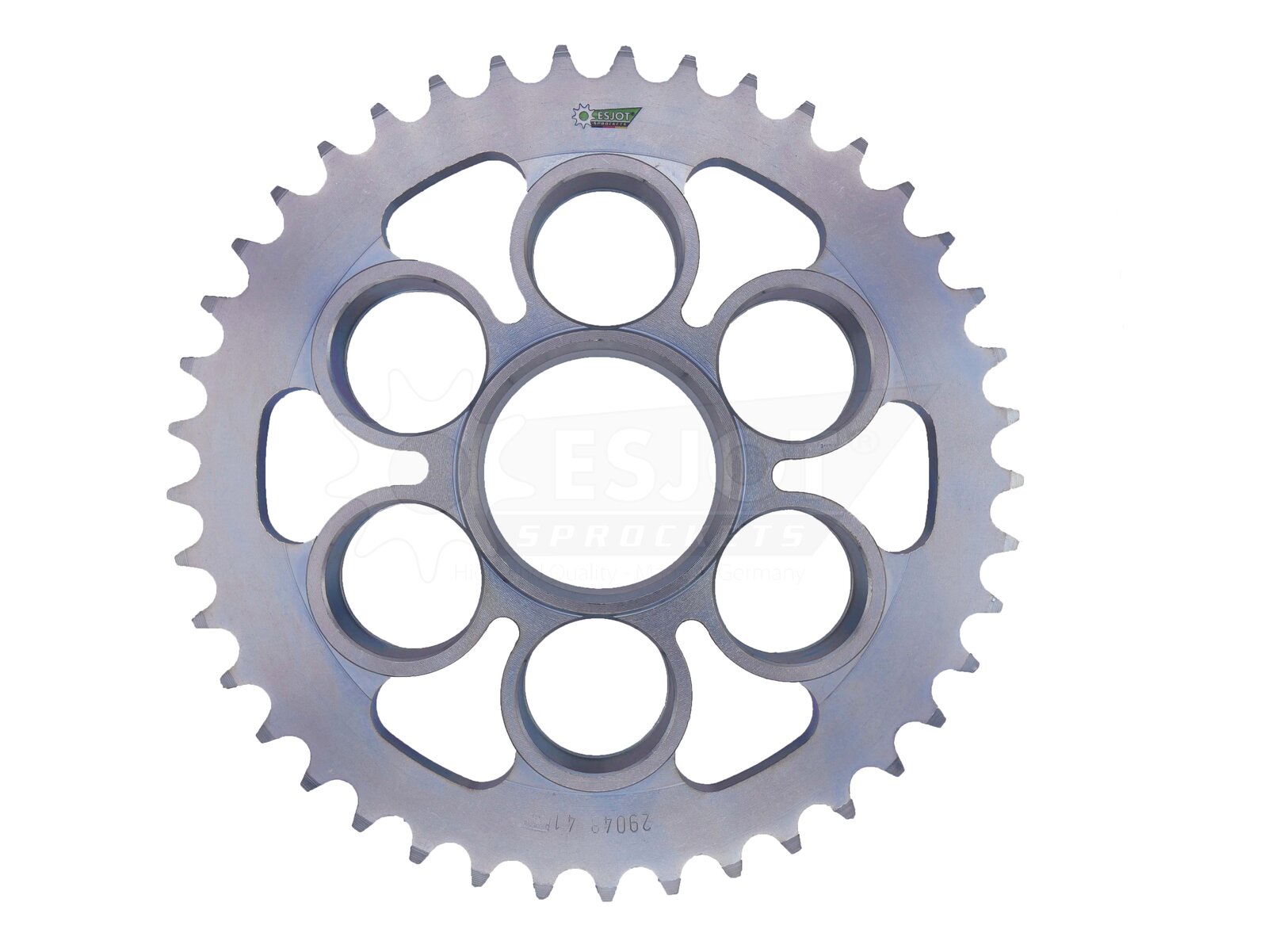

  7. As @Michel wrote, many options are available. My rear solid steel one piece 42T is an Esjot sprocket from Germany.
    https://www.esjot.com/en/motorcycle-sprockets/
    I got it from CarpiMoto in Italy. Good product and price.
    If you want a quick change carrier, choices are endless.
    I have Superlite brand on my Monster and also went +2R.
    However, truth be told, the black quick change carrier is mostly for the bling as I'll never further change the gearing.

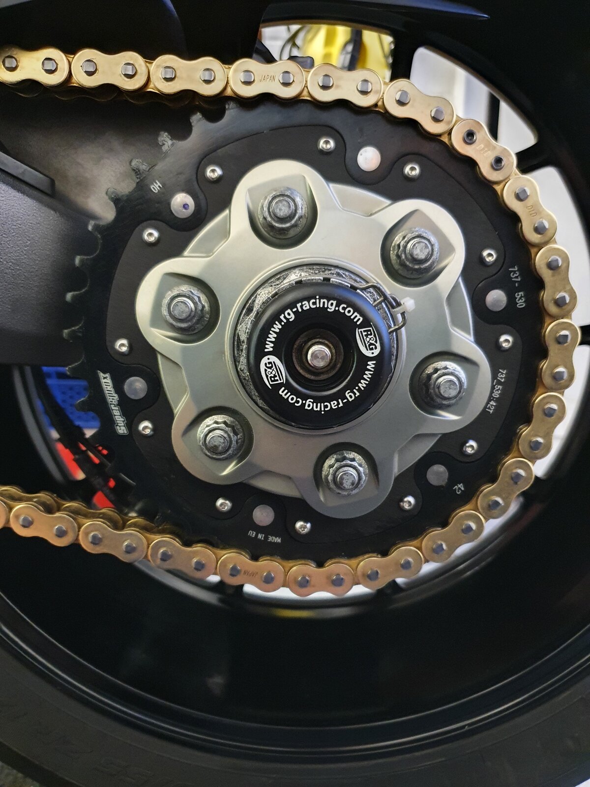

  8. I’m doing a swop on my mates 1260 this weekend. Just got the DiD zvmx today. Supersprox Black +2 rear & 15 run quiet front. £227 the lot. Not the cheapest but Esjot rears are a little thin on the ground.
    I contacted a few shops who stated “in stock” but simply not the case.
    Anyways, he’s paying and was happy enough.

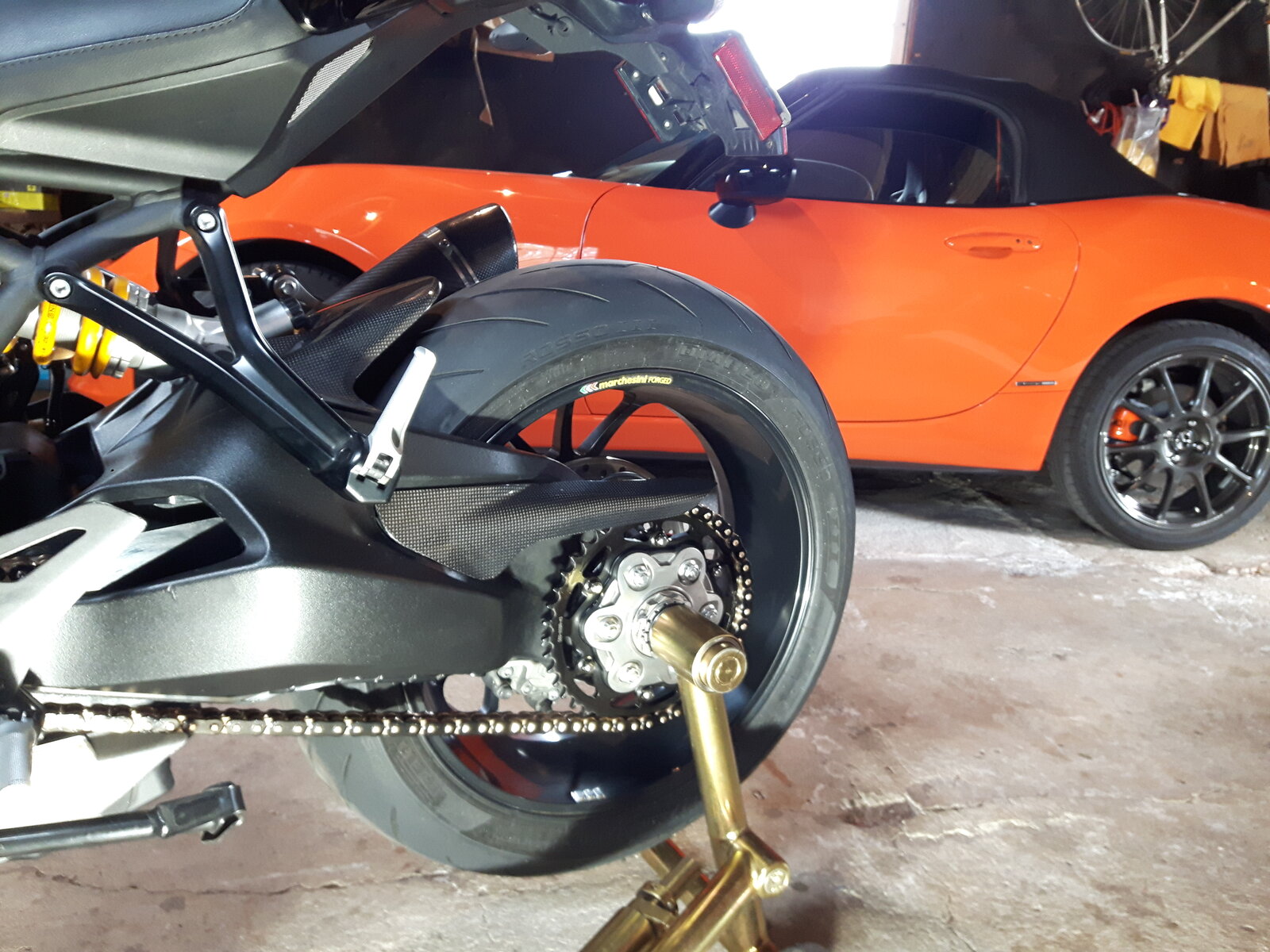

  19. Just fitted new C&S's and quality is much better than standard chain and sprockets :blush:
    Cost me a feckin fortune tho lol, new torque wrench, nut socket, impact wrench and chain splitter/riveter set . It would have been much cheaper to let Ducati dealer change them when it's in for its service, but at least I've got all the gear now for next time I change them :)
