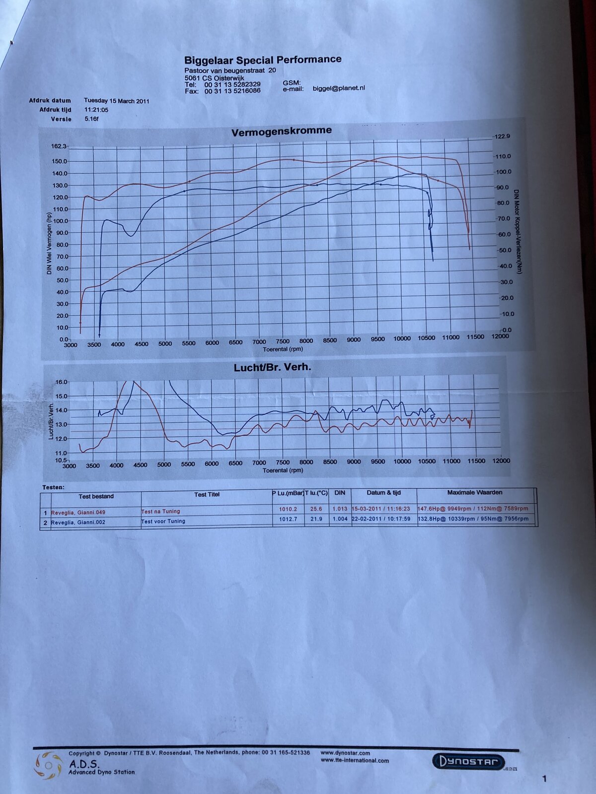

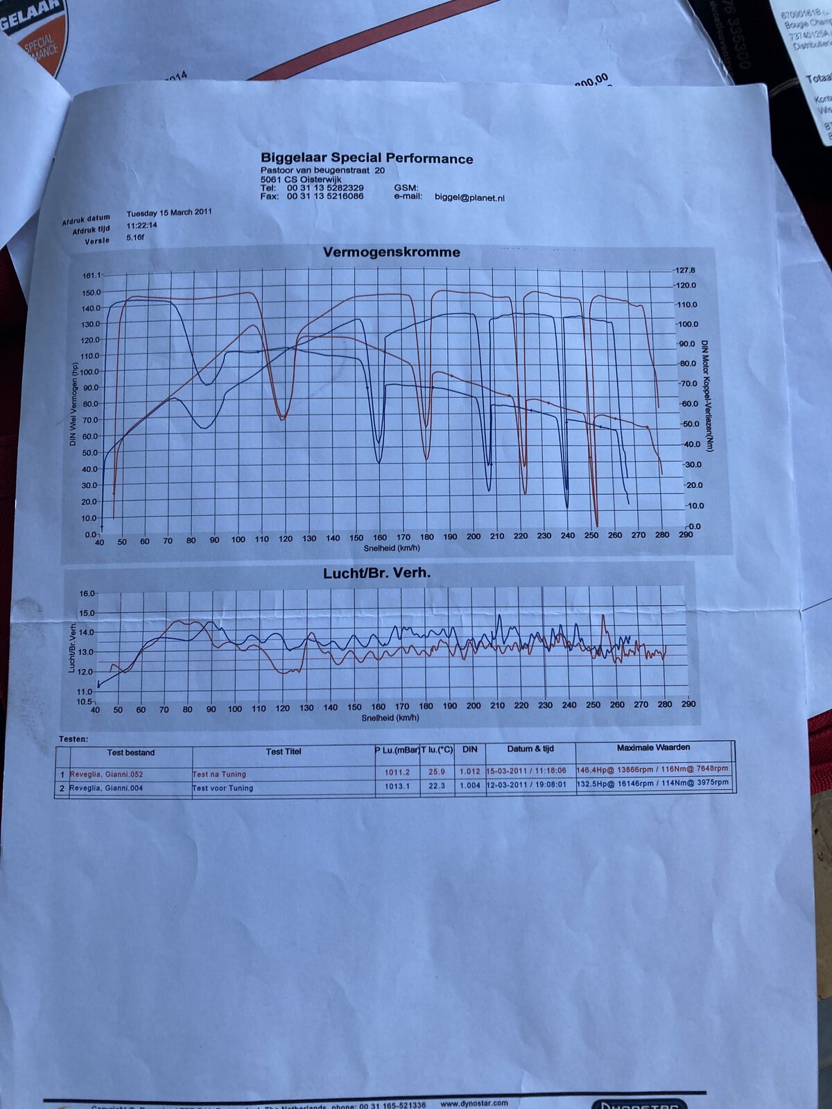

    Opinions are personal, some swear with porting others don’t. I often heard that if its tuned bij Biggelaar they don’t want the bike, mostly dealerships for a trade in. Well its simple, we don't get to do any business.
    Both my 998s went their and its all perfect. An honest before dyno run and after. Mine went from 132 -> 147hp and those are rwhp. You can send your head alone and they will port them, keep in mind you still need to reprogram the ecu on the test bench.
