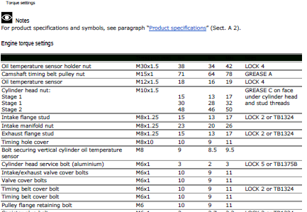

    I'm sure this is very obvious, but I can't find an answer via search. Why are there three torque settings in the service manual for some engine things? Always in the same pattern, mid, low, high. Is tightening a five stage process? Torque one, back off, torque two, back off, torque three?

  5. Where you have one line of values per component/fastener, the three figures are nominal/low/high torque figures. The low and high are usually 5% or 10%, so for the nominal 38Nm, you have a low of 34 and a high of 42.
    Where there are "stages" listed as per "cylinder head" for instance, the these are torqued down in three, increasing stages to ensure the heads go down square and you get a consistent pressure build up on the composite gasket. Again, the three figures listed against each stage are nominal/low/high.
    Rule of thumb; Always set your wrench to the nominal. The tolerance will allow for any discrepancy in the wrench' calibration or accuracy.
