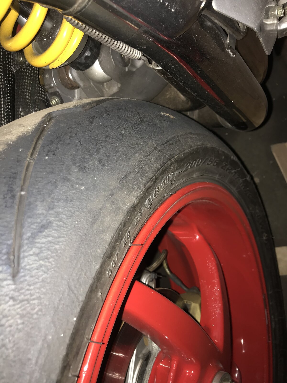

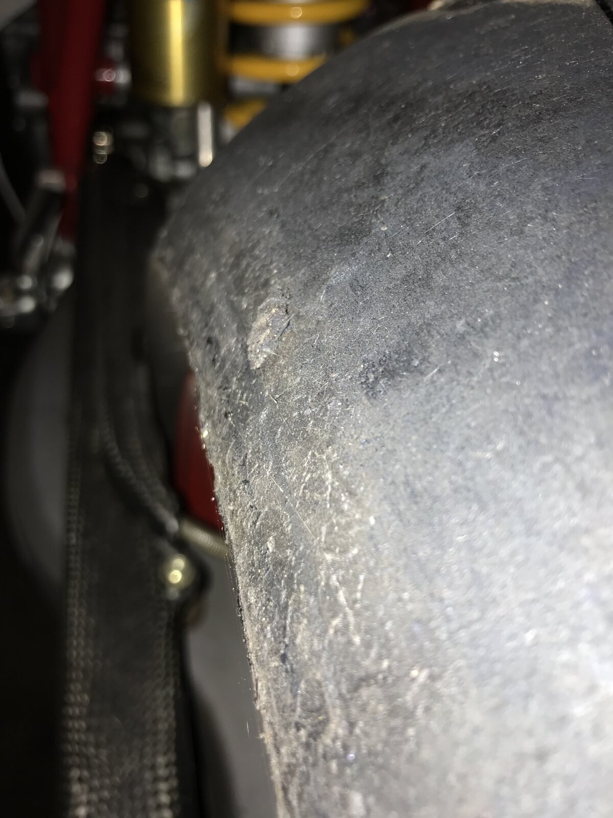

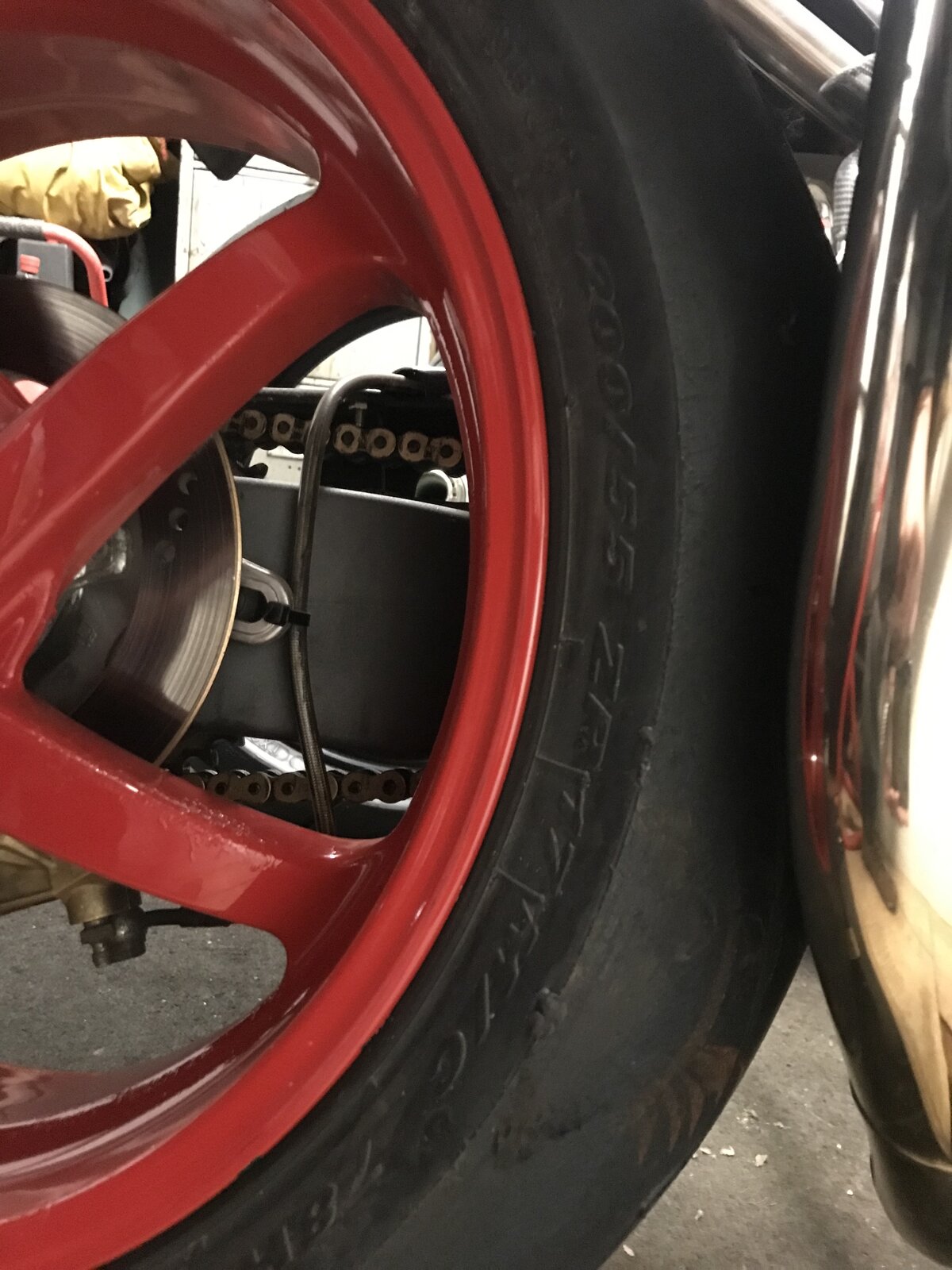

  7. i have 1 fitted in my 996 with a 6" magnesium marchesini . no issues at all
  8. Thank you for the information 224stu, I am now more comfortable in purchasing a 200/55 knowing it's doable.
  10. Thank you again for the pictures 224stu, I noticed you need to set the wheel in the more forward position (hub eccentric), is this to avoid the tire from rubbing the swing arm?
    Because it also make it very close to the exhaust midpipe...
    My exhaust pipe is the 60.5mm Motocorse so I worry my exhaust midpipe will be even closer to the tire than yours...
    Is there still a room to move the wheel more backward (longer wheel base by adjusting the hub eccentric) without rubbing the swing arm?
    Do you think a 200/60 will have more clearance to both the swing arm and the exhaust?
    Thanks
  11. i had to cut the chain guard out on my bike with 6 inch wheel and 190 tyre on it but yes it will fit.
