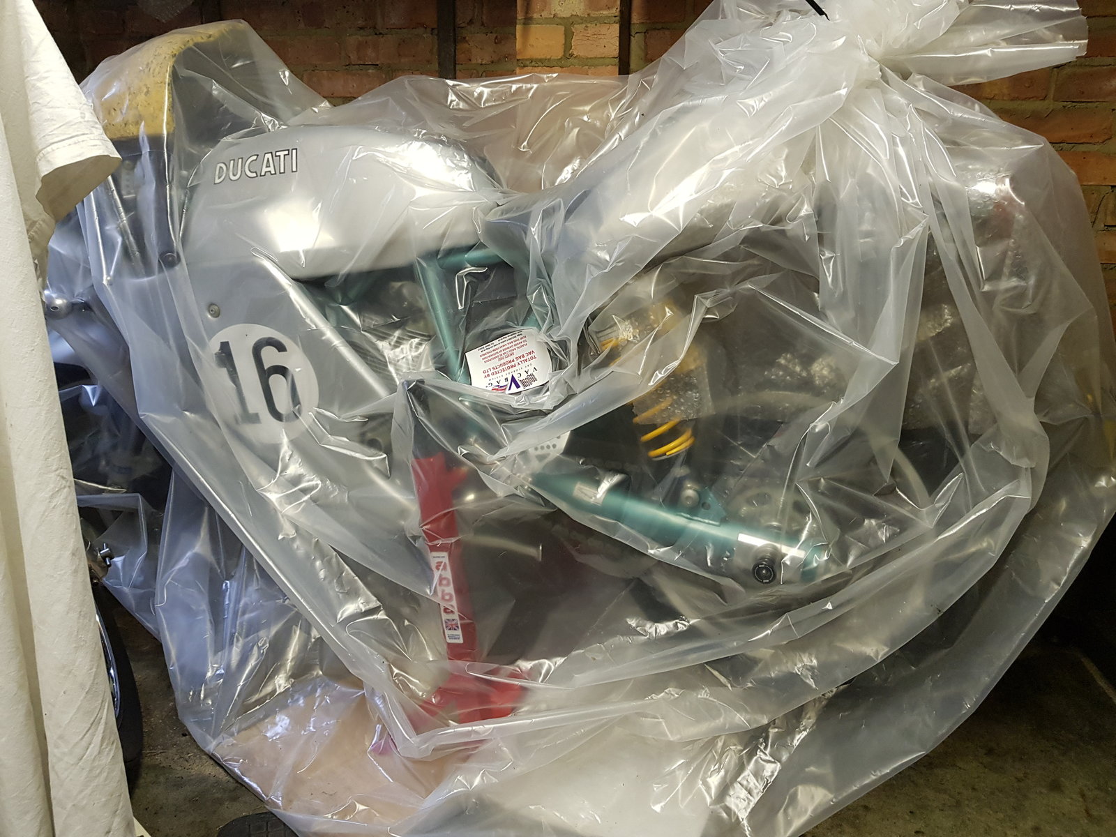

  1. Today I packed my Paul Smart 1000 away for the winter so hoping it will still be perfect next year:
    * Removed the mirrors and packed separately.
    * Drained the petrol.
    * Removed the battery, to be charged separately.
    * Positioned the bike on an Abba stand, with both wheels off the ground.
    * Put it inside a Vac-bag along with a packet of Drisorb granules, and sucked out the air with a vacuum cleaner.
    https://www.abbastands.co.uk/
    https://www.vac-bag.co.uk/motorcycle-vac-bags.html

  2. Very professional:upyeah:

  8. Looks great Pete
  9. I usually prop mine up against the lamppost with a tarp thrown over, each to their own.
    If you ever decide to sell let me know!

  15. Goodness gracious me. If I did that (although I'm envious and it's very professional) I'd run the risk my wife would think it's been bagged to go to the dump and that might be the last I'd see of it :scream:
