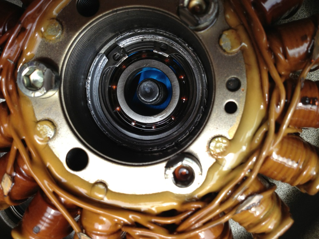

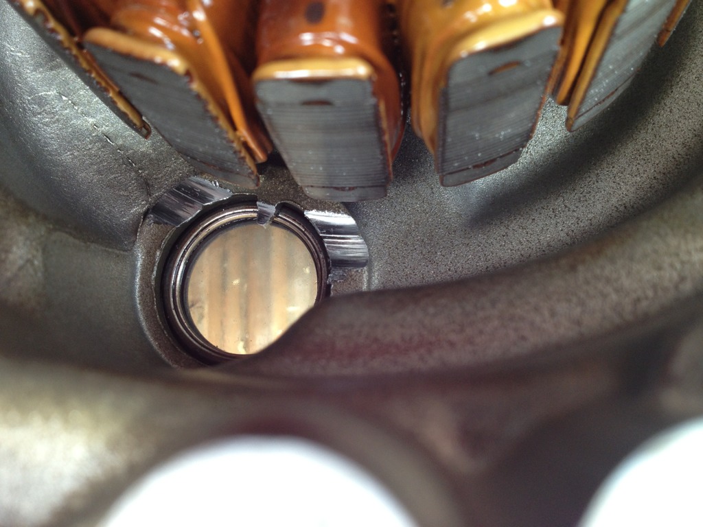

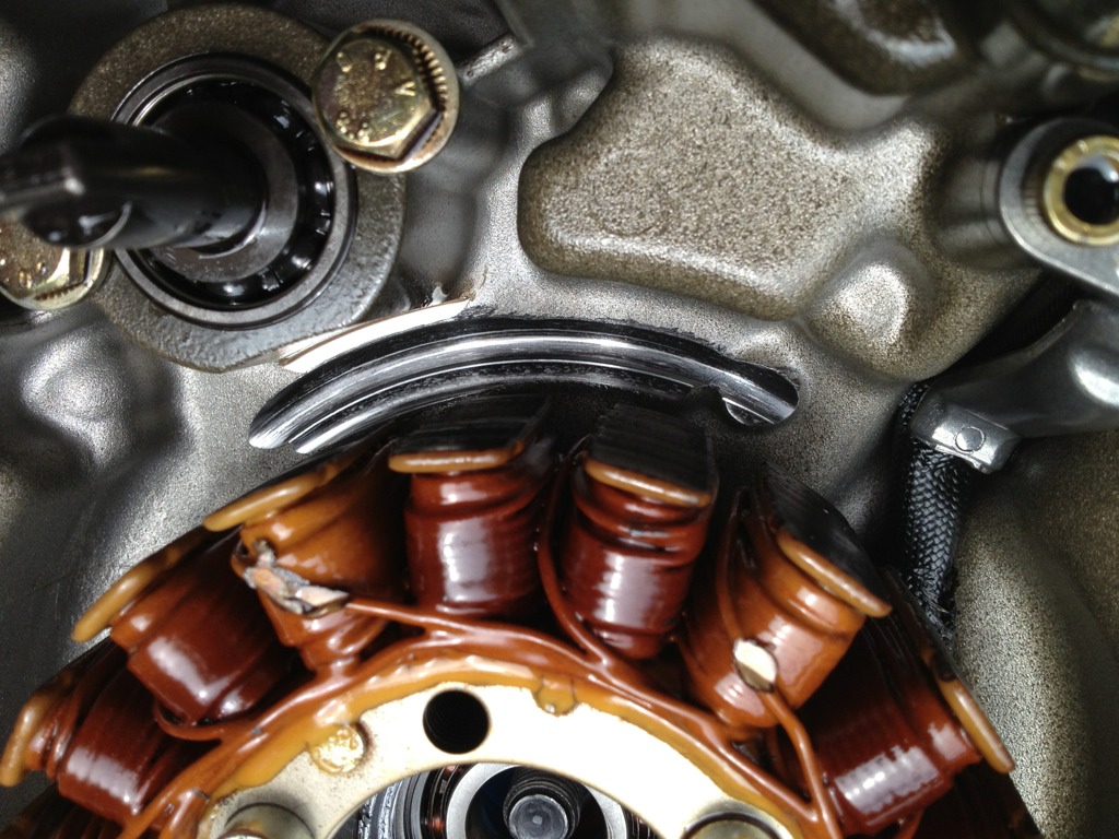

  15. It's been a while since I posted on this thread , my bike is still not on the road but I have managed to get hold of an engine and all but 2 of the rockers are ok.The VA camshaft was no good so I got one off ebay(£30). At the moment I'm waiting for the 2 rockers to come back from Newman cams then I'm going To build the heads up and have the valve clearances set by Italsport in bury. I need to use the alternator cover off the new engine but when I removed it today I noticed some deep scoring inside,I only want to use the actual casing,is this still ok. ImageUploadedByTapatalk1368790300.087449.jpg ImageUploadedByTapatalk1368790320.211195.jpg ImageUploadedByTapatalk1368790349.403527.jpg
