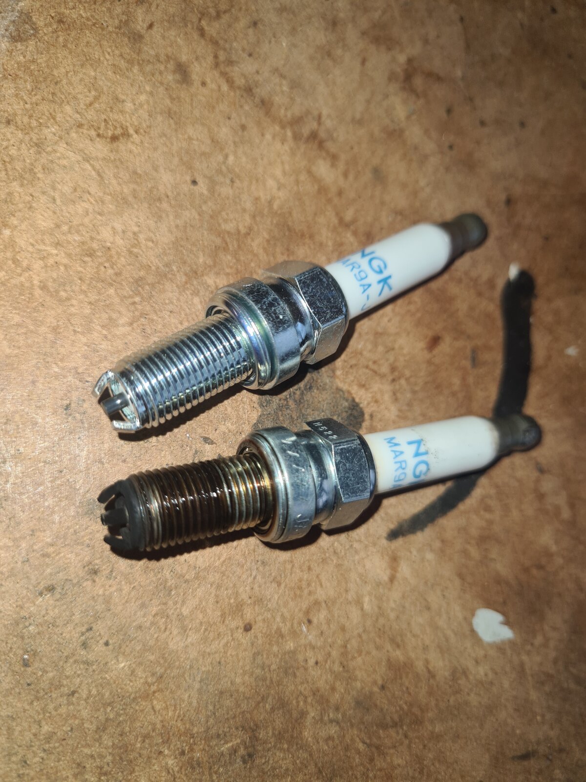

  19. OK, Status update and GOOD news!
    I finally (!) got the replacement plug from Opie Oils (NGK MAR9A-J). Fitted the plug along with a 2nd hand HT lead and Coil pack from a v2 (same part numbers as the 899).
    Ignition on. Starter button pressed and she fired up and sounded sweeter than ever.
    Ran up to 102C when the fans kicked in and no problems with misfires etc.
    I think the plugs must be the originals, it was serviced by Ducati before I purchased it at 7500 miles but it looks like the original plug (plugs get replaced at 15k miles I believe).

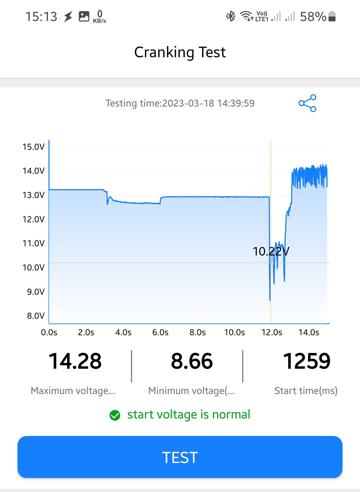

    I also tried the battery tester and it shows the voltage didnt drop below 8.66v when cranking, so I think Ill leave the lithium battery as is for now.

  20. Oh and PS, I measured the gap on the new and old plugs - about 0.95mm on the old plug, 0.7mm on the new ones. So that could have been a contributing factor as well.
