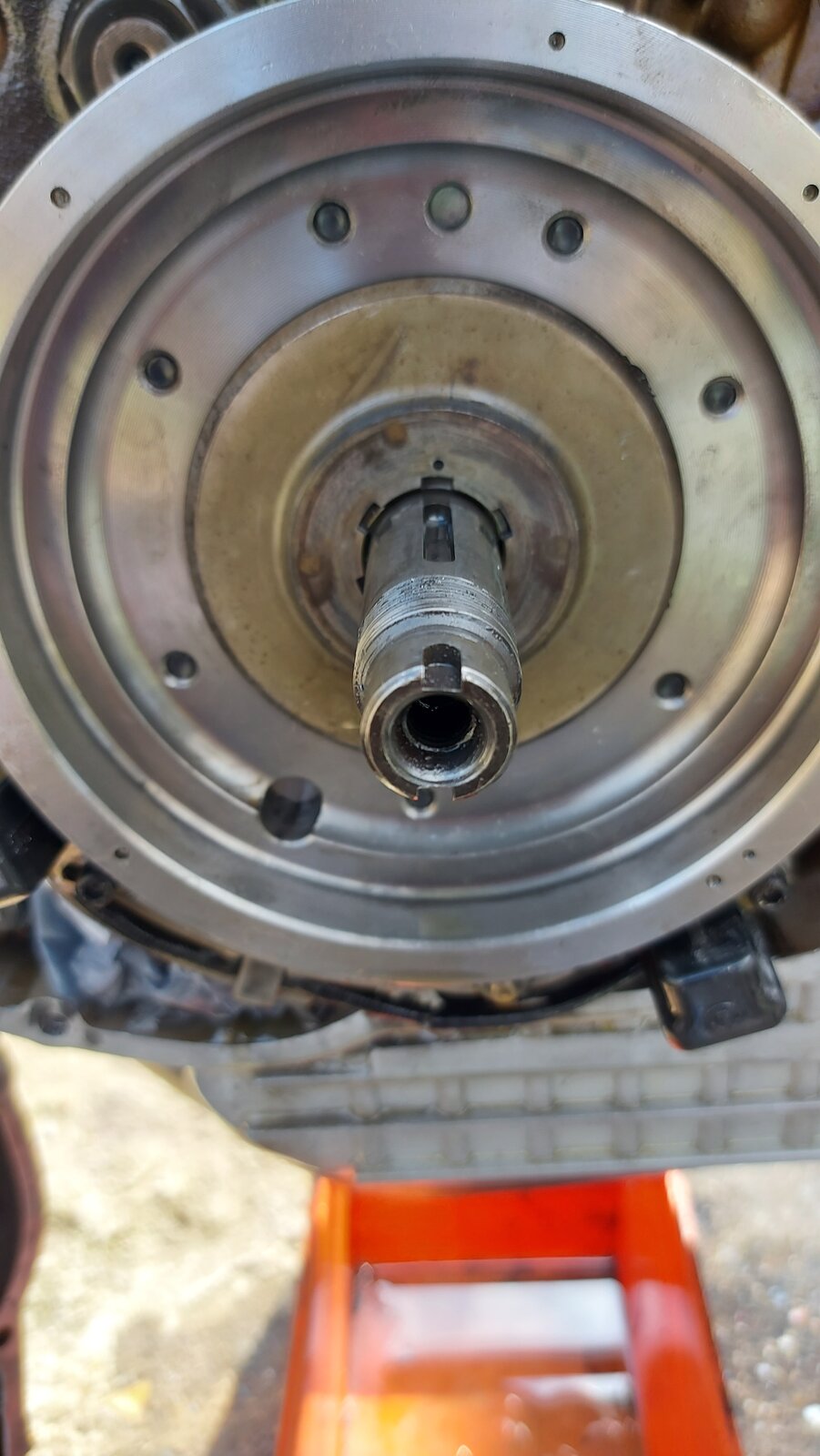

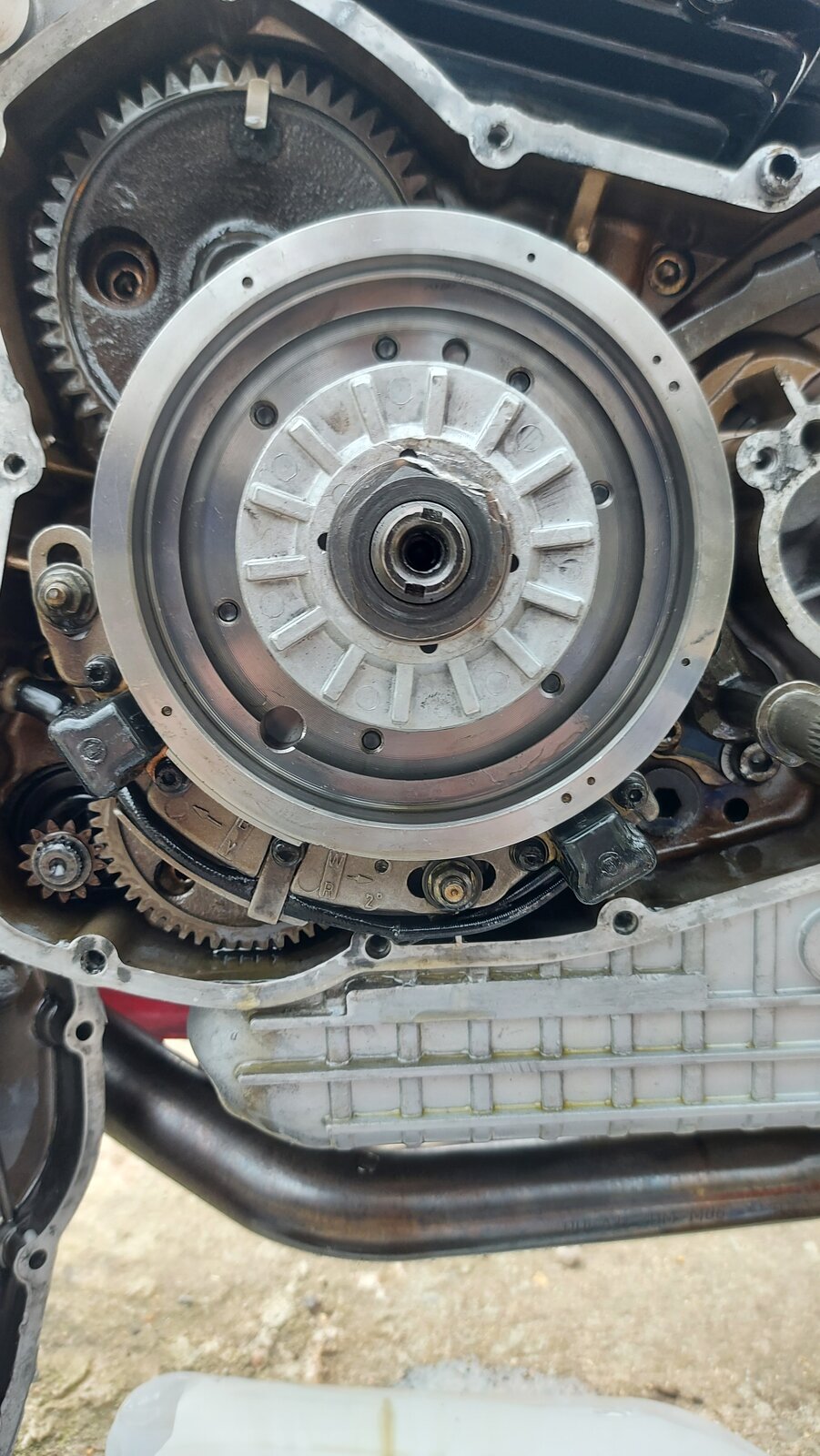

  2. So bit the bullet and pulled the ignition side case off and I hope some can confirm im a complete idiot and put the fly wheel on 100° odd out. Engine is set to TDC on the horizontal cylinder according to the marks on the fly wheel, and checking the cylinder, but I belive the pick up marks should be above them and their at the top??
    #3 Lumbux, Mar 7, 2021

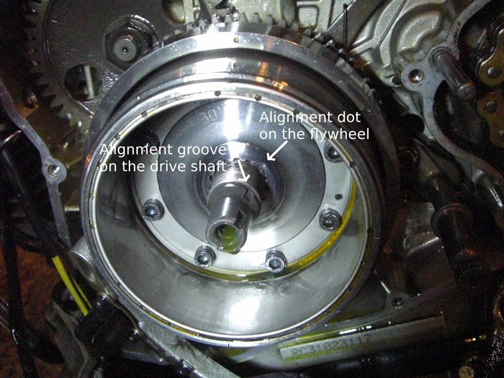

  3. from memory, with the horizontal cylinder at TDC on the compression stroke and the timing arrow on the timing case pointing to the TDC mark, the second set of timing marks (counting turning the engine anti-clockwise) should align with the two pick-up centres.
    I can't think why you would have assembled other than this (similar to yours):-
    also, you didn't remove any gears behind flywheel and starter ring?
  4. So timing marks is as per the Haynes in line with the key way so not now sure!!
  5. so flywheel is fine, did you remove anything else, gears behind flywheel??
