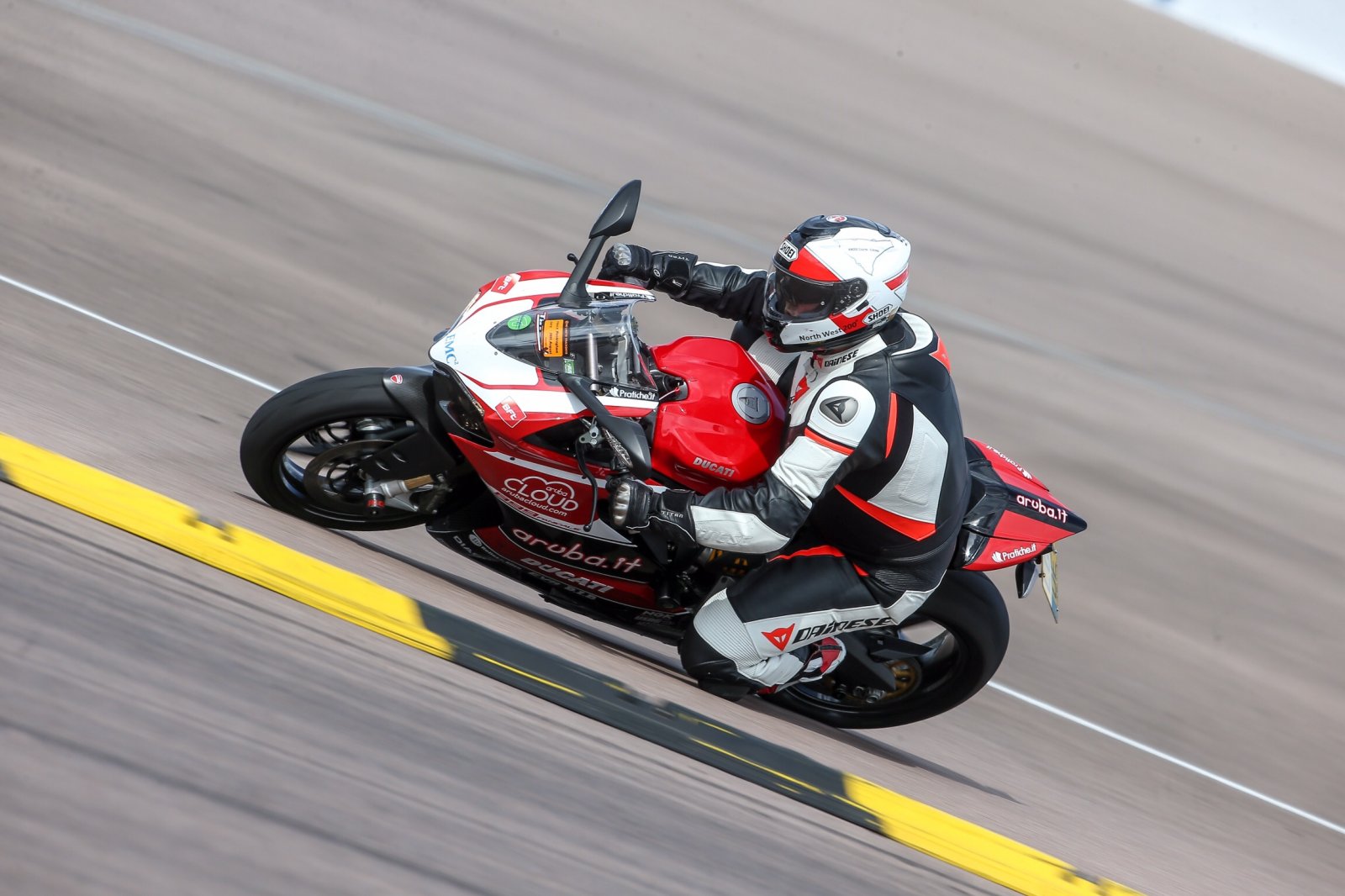

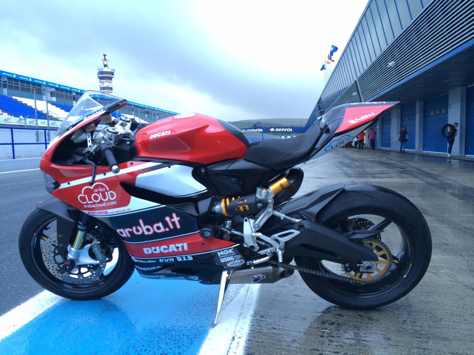

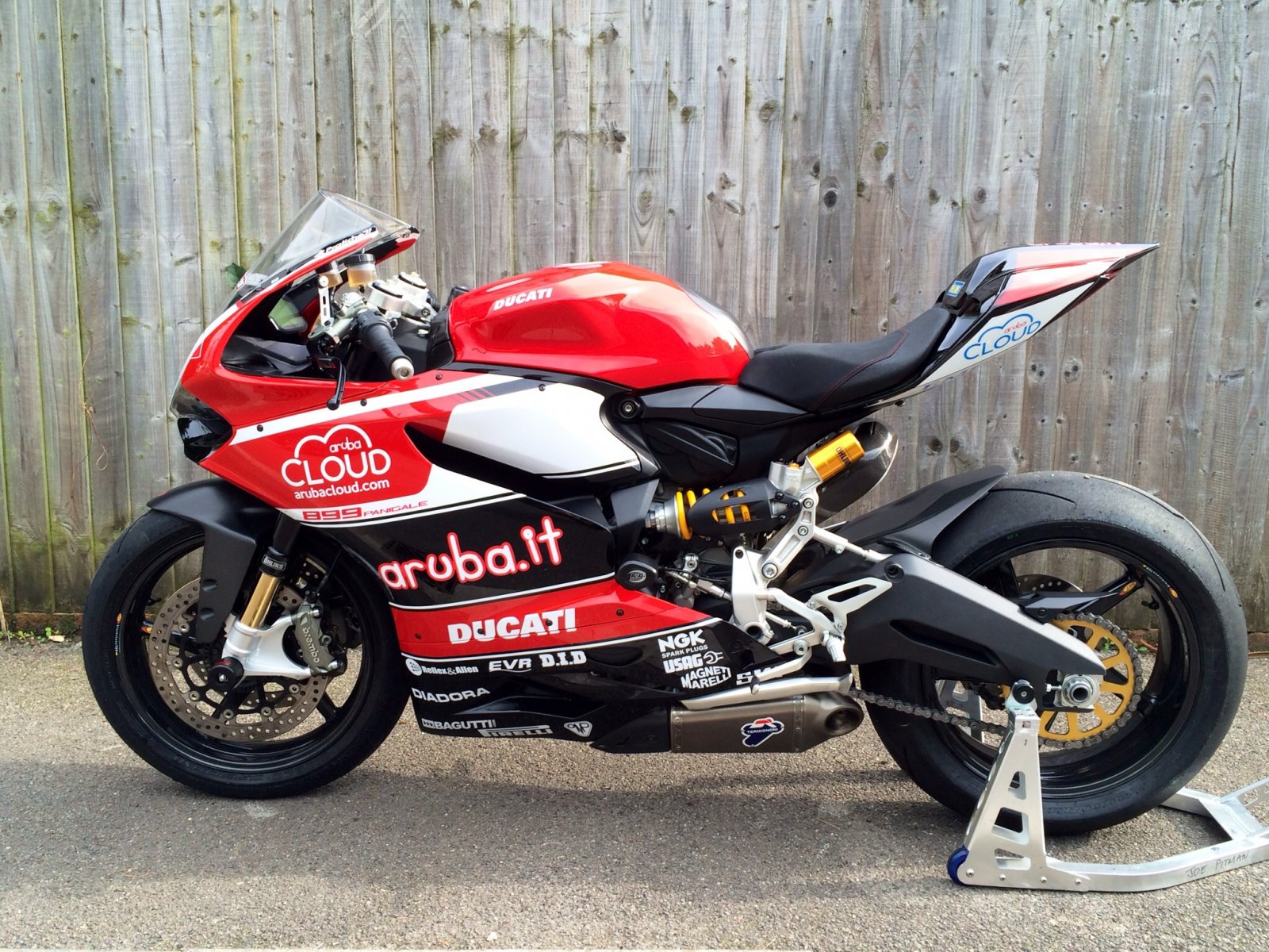

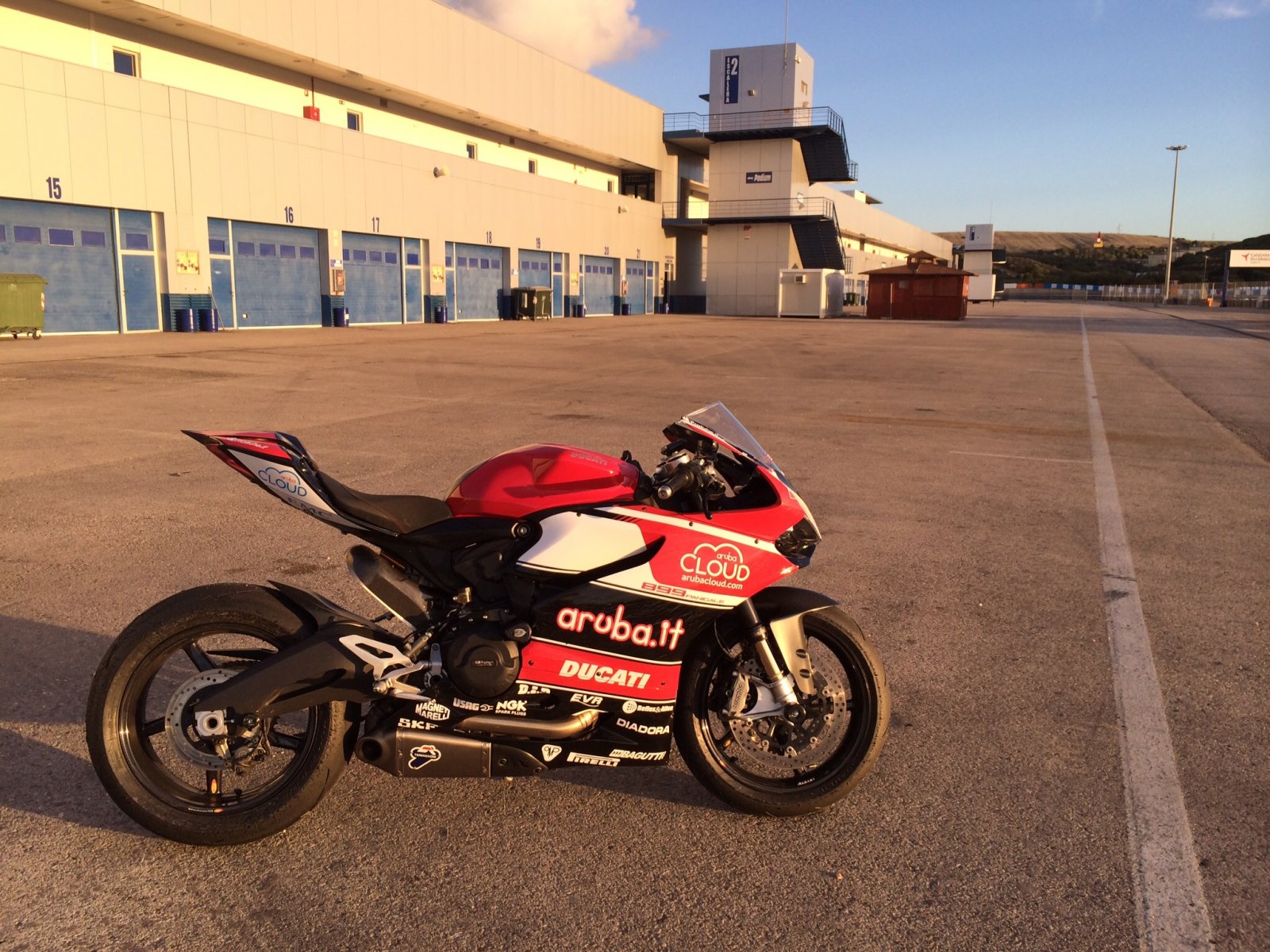

  1. Hi everyone, first post.
    Thought I'd share the work I've done on my 899, which I did last summer prior to a trip to Jerez. I concentrated on the big bits first:
    • BST carbon wheels
    • Ohlins forks
    • Ohlins shock
    • Termis plus map from MotoRapido
    • Race air filter
    • Painted bodywork from Italy
    • Performance seat
    • Various carbon fibre
    • Full R&G crash protection
    • Ride height adjuster from a 1199
    Bike was very good at Jerez, although I did run in to the gravel in the damp and snap a few bits off.....
    What's next, (when I've finished building my new workshop which is worthy of its own thread):
    • Brembo M50s (brakes are this bikes weak point)
    • Ducabike rearsets
    • ASV levers
    • 14 tooth front sprocket
    • New screen
    • Fix the bodywork
    • Perhaps an ohlins steering damper
    • Oil and filter change
    • New SCs
    • Almeria 20-22 April
