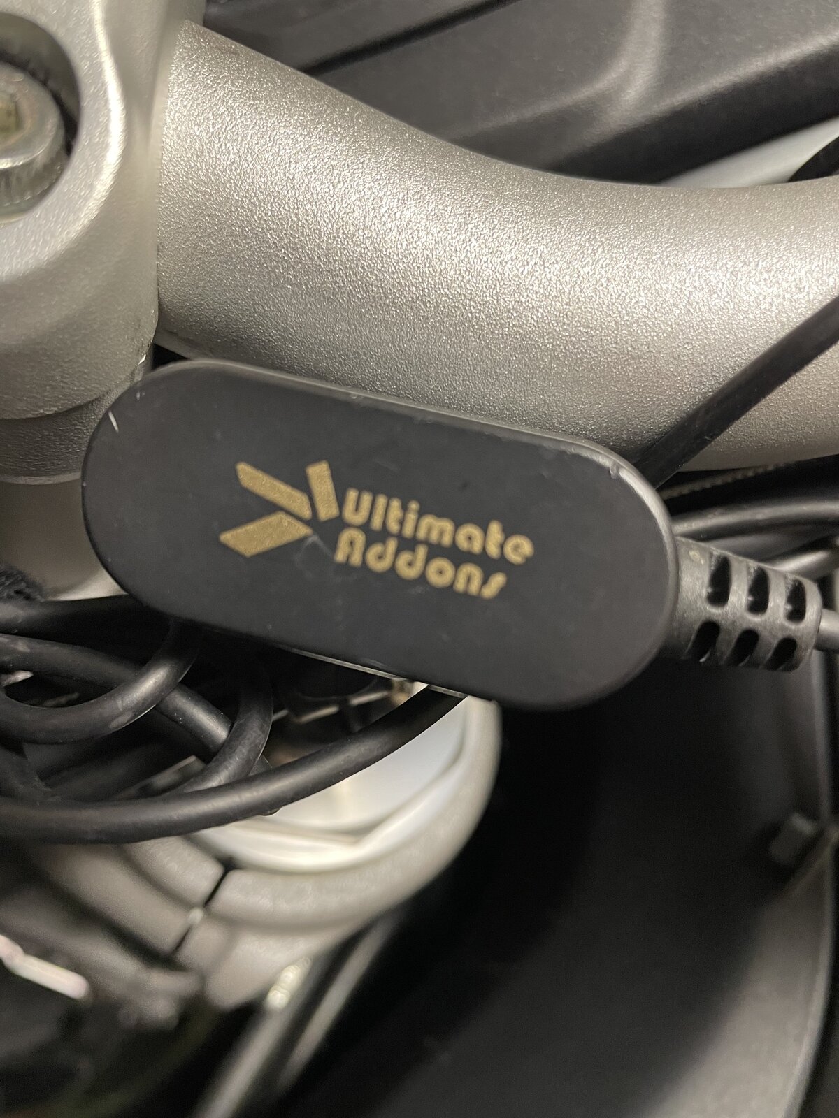

Now doing a trip in September across the top of Spain and up through France so thought I would prepare…. I use the Ultimate Addons case and holder so as there is a hella socket on the Multi I ordered their charging adapter but thought it could be a bit tight. What an awful position for yet hella socket! This adapter is a 90 degree one and you can’t use it. Whichever way you fit it, the handlebars hit it. will have to get a straight socket with lead…..

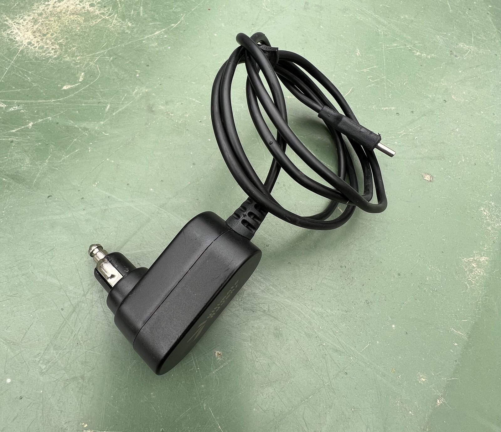

I use one of these to provide power from the DIN socket on my 1260 MTS to my Givi Tank bag. The flat back and edge opposite the strain relief catches nicely on the spring loaded lid of the socket. Effectively locking it in place.

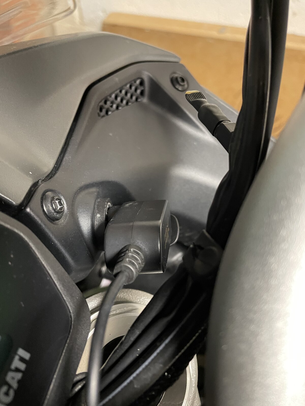

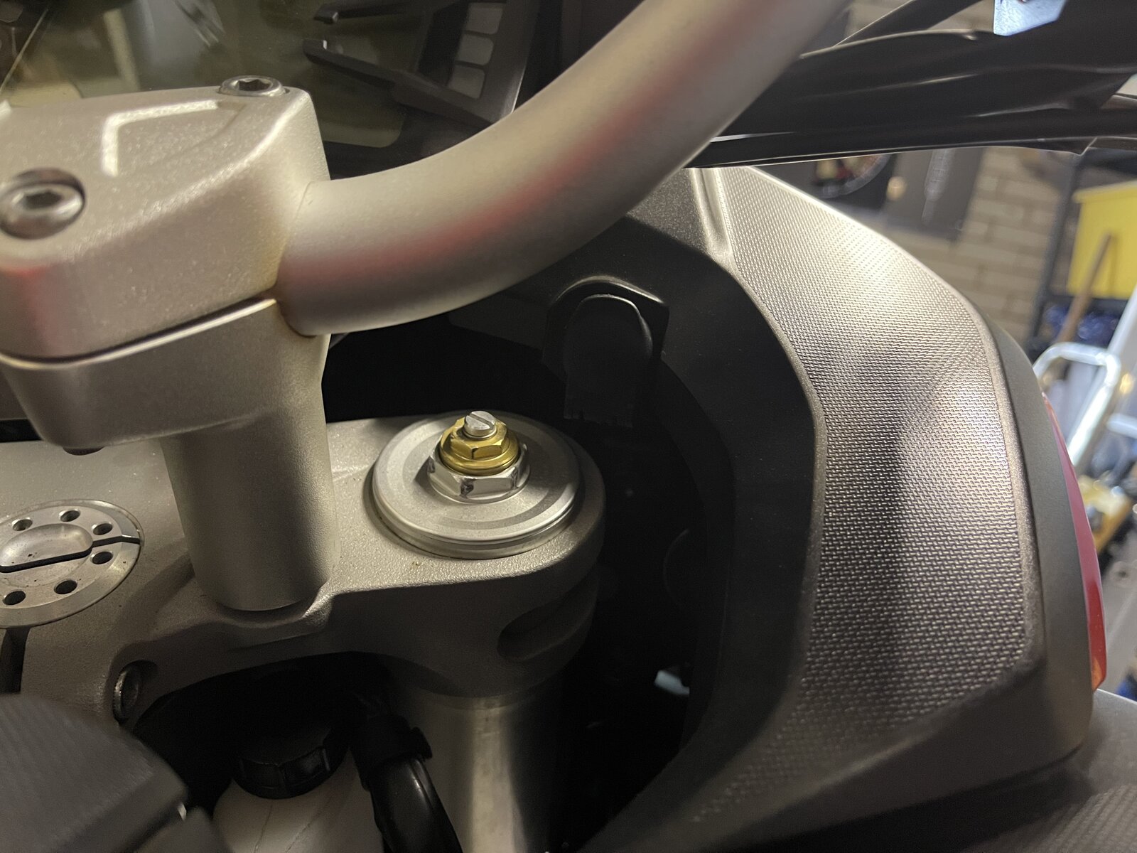

Is your din socket in the same place as mine? I was thinking a straight plug in one with lead hidden under the right hand plastics
Yes, in the same place. With the plug in the socket and held in place by the spring loaded lid the cable exits upwards IIRC. The cable is a curly one and plugs into the gland socket on the front face of my Givi tank bag, threading through between the bar clamps. The curly cable gives some flexibility which helps. Once in place it doesn't move or disconnect. I did learn the hard way that it should be plugged in with the ignition off after I managed to blow the accessory fuse twice on one tour plugging it into a live socket... Givi S111 Power Hub, I cut off the DC connector and soldered the 90º Hella plug on it's place. If you want to power your phone directly then one of these may work, I have no experience but it looks slim enough to work on the MTS without fouling the bars.

That damn Hello/Din plug is such a useless piece of hardware. It's bulky in the best iteration and often prone to get loose. I've purchased a few different ones and they're all iffy at best. The jack location is also highly questionable. Personally, I would have just preferred a USB or an SAE jack. Many DIY guys have converted the DIN jack to a USB. I don't have that skill set thus I've fished a USB cable up-front. The same can be done for a 12v SAE cable.

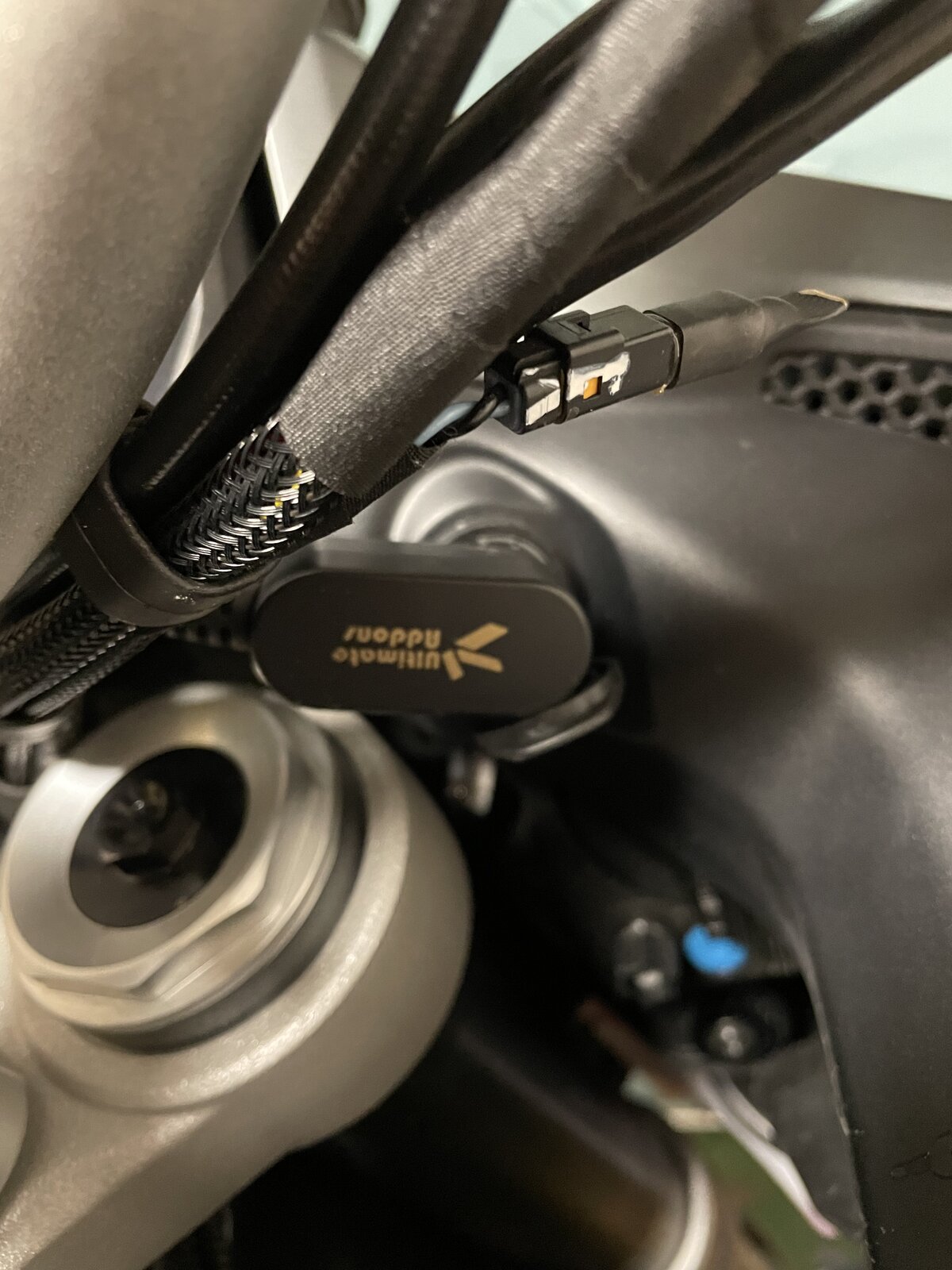

Hi, I use this from ultimate addons, does not catch on handlebars, fits quite well and allows full movement.

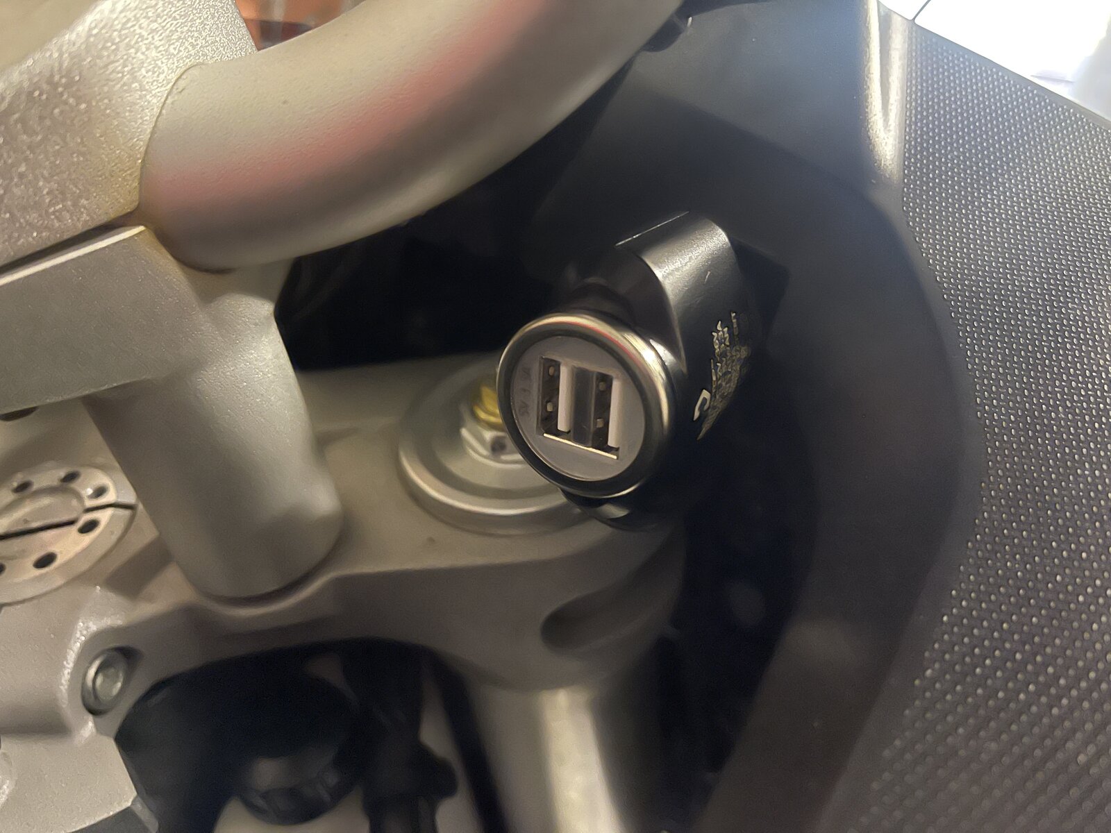

I ended up with one of these - admittedly it is on a V4 but doesn't interfere with the bars and stays in the socket plus it is intelligent and only powers a USB device when the engine is running and the voltage is up to the required level. O105 Dual USB Charger — OptiMate UK May be hard to find - mine came from the US!
I’ve ended up with this from Amazon which looks big but fits perfectly with no issues with the handlebars. I already bought a lead so should hopefully be able to route that across and then up to the bars where the phone will be….

Just ordered one of these from amazon. OptiMATE USB O-115v2, 3300mA dual output weatherproof USB charger, with BIKE plug (fits BMW, Triumph, Ducati Multistrada) : Amazon.co.uk: Automotive Hopefully lasts longer than the previous effort. Alamor 12V-24V 4.2A Voltmeter Red Motorcycle Dual Usb Charger Din Socket compatible with BM-W Motorbike - Black : Amazon.co.uk: Automotive Which went bouncing down the road at some point when it didnt have anything plugged into it.
