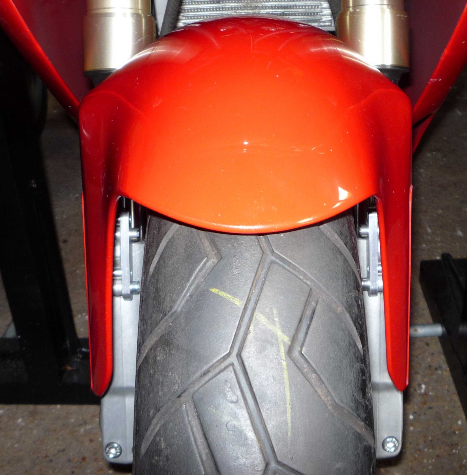

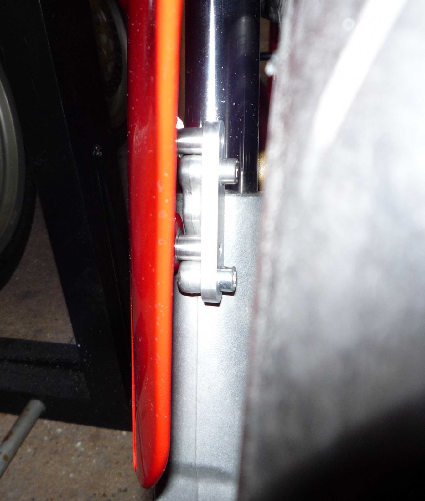

  5. Maybe he could do summat like this Chris............ a variation I did to mine, because I fitted a 70 profile front tyre and there wasn't enough clearance IMO between tyre crown and mudguard........
    The risers bolt to the fork lugs and the mudguard bolts to the higher holes in the risers.
    The OP could possibly have something similar only with the spacing modified.
  6. one aligned hole worked fine on mine with 120/70/17 tyre.. Is that a 748 guard? - looks like it could be an ST or SSie one?
  7. I don't think so Chris.......all the mounting holes are in the right place for the fork lugs on both sets of forks.......but as the SS mudguard can sag over time, it also needed a tweak (the rear of it drops so the tyre can catch it).....there's a way to deal with it with a hot air gun / blowlamp.
    The risers I made, simply lift the whole mudguard by 20mm.
