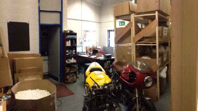

And after much deliberation decided to take the hack saw to the carby and develop the IE with a degree of purity in mind
While I agree the SS ie full faired bike is a Marmite look, the half faired is the best looking SS there is, better than the early and later full faired bikes both Not my bike BTW.
Until your engine paint starts flaking off......and they all do. And your mild steel manifold starts rusting. Then you need a full fairing.
