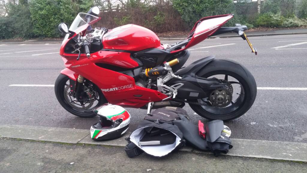

  1. Riding to work. Dry roads. 14 degrees. Laughing at how good the 1299 is. Winters over. Life's great.

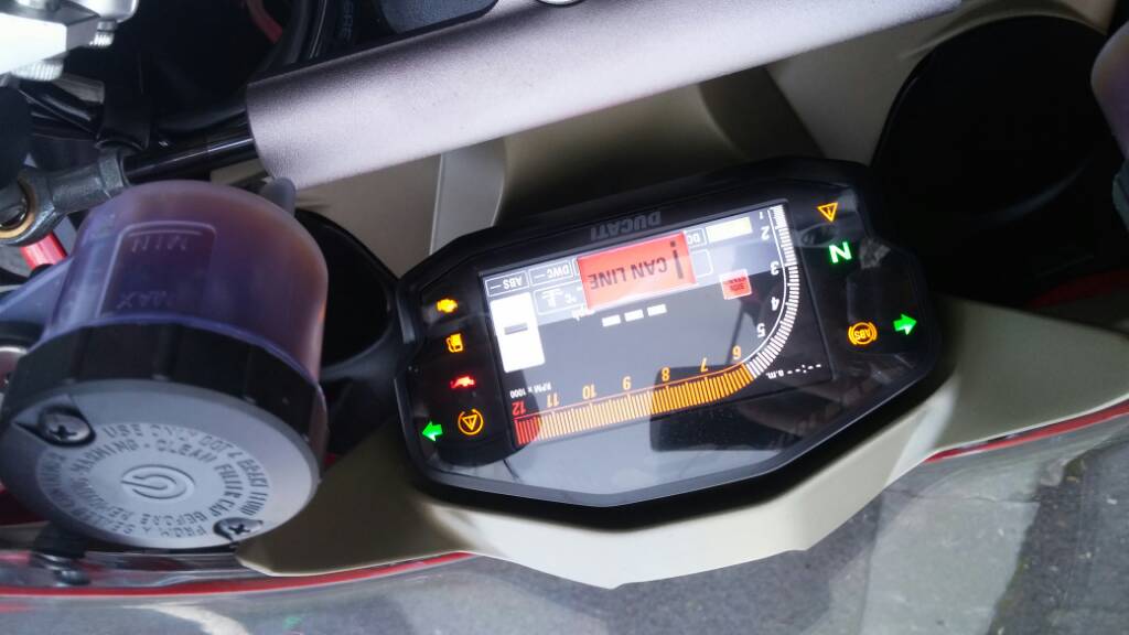

    Then this appears on dash, bike lights up and then dies. Now won't start.
    Now sat like a dick waiting on the AA.

    Can Line Error - Ducati 1299 Forum
    try unplugging/plugging in some connectors under the seat - looking for moisture possibly if you get fed up with waiting.
    EDIT - ok, reading through, it's a seat removal job and access to connectors is difficult even then so probably a 'pass'.

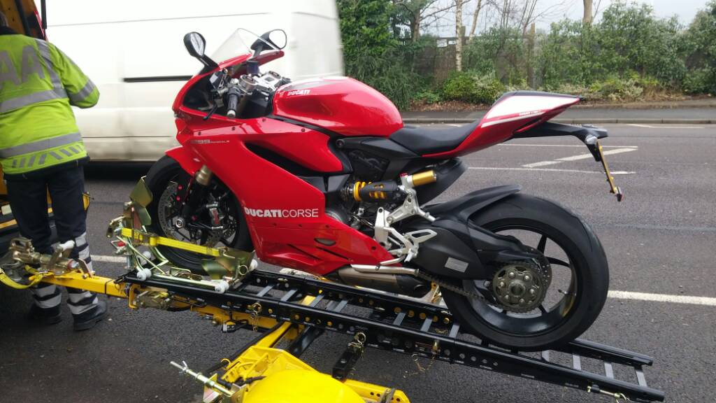

  7. What's the opposite of rapid response?
  8. Hope you didn't have to be anywhere important
  9. My 999 was on one of those a while back took the guy about 20 mins just to assemble the trailer.
  10. Just filming from 930. Little breakdown has cost me a day's pay. Do Ducati assist reimburse loss of earnings?

  14. It's at dealers. Not communicating with the dealer diagnostic tool.

  15. My 1299 did the same much to my displeasure. There is a connector under the seat which is near impossible to get to with just taking the seat off. Vast amounts of fiddling later with pokey tools I got it unplugged, seems there was a microscopic spec of corrosion on the inside. Sprayed and re-plugged back in and got it started so I was able to take it down the dealers for them to investigate further. They said they went through all the connectors and cleaned them all up but that was all that was the problem. Not great having the bike become a paper weight due to a crappy electrical connector that's evidently not protected enough. They did allude to having other bikes with this problem. A google reveals that as well. Good luck with yours.
  16. I let the dealer know and i hope it is something as simple as that. It makes sense to be honest as i've ridden it in torrential rain last week.
