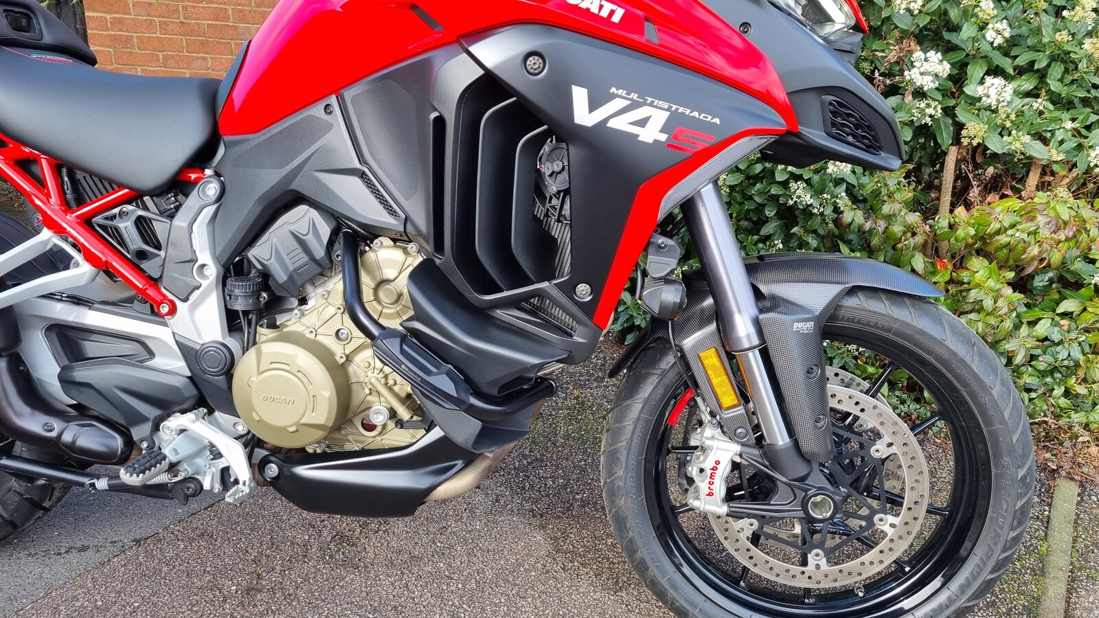

  4. No problem flipping the flaps. just a little bit of a reach.
    Marc

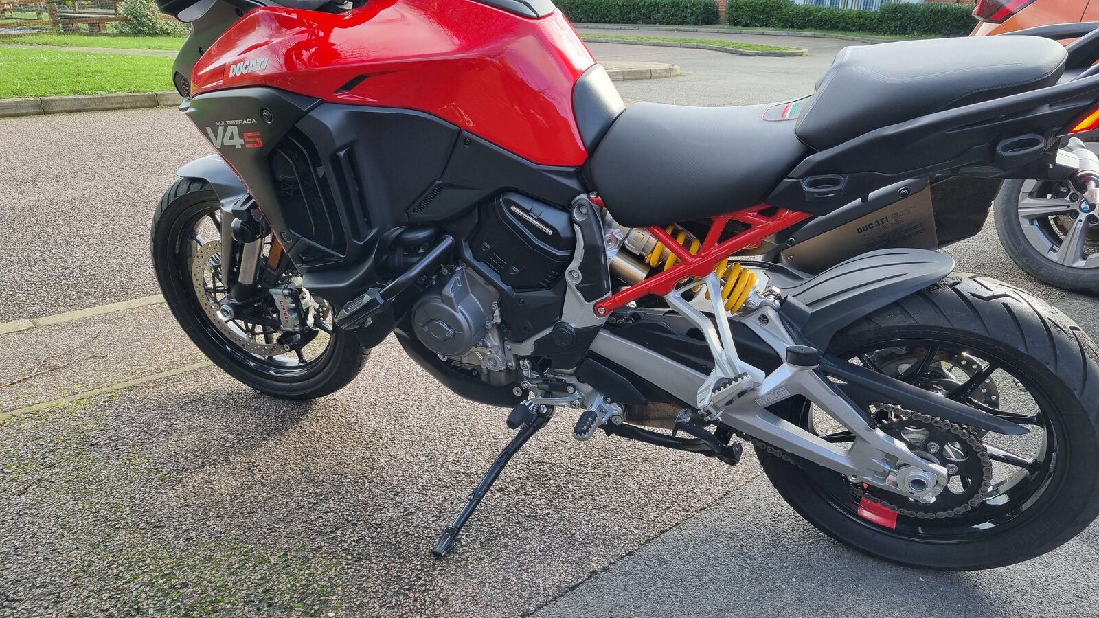

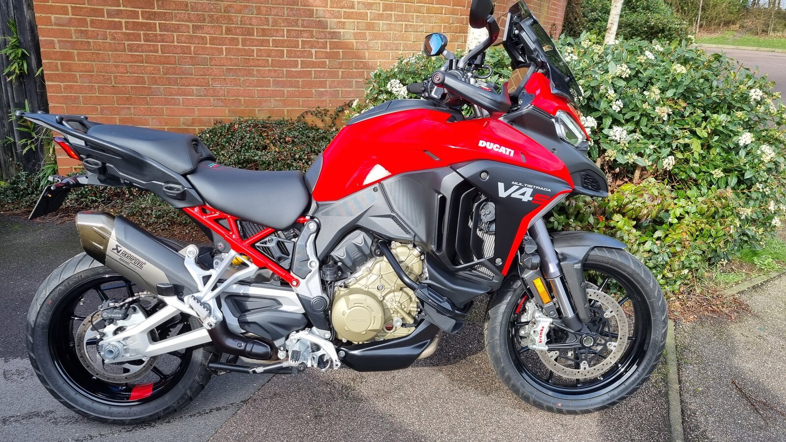

  11. The engine guards arrived from Wunderlich Germany yesterday and got them installed this morning.
    Pretty easy job and they are compatible with Evotech engine guards.
    Pretty pleased with how they look.

  14. Guards are very neat.
    Your bike looks great with the black side panels. Looks better than ‘factory’.
  15. Are they Ducati panels or a wrap? How about the graphics?
  16. Looks really nice. I’m guessing that includes the cost of the panels, or do you have to send them yours?
