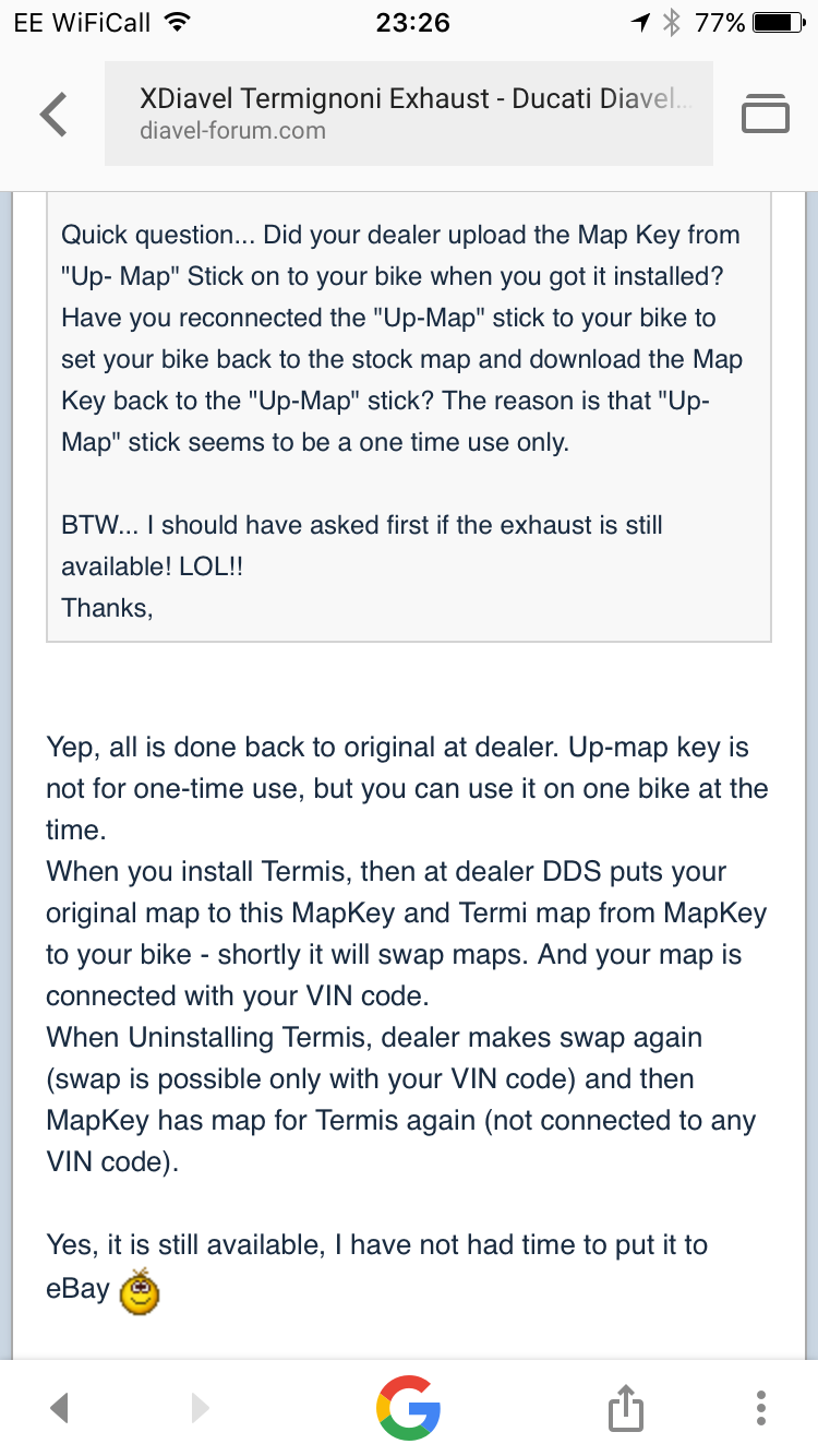

Look at this from an American forum - It would seem that you can fit your Termi to other bikes as long as the Mapkey is maintained. Thanks Wayne
The UPMAP key works as above. When you fit the exhaust, the UPMAP is loaded into the bike with dealer software (only early UPMAPS were plug n play). When you remove the exhaust, the dealer can load stock SW back into the bike and this enables the UPMAP key to work on another bike. You must ensure the UPMAP key is kept safe. Once installed, it is coded to the bike so it can't be used on multiple machines. Once the process is reversed though, it can be installed on your new bike.
Yep thats correct at least thats how my dealer explained it to me ! I fitted the termi myself and took the bike to dealer for upmap to be installed and was told not to lose the usb stick as its got my old map on it should i want to remove the termi at a later date !
Agree with this. I have a Termi on my XDiavel and my Multi Enduro, both fitted by M&S Motorcycles (Ducati) in Newcastle with the relevant USB that came with the Termi's. They explained that when I sell the bikes, the Termi's can be removed and changed to new bikes or sold separately as long as I keep the USB so they can change the bike back to standard. Which supports the couple of comments above.
