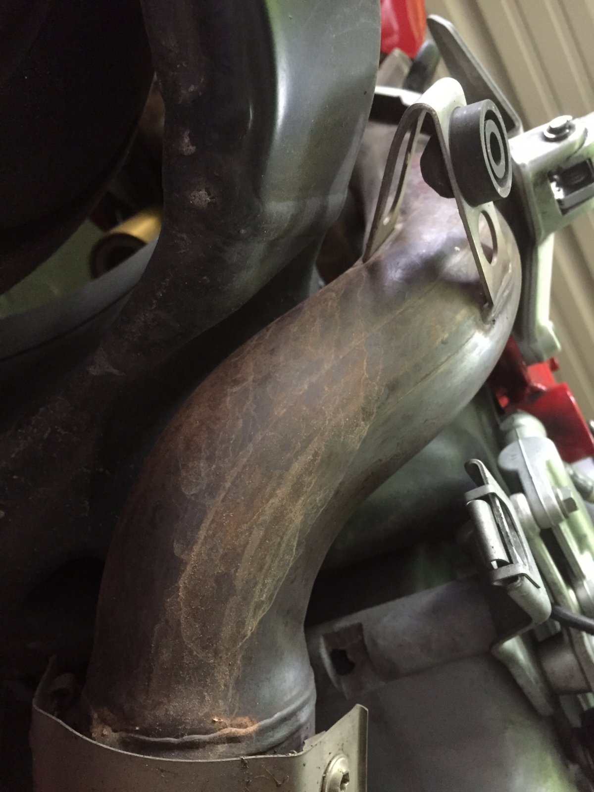

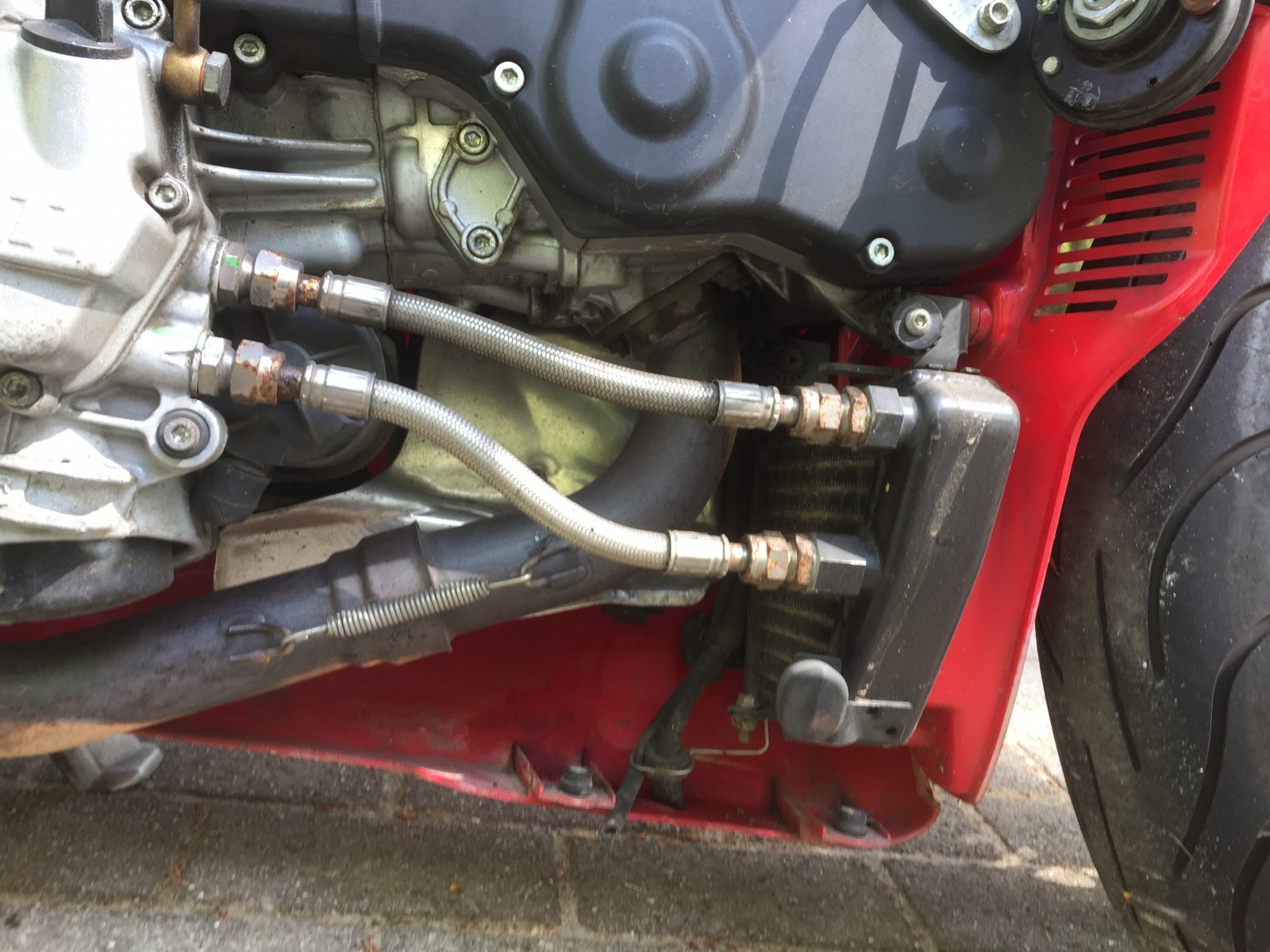

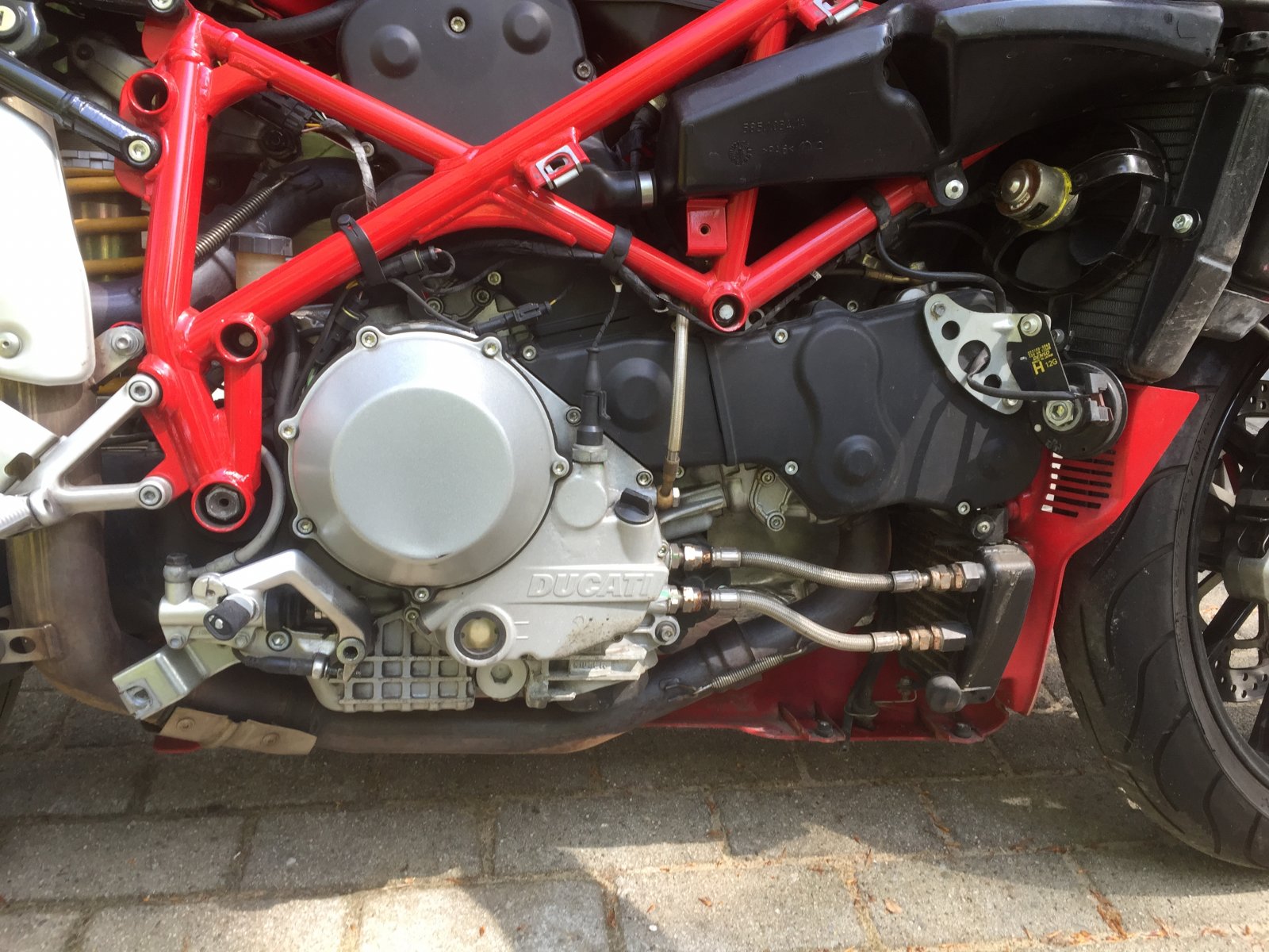

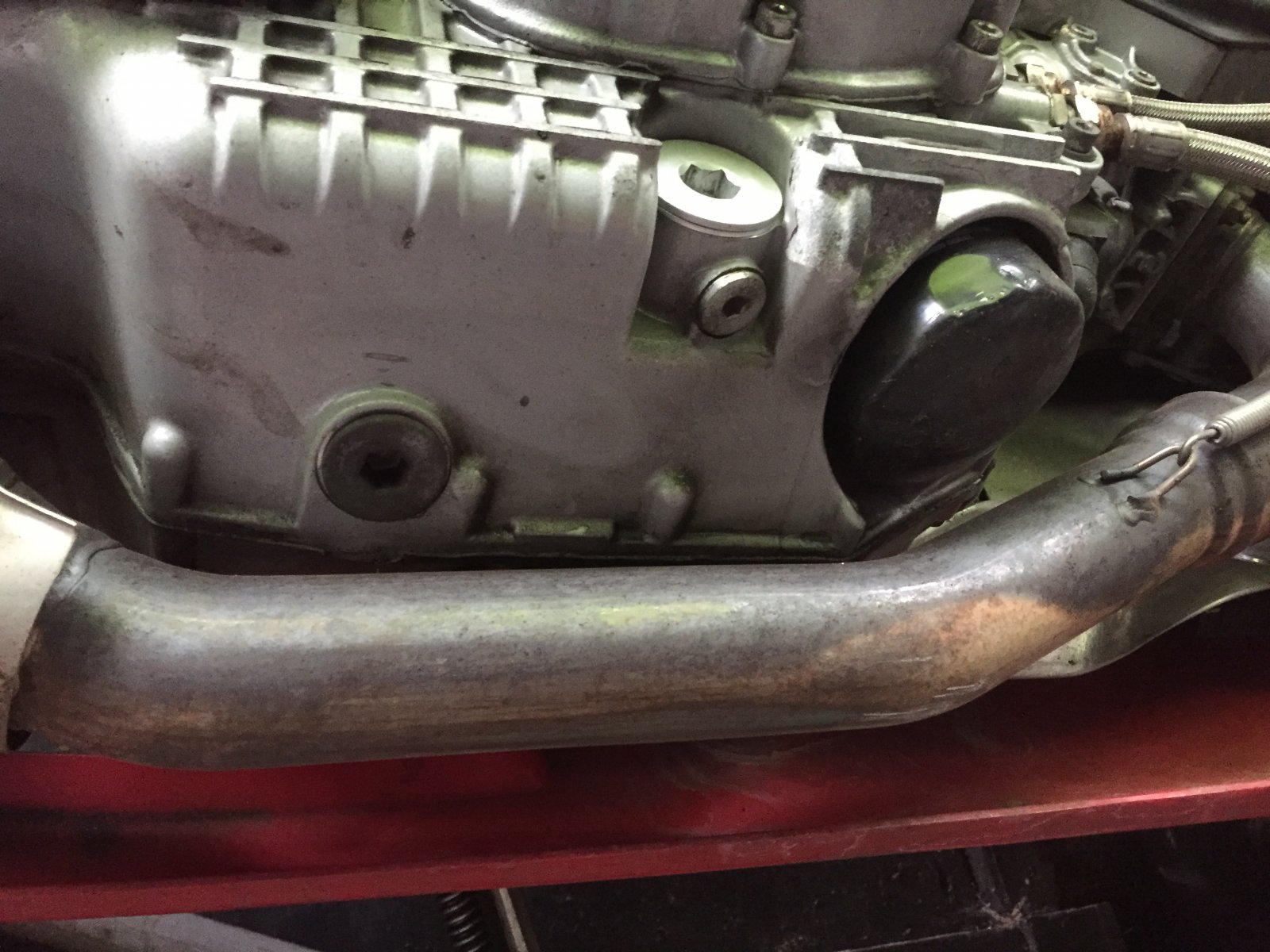

  8. Some pictures would be a great help. Thanks.
  9. Lordy Lordy @Loz . I thought I was the only one but I think you may soon be the the last one ! :eek:
  10. Here ya go
