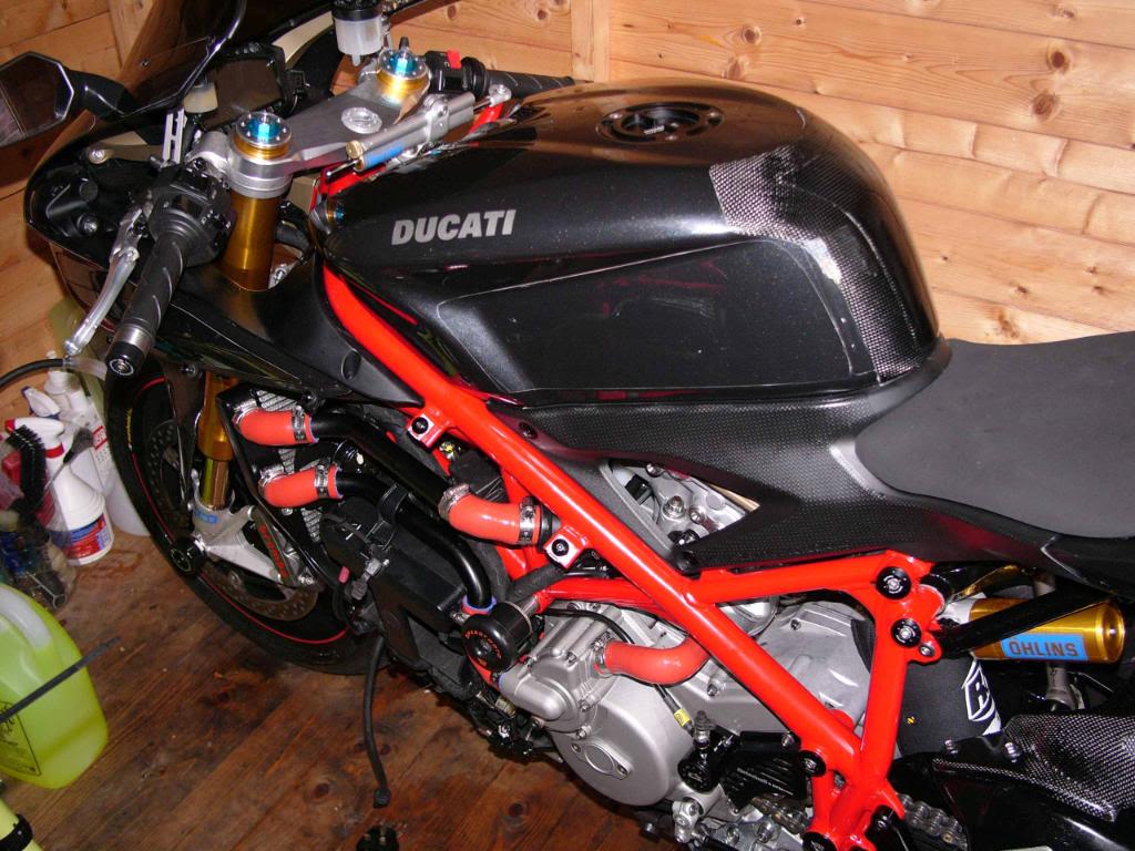

  18. Get a hold of the maintenance manual for the 1098, somebody here will have the link. That shows you how to remove the fairing sides and belly pan. Don't take off just the side its more trouble than its worth
    Yes just remove Negative then Positive with ignition off. Add your connections and have it poking through the gap just to the rear of the battery then put it all back.
    You may need to reset the time on the clock :eek:
    Fairing removed and you can see the open black rubber plug for connection to a trickle charger, in this case an Ctek
    Hope that helps
    John
