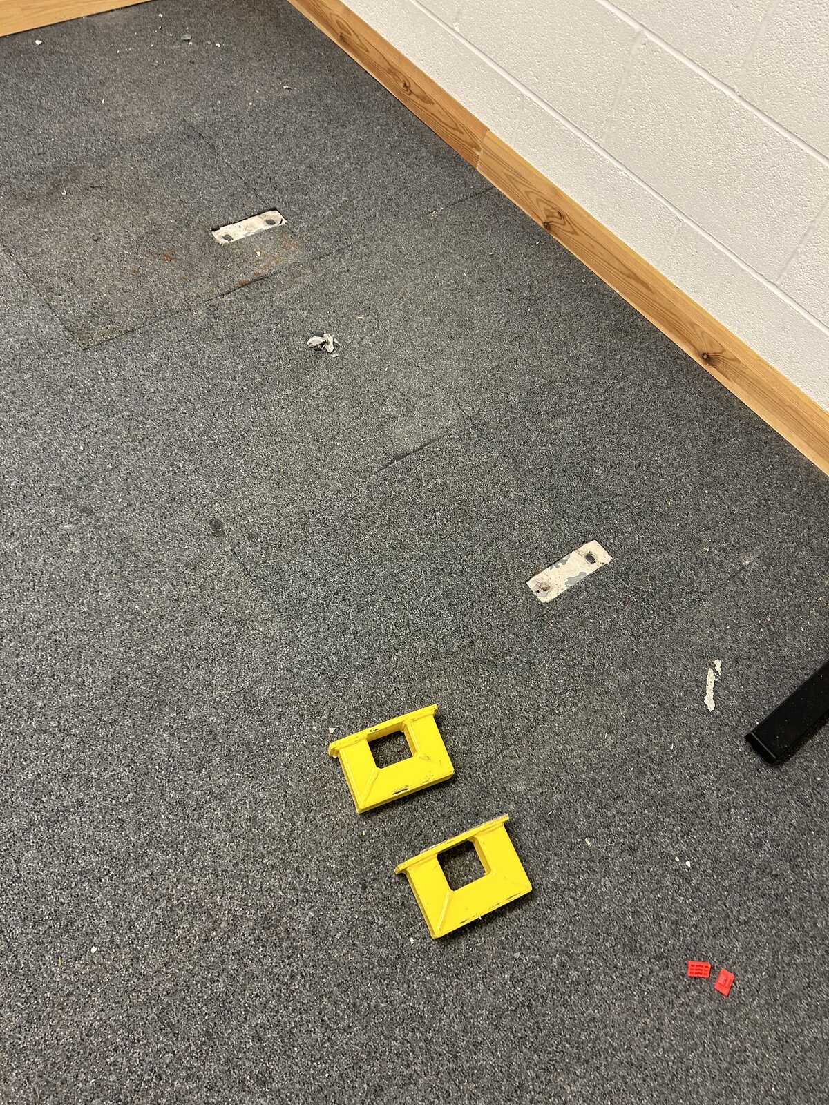

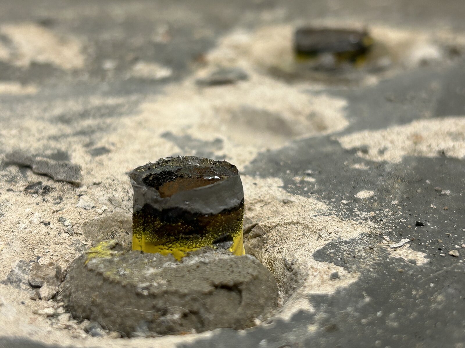

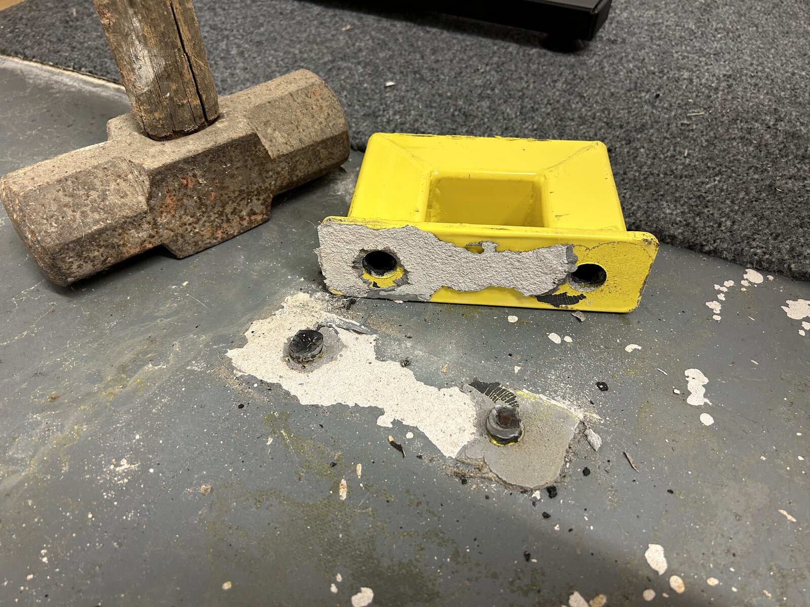

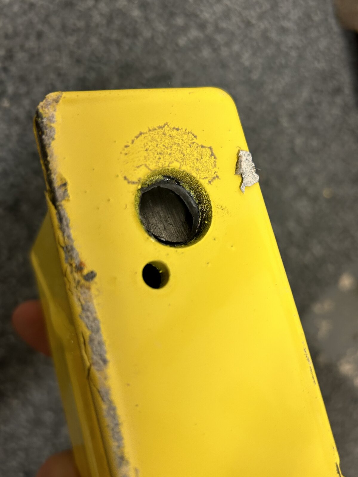

Long time Ducati owner who has just sold his bikes (new baby so having a break) Many years ago I purchased at great expense several sets of Almax chains and Defiant ground anchors. Well since the bikes have now gone I thought I’d attempt to remove the anchors. Spoke to Almax who was helpful but basically said I’d need to take the concrete up or cut around it maybe. Well , here’s the second anchor being removed by a few taps of a sledgehammer. Both removed in the same way with little force. To clarify these were fitted flat to the floor and also used their own adhesive. The issue isn’t the fitting into the floor but the actual anchor itself simply failed. It’s a very poorly made product with little penetration on the weld. It wasn’t even connected all the way through the anchor. Just a few Mm. Anyway here’s a few pics and a video. I just wanted to warn others as like myself you are likely living with a false sense of security but also have spent considerable money in doing so. I’ve emailed almax but no reply. https://youtube.com/shorts/oI7iw3l-r54?feature=share
toughest on market apparently. Took professsionals 1 hour to remove he said. took us 15 seconds to do 2.
I fitted the Pragmasis Torq anchor using their resin bolt fixing kit (Fitted 3) I wanted to remove 1 when I reduced the number of bikes. 1. I tried removing with 2 3 ton tacks and a thick crow bar through the loop to jack it out - NO.. jacks stalled and the crow bar bent in a little U 2. I then spent around 20 minutes a bolt drilling around the hammered in ball to remove the balls. 3. Then tried undoing the bolts with a Wheel Impact gun - no - that was not working 4. Had to drill the head off.. Took me over 3 hours.... So I can definetely recommend the Pragmasis Torq Anchor..
