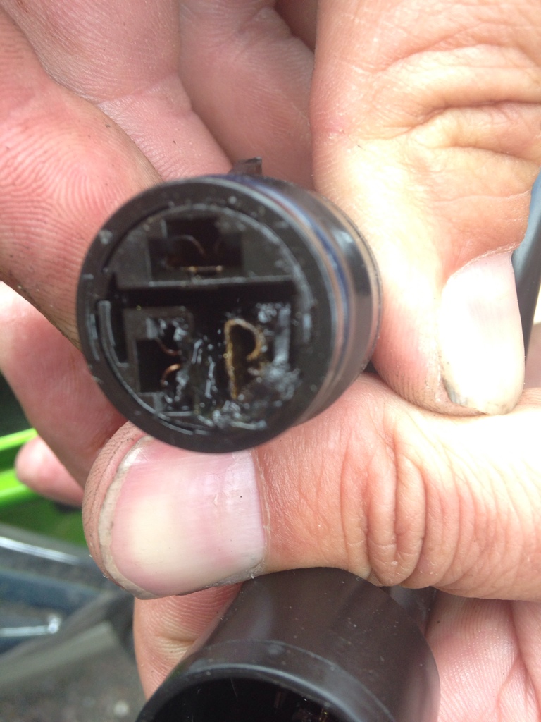

  4. Just spotted this....
    I'm pretty sure that's the regulator/rectifier in the back tail pod. That was the connector, covered in what looks like engine oil and looking very worse for wear...

  7. Had a bit of a look around at this but my knowledge is poor so looks like it's off to the garage to be assessed :( That melted plug is a touch worrying and I'm guessing means an electrical fault somewhere (by the looks of it he's been lucky it didn't catch fire).
