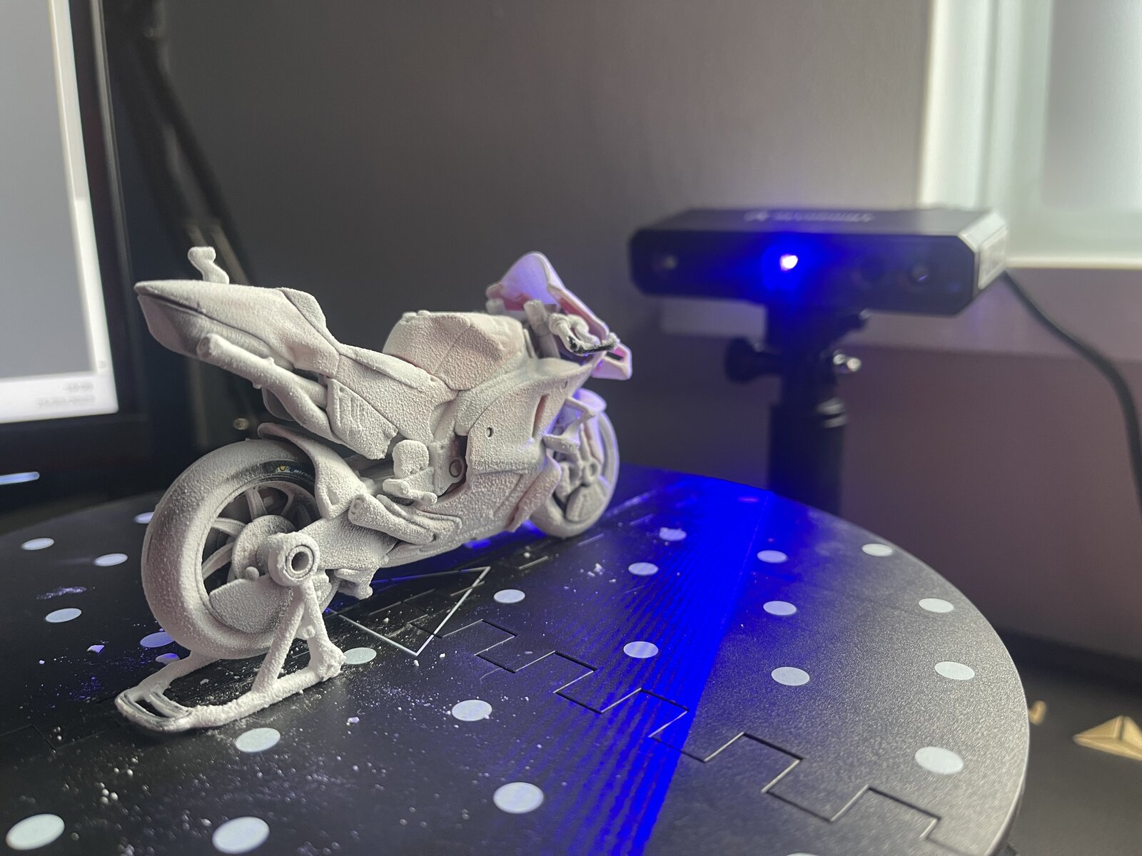

    So I started by buying a 1:18 Jack miller model GP22 factory bike and scanned it with one of my RevoPoint 3D scanners. With the 3D model I’ve started remodelling the panels in CAD and with a scan of my V4 (without fairing) I’ve scaled the GP22 panels and overlayed on the V4 mesh.

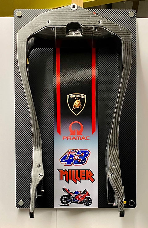

    While I haven’t quite decided whether to try and make a rear subframe used on the GP22 like the one below out of ally or just make some covers for my motoholders subframe to replicate the “look”

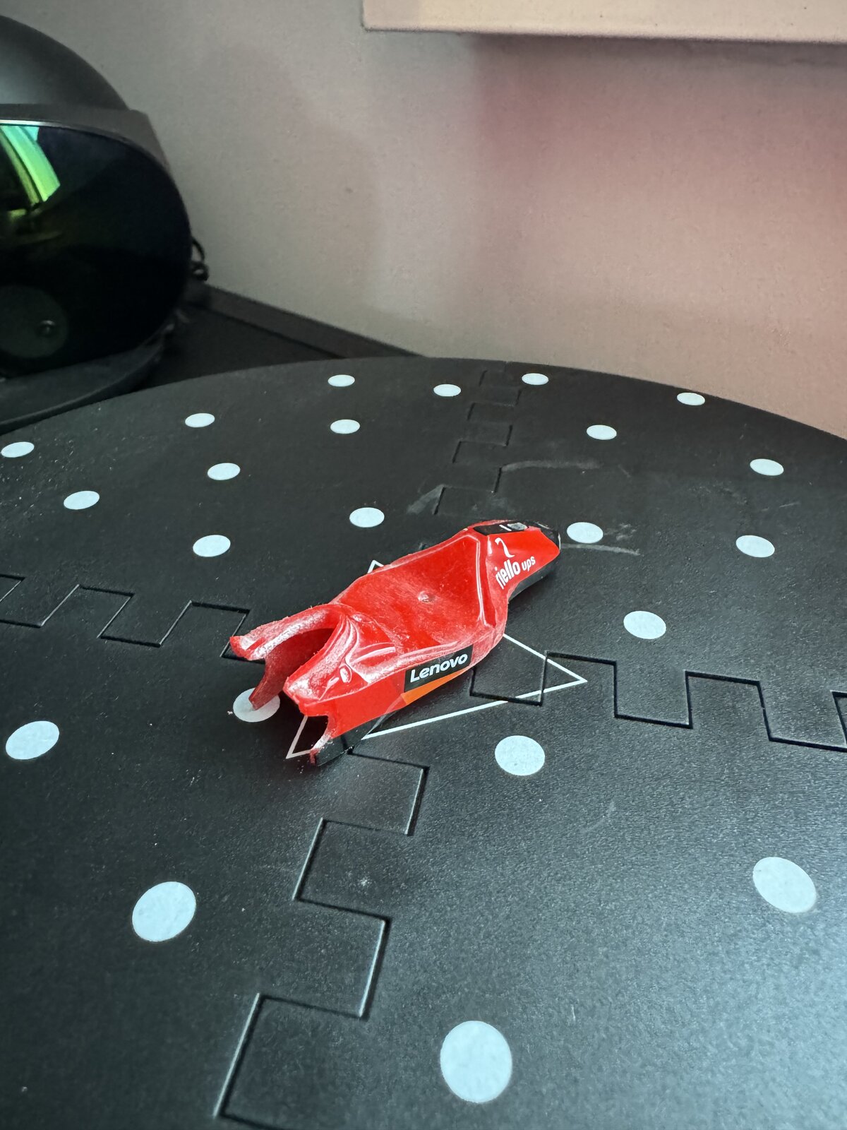

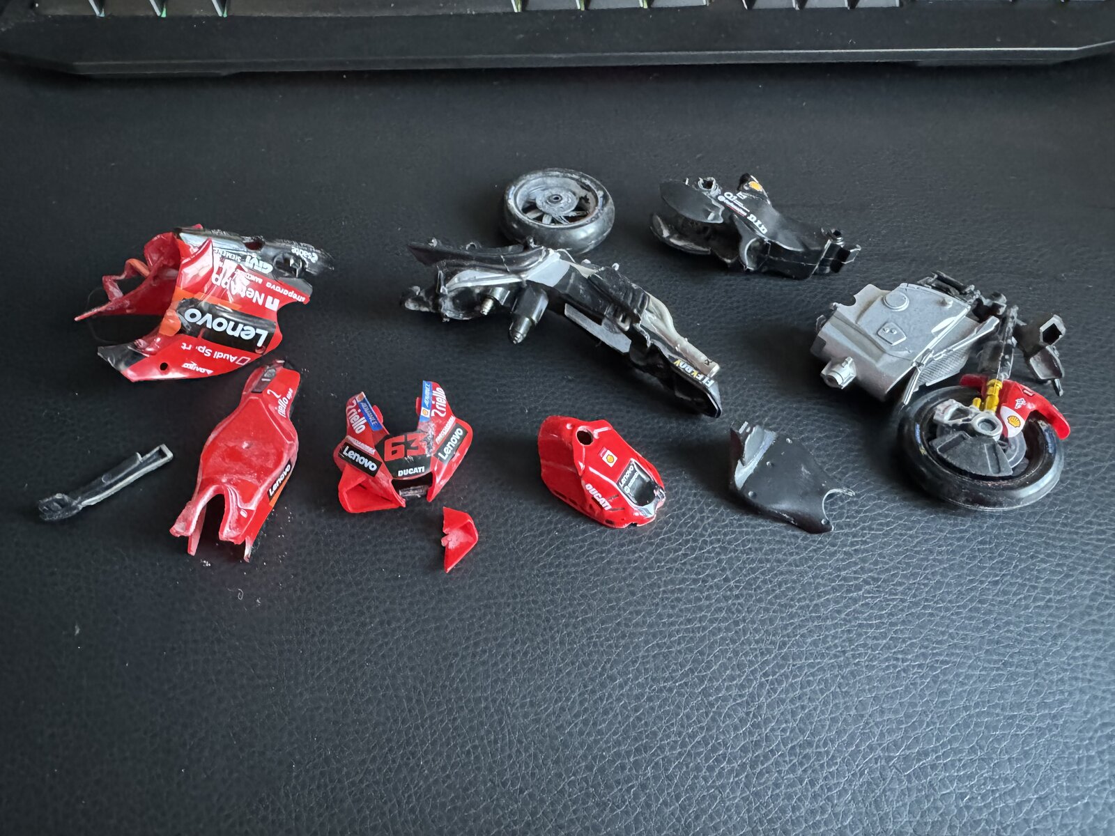

    anyway split the 1:18 model down and scanned the tail pieces separately

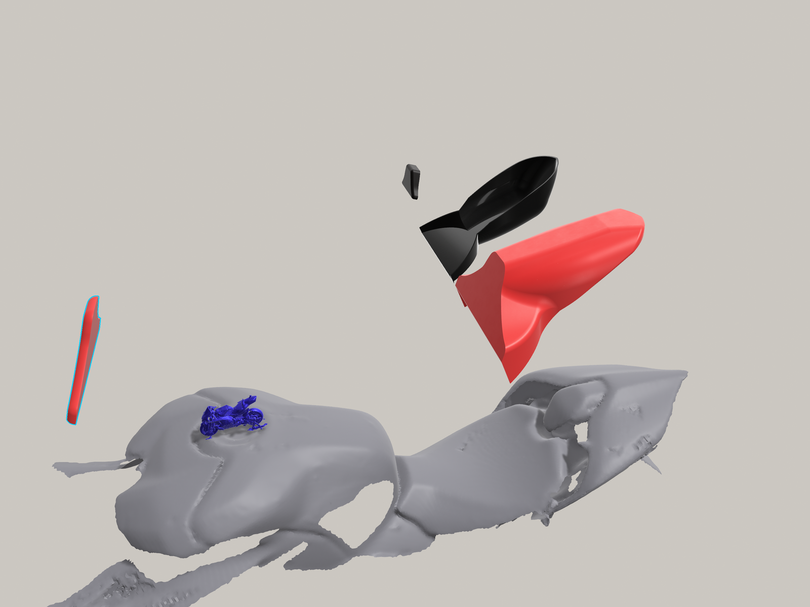

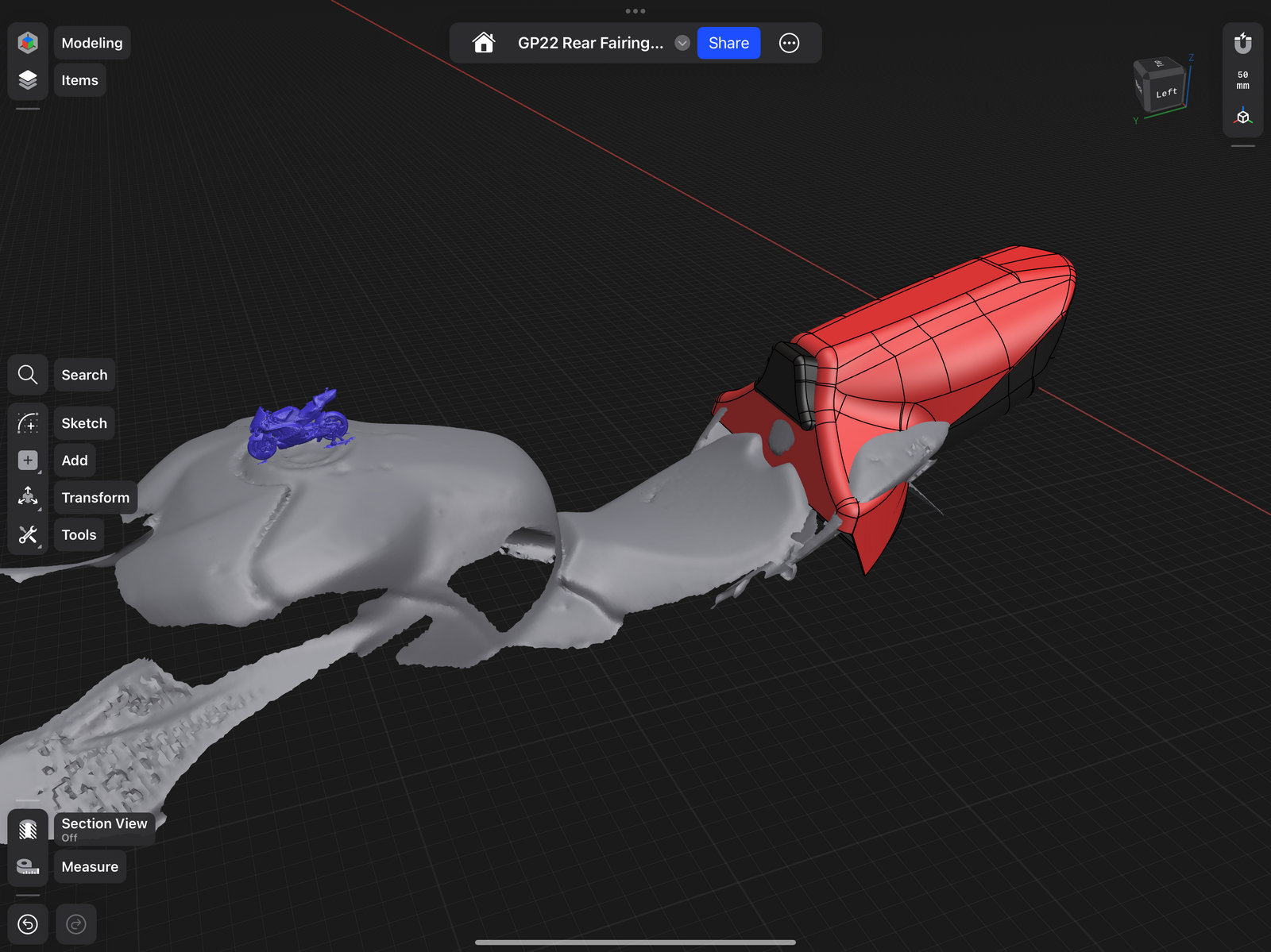

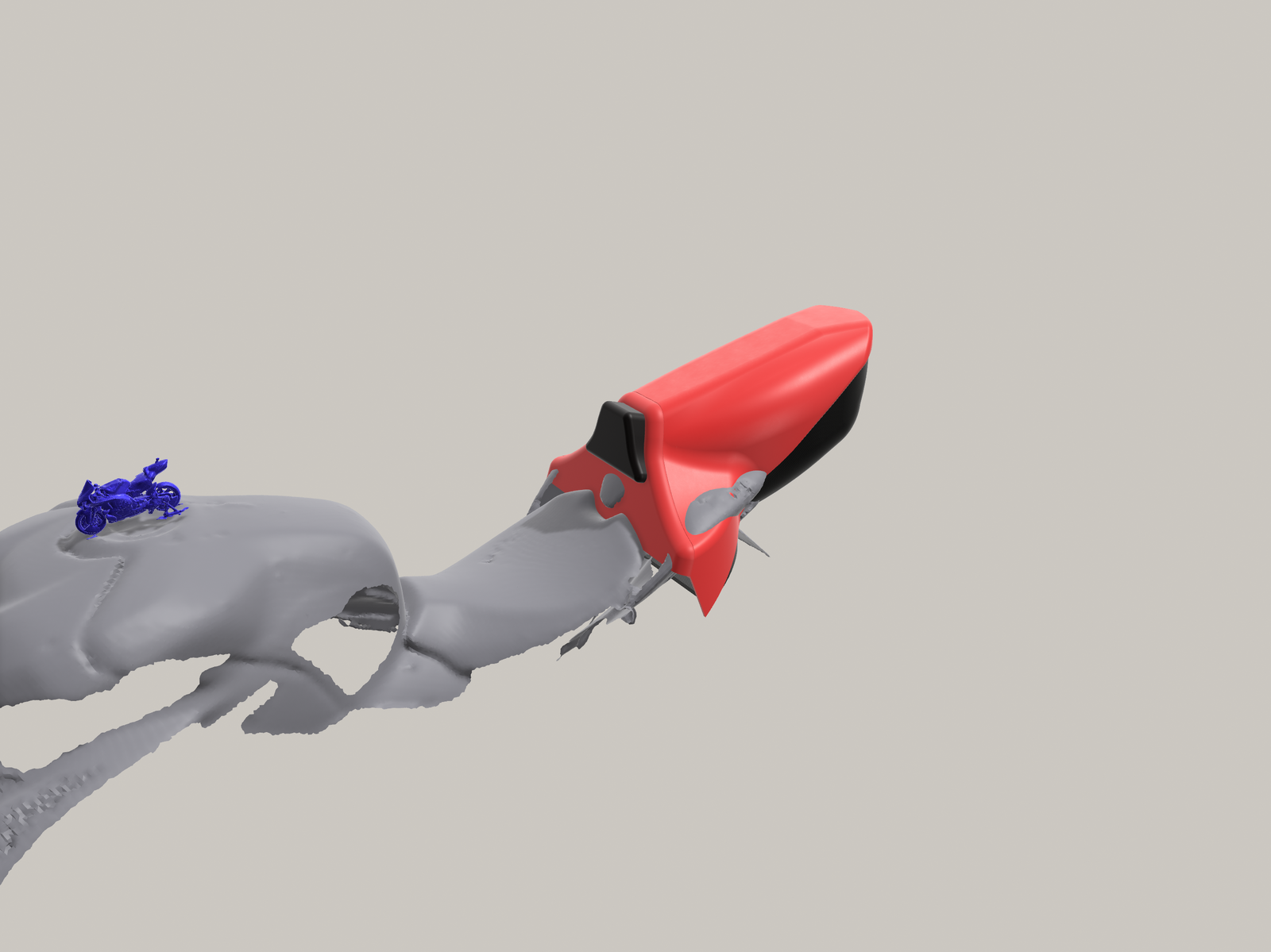

    Popped the scanned mesh into Shapr3D then made a CAD model for the top / bottom and seat panel and then scaled them up to overlay the scan I have of my V4
    just to show the scan of the model size compared to the scan of the V4 I popped the scan model on the V4 tank :joy:

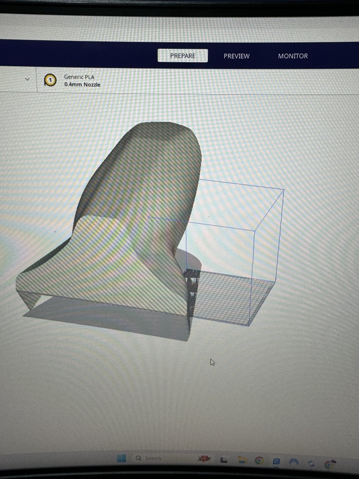

    The rear piece is so big it won’t be able to fit on the printer whole, this shows the print bed and the size of the tail
    Only option is to split the model into smaller pieces. So put it into Meshmixer to split into 4 pieces to print on the creality CR10 max. This is going to be a bit trial and error tweaking the settings for the print as it be quarter of the rear panel is a 20 hour print. So looking at 4 days printing just for the rear top fairing (the bit that usually has the stegasaurus fins on) I will do the stegasaurus fins last.

  12. @DRR117 v.interesting project. what does your 3D capture and modelling pipeline look like? a point cloud from the RevoPoint 3D, which you manually trace in 3D then slice?
  13. Cloud point converted to mesh in the RevoScan software. Then the mesh used as a guide really to model around in Shapr3D.
    I have DesignX / Solidworks to AutoSurface and create a solid, which I could then 3D print a mould.. but at the minute I just find it easier trying to build a 3D CAD model with the Mesh as a template / guide.
    The 1:18 model isn’t 100% accurate so my CAD model allows me a little artistic licence. Plus I’m learning this as I go so no doubt I’ll stumble across easier ways to make the model…. Probably when I print the last piece :joy:

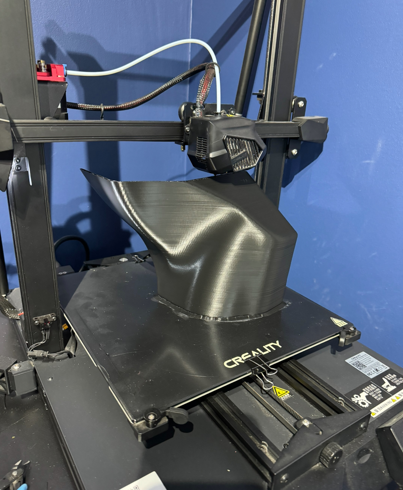

  14. Well 12 hours in and it looks to be printing ok. Printing the front left section of the rear top panel. Hopefully be finished this afternoon and I can start part 2.
    This is the 3rd print attempt, as the first 2 failed so had to adjust the printer settings.
    Creality CR-10 Smart printer with a 300x300x400mm print space.
