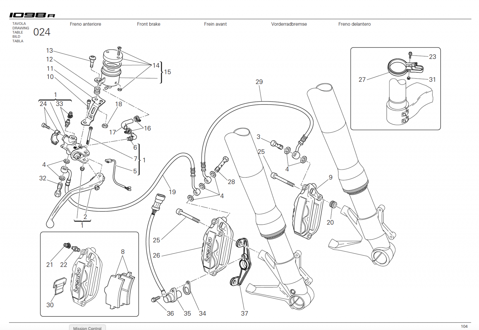

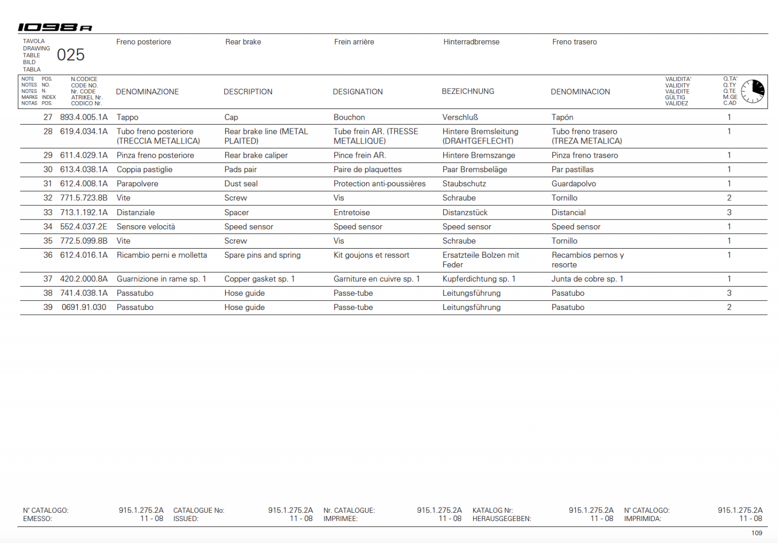

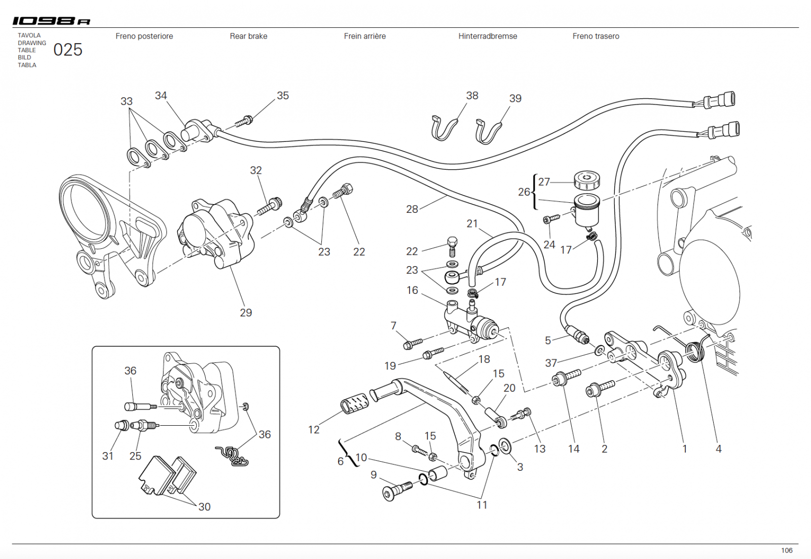

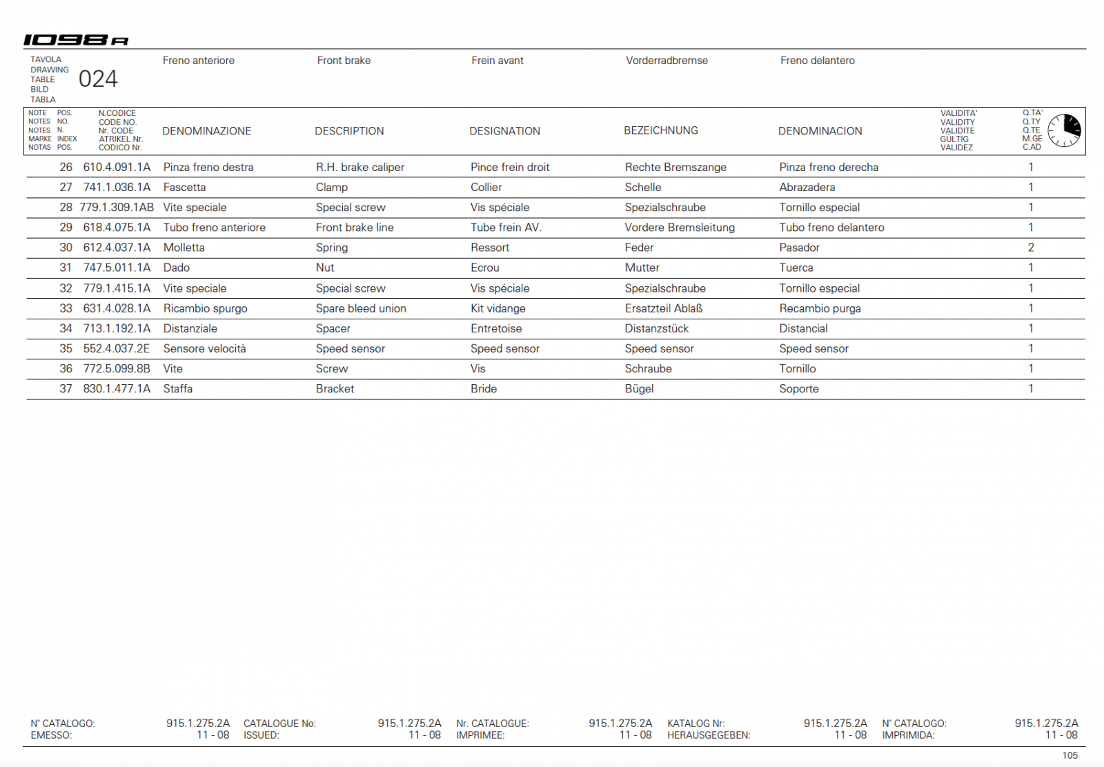

  15. The front sensor is for the Traction Control. The speed displayed on the dash comes from the rear wheel.
    I seem to remember that they are one and the same, so you could try switching them to see if you get the same result.
  16. Yep, I've just checked and they are the same part number. Item 35 on the front wheel and item 34 on the rear wheel.
    Part 552.4.037.2E
