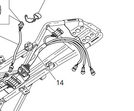

  4. You'll have 3 connectors like in the picture below. The indicators are marked 'DX' and 'SX' iirc. The the 3rd one will be your brake / tail light connector.
  5. The indicators are the singles hanging down in the above picture. The rear and brake and earth are all in the 3 pin connector facing rearward. I am sure that secondhand lights are easy to get, I have a spare here and so does everyone who has fitted a TST tail light. There are also many cheap copies on ebay from China.
