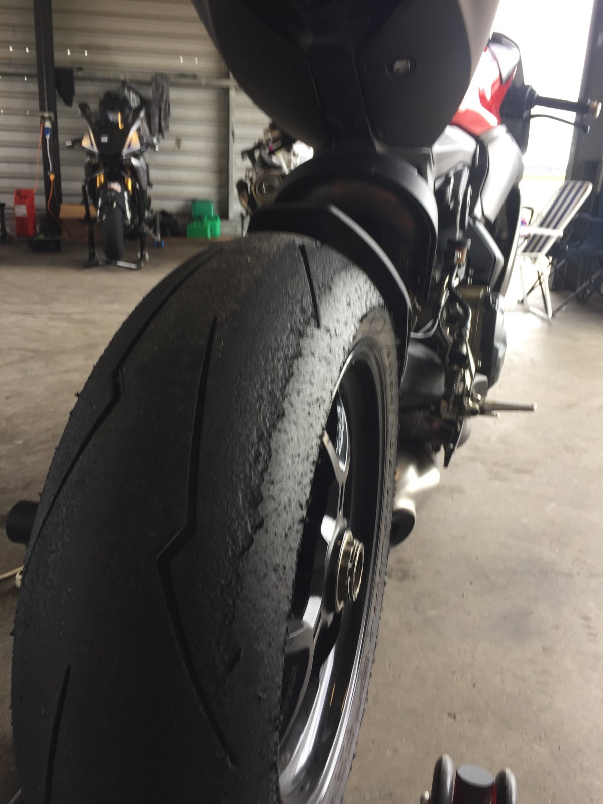

    I've been running the SP and got on great in Spain and a few days back over here but starting to feel them going a little bit especially after a bit of wear so may move to the SC compound next, just running at inters pace but in top quarter i guess.
    Getting some cold/hot tear but think the track temp was so cold it didn't help after being in warmers
  11. Could be suspension related that, if its your tyre, the tearing is in waves. Check out Dave Moss (if you haven't) :)

  13. Ok thanks, has been fine up until that last day at Snetterton tho

  16. Yeah I think you're right - that looks like a zig-zag shaped tear pattern.
  17. New tyres always feel better though!
  18. Hmmm I think it was more than that but happy to be proved wrong
  19. I would say the wear is not because you had SP tyre.
    Why not going straight to slicks? even better feel as you do not have the grooves therefore will be less vibration and if I am not wrong the tyre carcass is slightly different.
