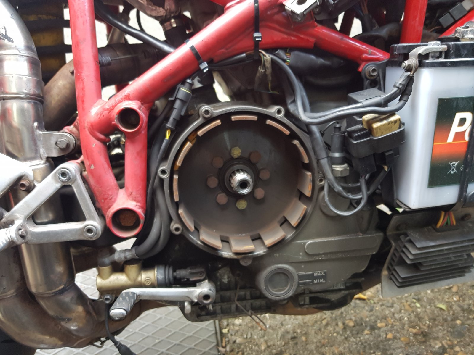

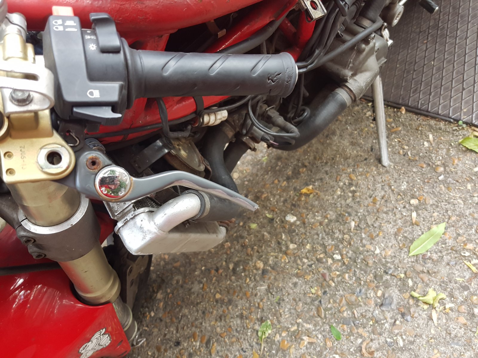

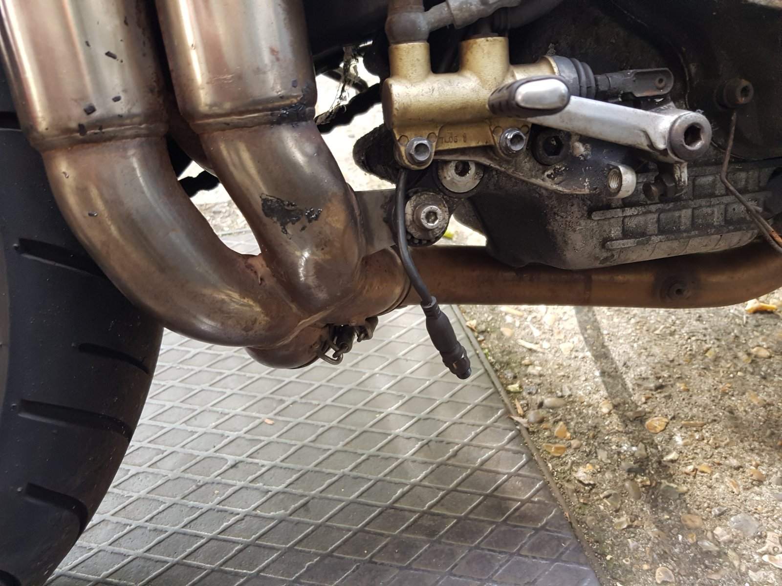

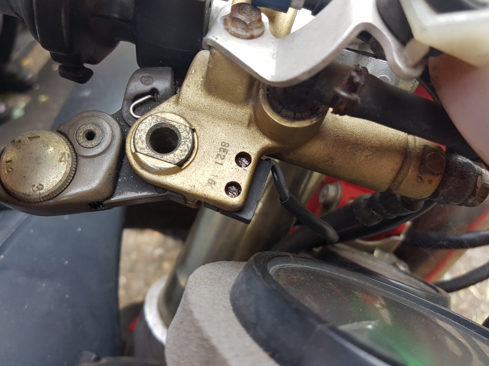

  7. I took some pictures maybe not clear too much but ill try to explain.
    The first picture is that switch isn't working.
    Secondary I had some advice that I need to change everything including the part in the picture. With the clutch.
    3rd is a basic lever.
    4th is some switch in the lever {[^-^]}
    #8 iSaruns, Oct 7, 2016
  8. 1st Rear brake light switch, 2nd full clutch assembly, 3rd clutch lever and 4th front brake micro switch to operate the rear brake light.
    The threads on the clutch shaft look damaged in your picture, hope not!!
    You will need a clutch hub with nut and washer to fix it on, full set of clutch plates, pressure plate with springs, spring caps and bolts, the clutch rod is also missing which runs through the center of that shaft to the slave cylinder at the other side of the engine.

    As Birdie says, 1st, 2nd and 3rd, but the 4th picture looks like it's the front brake master cylinder. It's missing a lot
