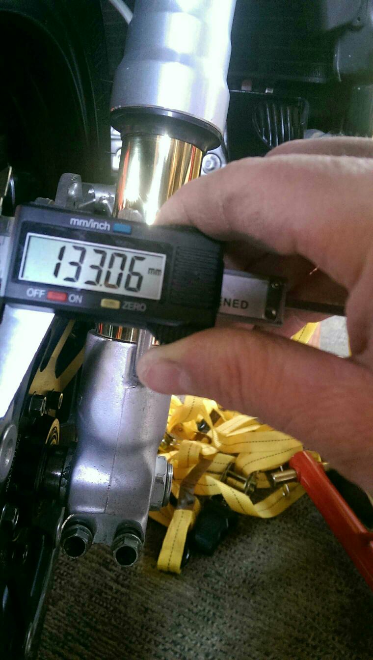

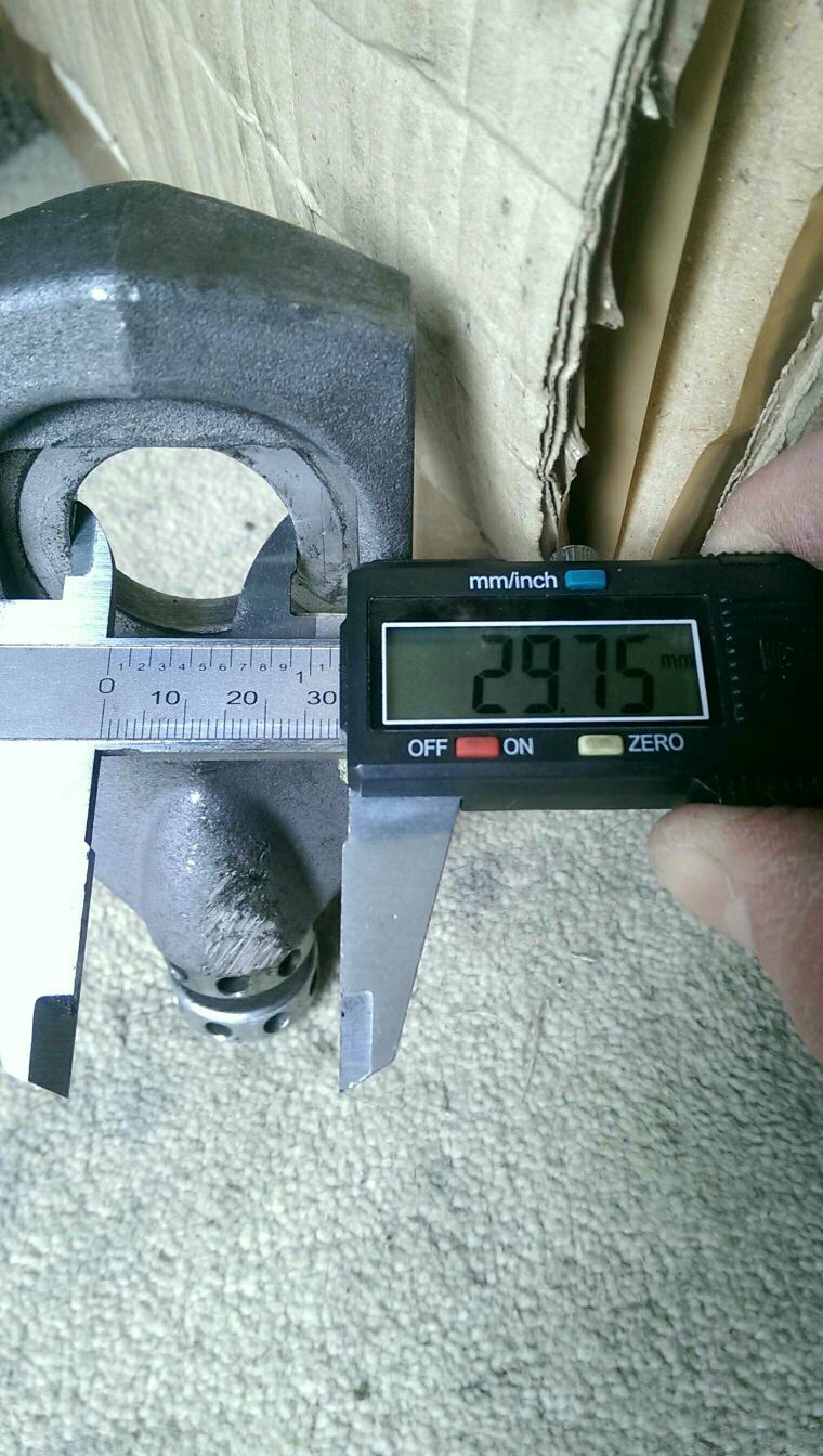

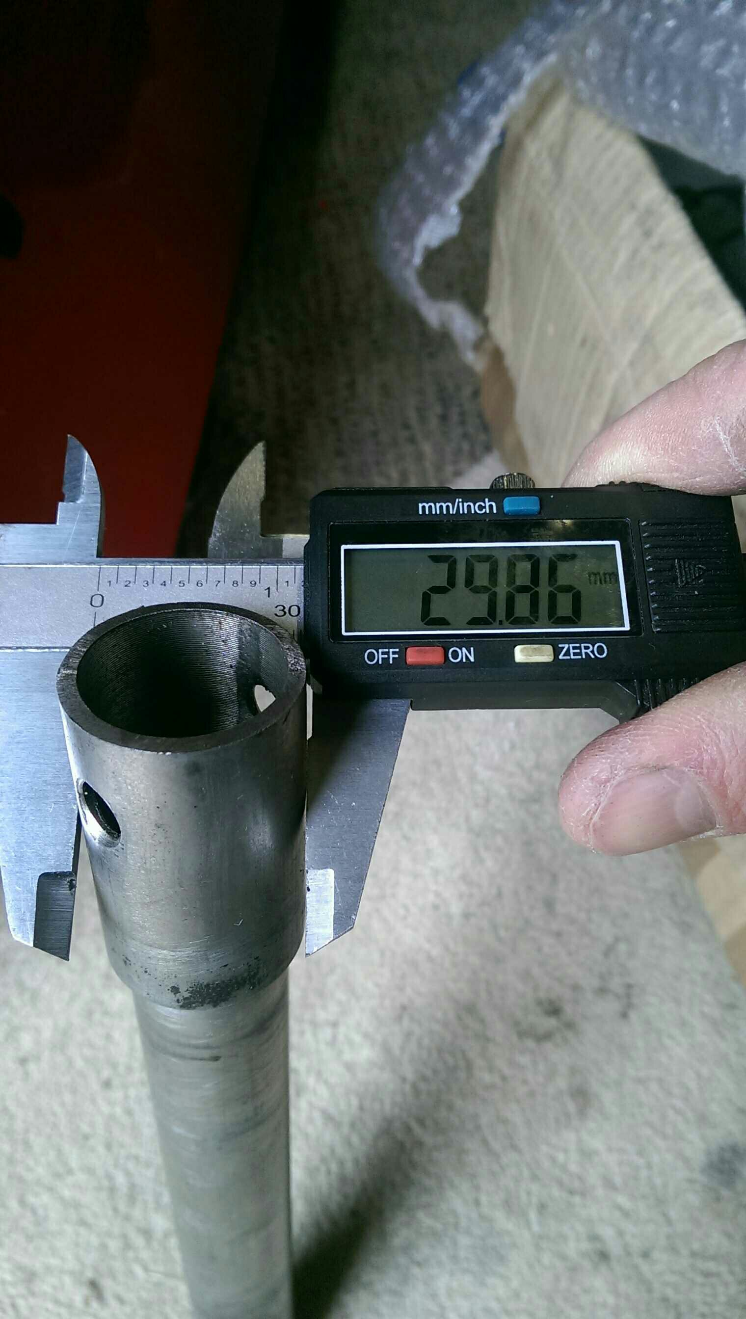

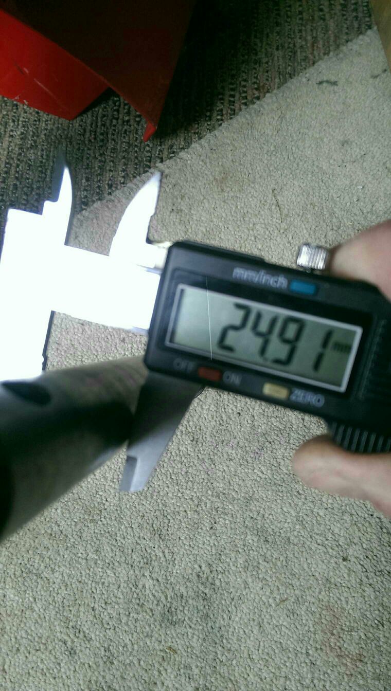

  8. Front spindle
    [​IMG][​IMG]

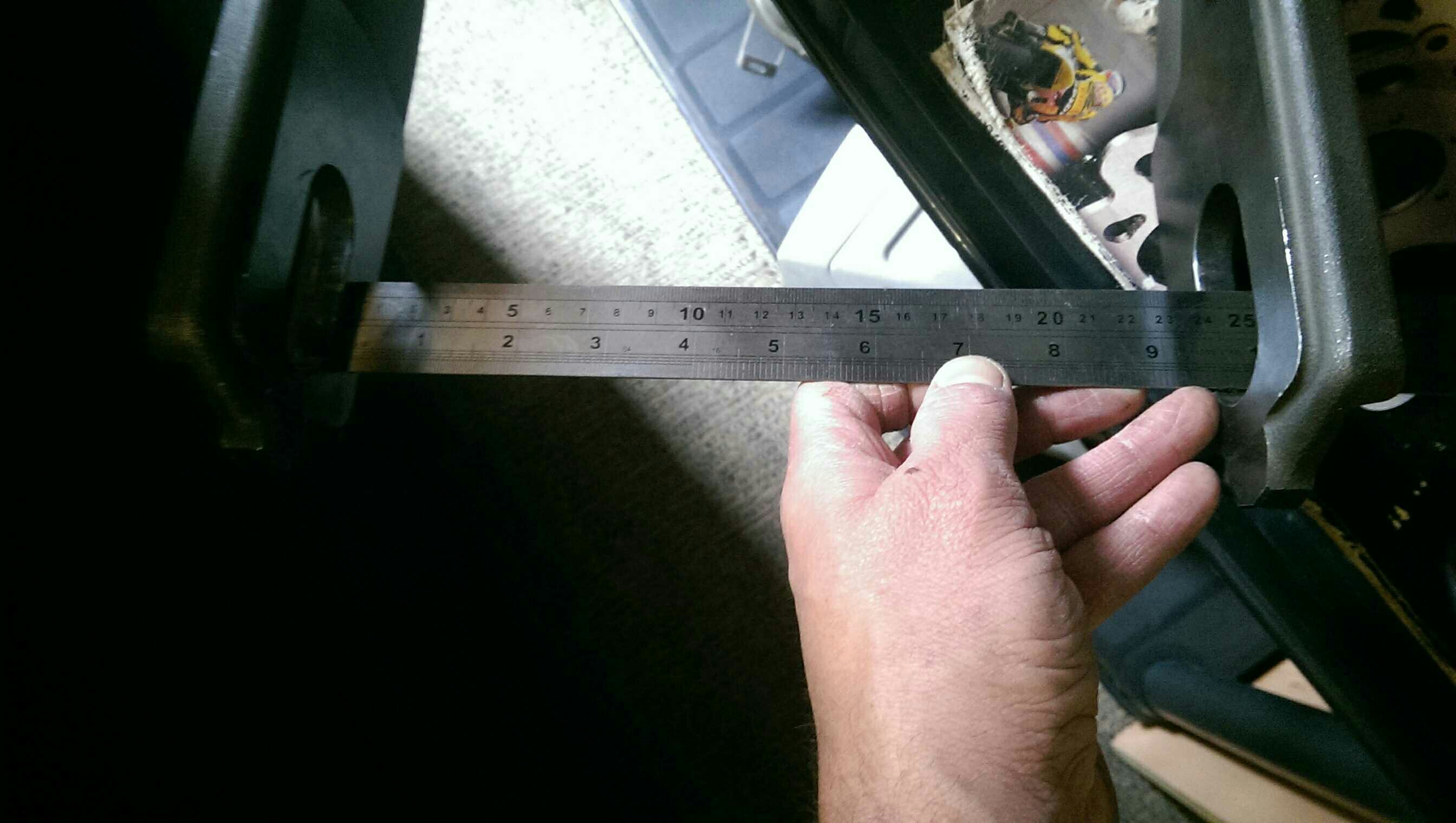

    Rear goes through these adjusters so:[​IMG]
    I can give you the bearing part number for the rear wheel of you need it for more accuracy.

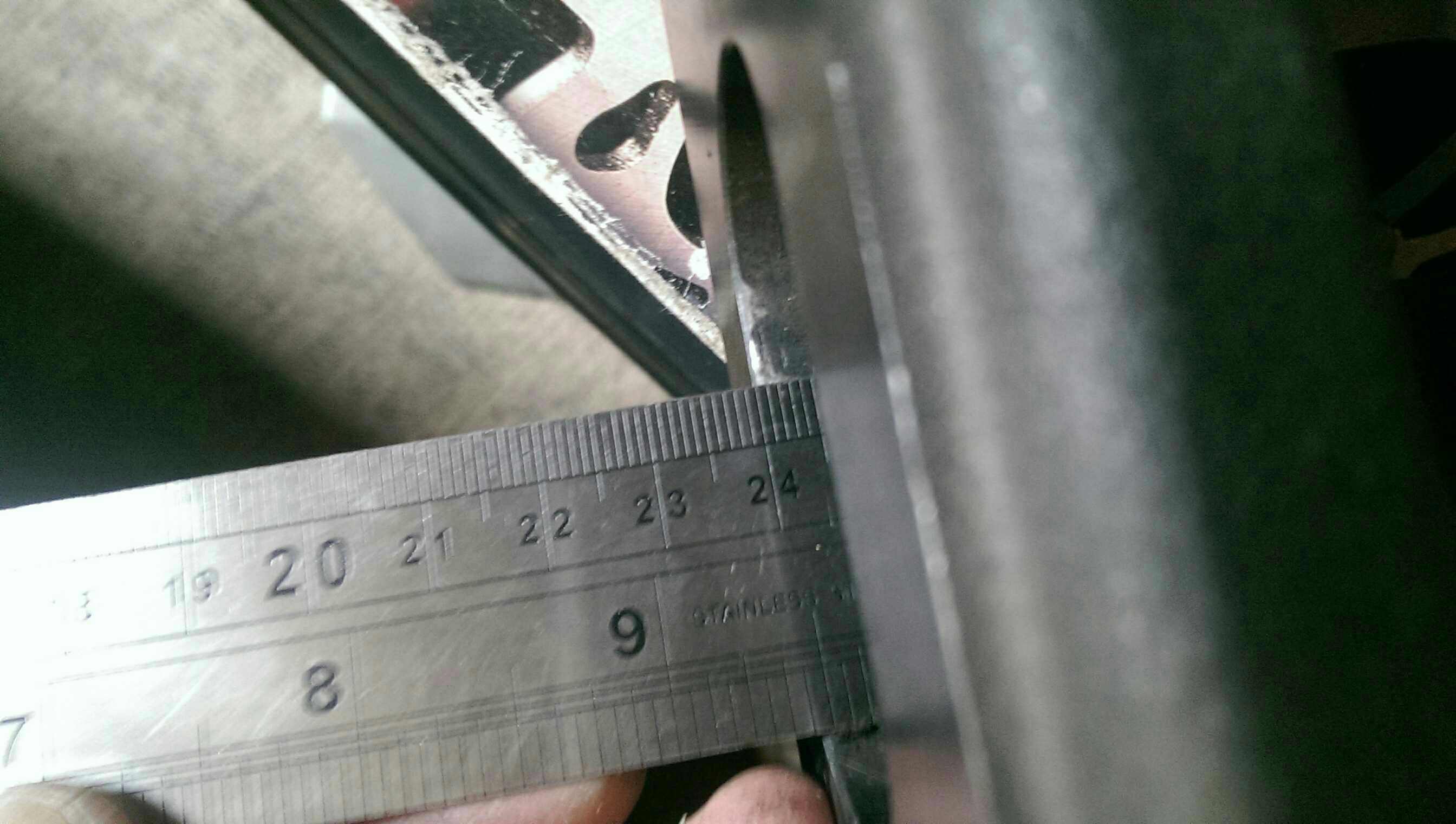

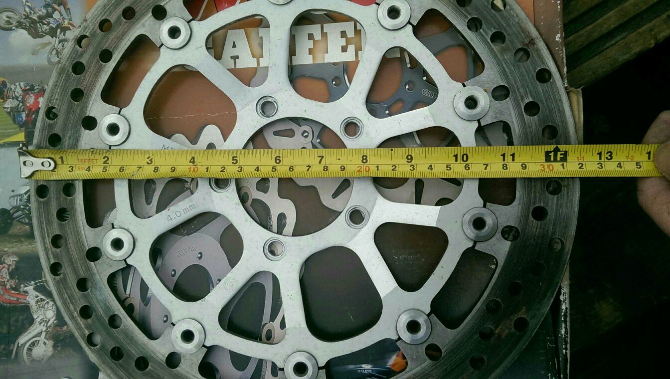

  10. Front disc outside[​IMG]

    Front disc
    I'll have to start taking stuff apart to get more. If you decide it's a goer I can get more measurements.
  12. Cr, hi.
    That's fantastic, many thanks, I can probably manage with that, I'm really grateful.

    Nasher
  13. Look at a speedo drive from an ST2/3/4 as they have the same spindle dia as the 749/999.
  14. 749 front wheel doesn't have the fitting for a speedo drive and I doubt it would be possible to machine it as you'd lose all the bearing housing?
    Also the disc offset is 5mm more than the SS so you would need to find some 10mm offset discs which, AFAIK are not available in the 5 hole pattern, or move your calipers out. A 916 series front wheel would fit and has a 25mm spindle with speedo drives available so would be much easier to adapt.
