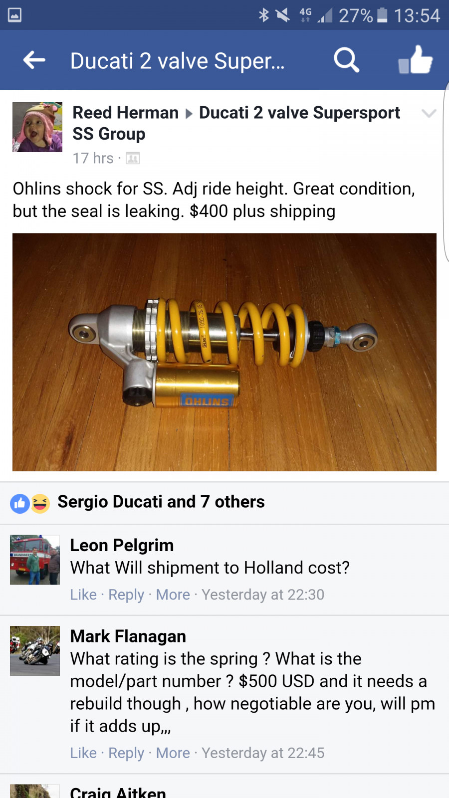

  1. Thanks Desmoquattro - that shock may well be needed, though I'm going to have to have a good, long look at the existing shock before I'll know whether or not it is needed. Is the Showa standard on certain years or an upgraded spec? I think the existing shock is a Sachs.
  2. Yikes - proper upgrade, though not perhaps if it has a leak and would need to be rebuilt anyway. Hmm...
  3. The Ohlins is a good buy even with a rebuild, however still expensive. The more common shock is the Showa, cant remeber when the Sachs was fitted

  6. Maybe, depends why it's leaking.
    I bought an Ohlins for my 916 that had been on a low mileage 998, it appeared to be in excellent condition but was leaking a bit of oil so I had it serviced by Ktech.
    It was leaking because the pushrod had a chip in the chrome, (more than likely caused because the donor bike had been run without a hugger), IIRC a new pushrod was over £100...
