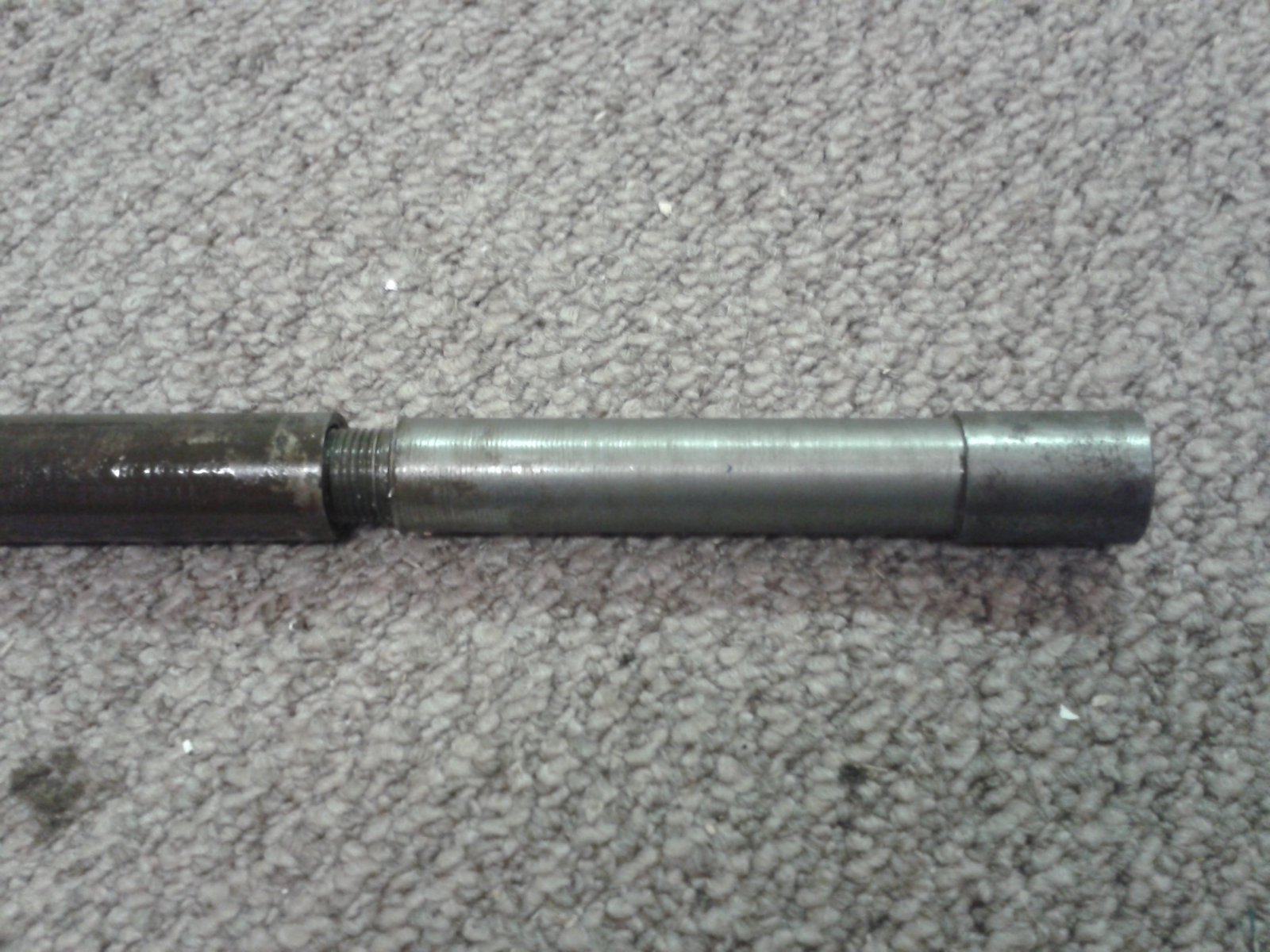

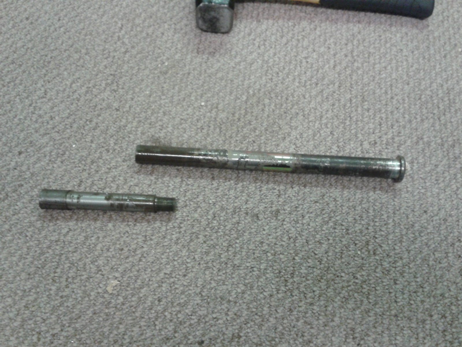

    I have a very good swing arm pivot bolt removal tool. Hopefully I'll never need to use it again. But wondered if anyone wanted to borrow it if they are currently struggling to remove the bolt from their bike?
    I decided at the start of the year to drop the engine out of my 748 to give it some much needed TLC and treat it to a new lick of paint. This great idea was hampered by the dreaded swing arm pivot bolt being seized in place.
    Looking over many forums for helpful solutions it became apparent that this is quite a common issue with the model and loads of people have struggled in the past removing this stubborn bolt from their bikes.
    My brother is an engineer and was nice enough to turn a piece of steel with a tread on the end, which was used to screw onto the internal thread of the swing arm bolt; with a few thwacks with Thor's hammer I was quite easily able to push the bolt out of the bike...RESULT! I had been struggling for a good few weeks to do this and this tool enabled me to do it within a few minutes!
    As I said at the top, I'm hoping to never need this tool again, but it works too well to give away or leave collect dust. However if you are currently struggling with the same issue, I'd be very happy to let you borrow it. I'm not looking for any money, just hope it can go towards helping someone out in their projects.

  4. The thing with these type of drifts, is that they can damaged the thread, if not wound fully in. Or mushroom the outside of the pivot making the thing impossible to get pats the bearings and making it jam even more.
  5. Yes you're right. I found that I needed to re-tighten the drift every three strikes with the lump hammer to make sure it wasn't loading up on threads too much.
    As far as I'm aware, my pivot bolt survived any mushrooming or distorting; although that was a concern I had when my brother made to tool for me.
    However, after so many failed attempts of getting the thing out I was happy to take the risk.
