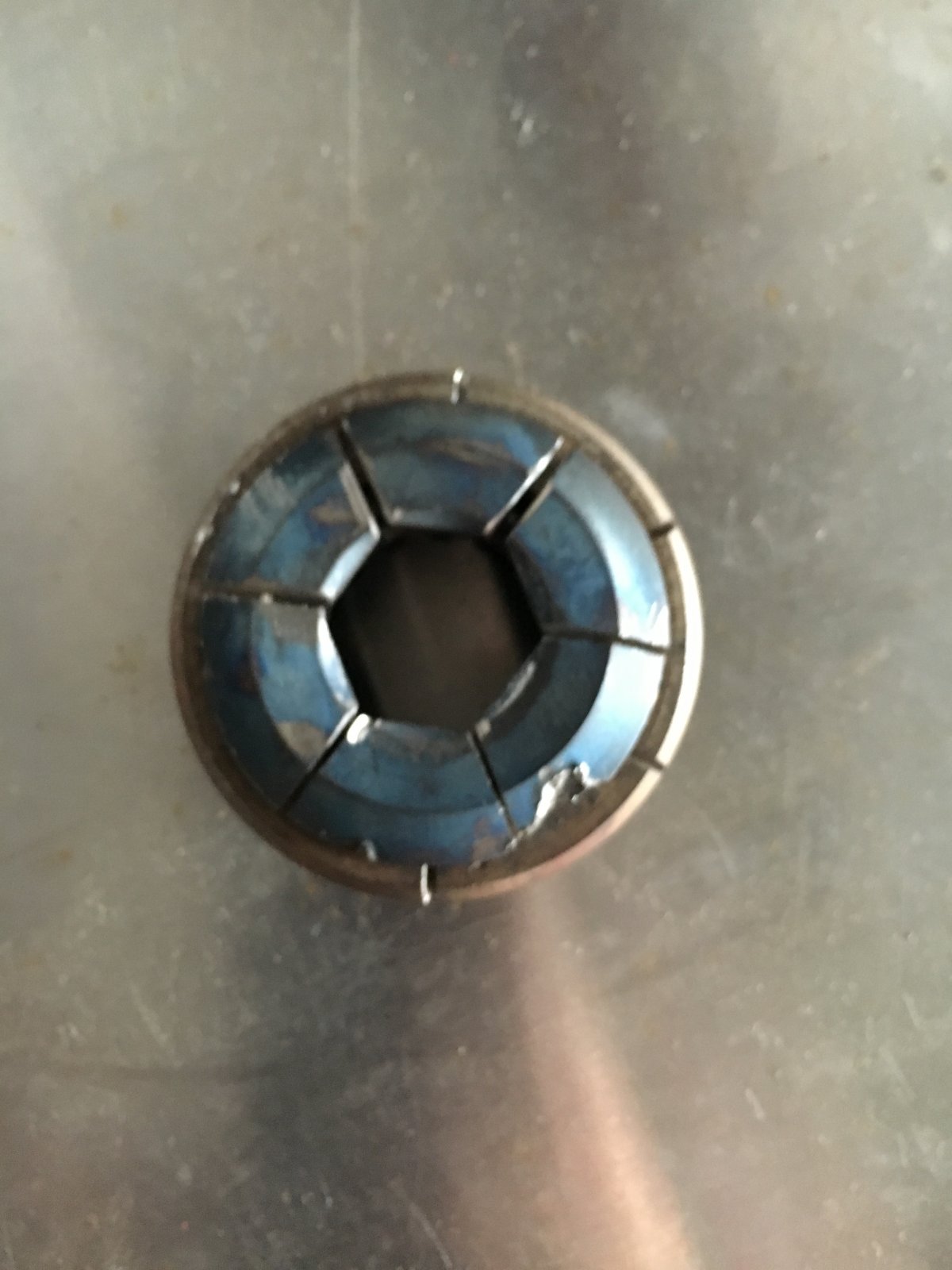

    Here`s mine from a 1098
    1 impacted driver (snap-on)-no movement
    2 headed and Chiseled-no movment
    3 Finally a 4 inch grinder- WooHoo
