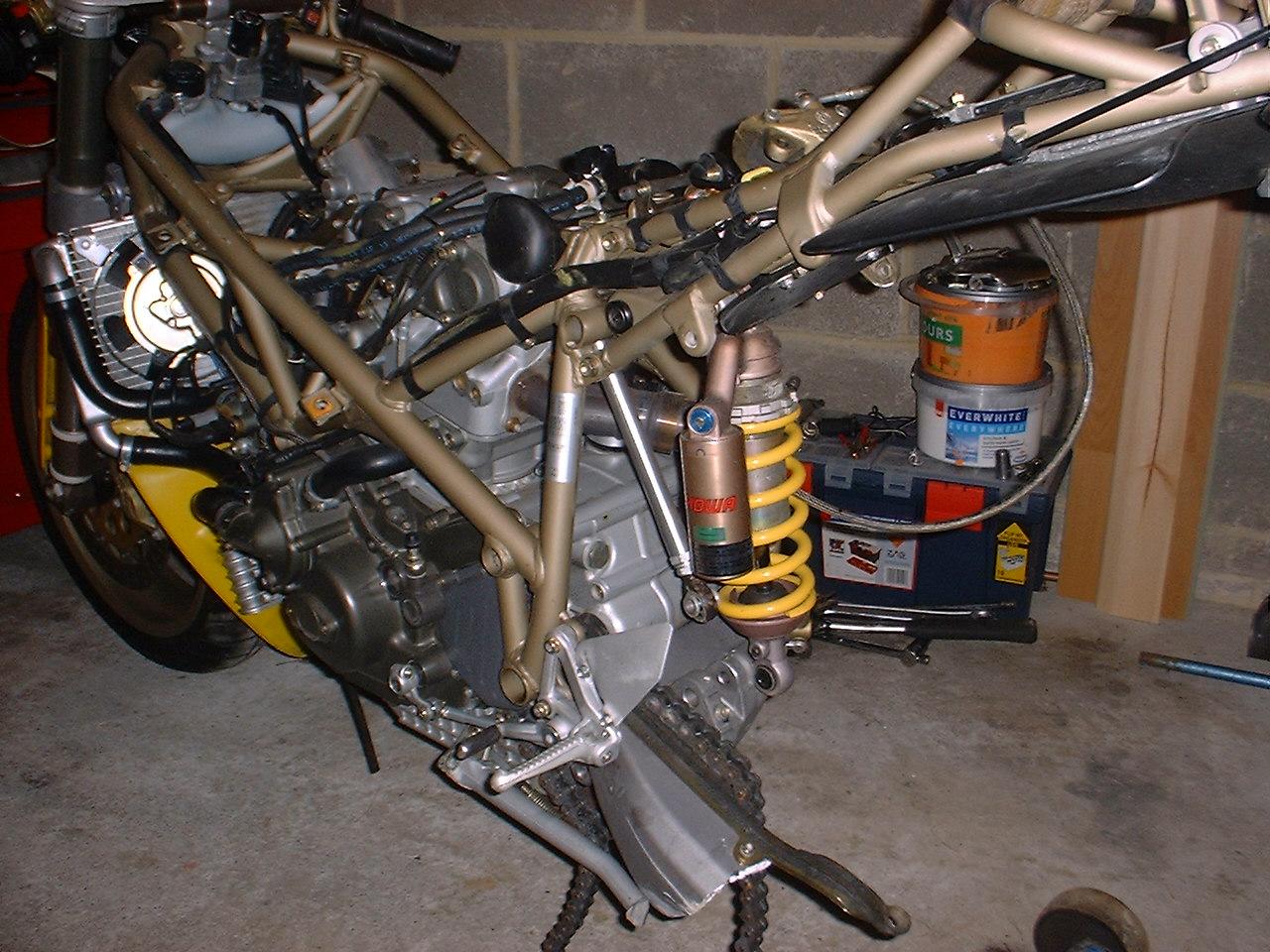

    Brace one side of the bike and hit the axle bolt with a drift. Once it starts moving, you're sorted. :upyeah:
