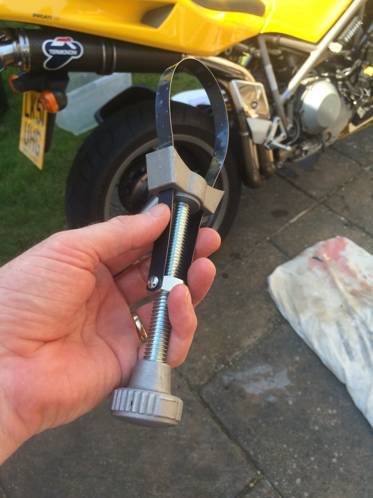

  1. No tried breaking them? Is this s sign of something?
  2. I got one like that from Lidls - works a treat :)
  3. Allegedly, the nut on the K&N just tears off if the filter sticks badly, so no great advantage there.
    Smear the rubber seal with oil and tighten fairly firmly but by hand only should make it easy to remove next time
  4. There have been reports of the nut searing off the K&N filters normally due to poor welding. There are members who swear by the K&N filters though. In my experience it doesn't make a jot of difference if you lube up the rubber seal, its still a bee of a job getting the filter off due to lack of purchase you can achieve on the filter casing, and before the flaming starts, yes I do lube up the rubber ring on both my bikes. Of the two the 916 is the hardest to get off and the hardest to get oil tight.
