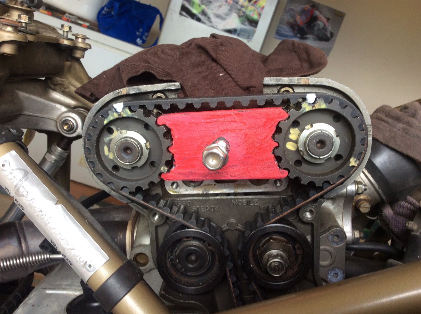

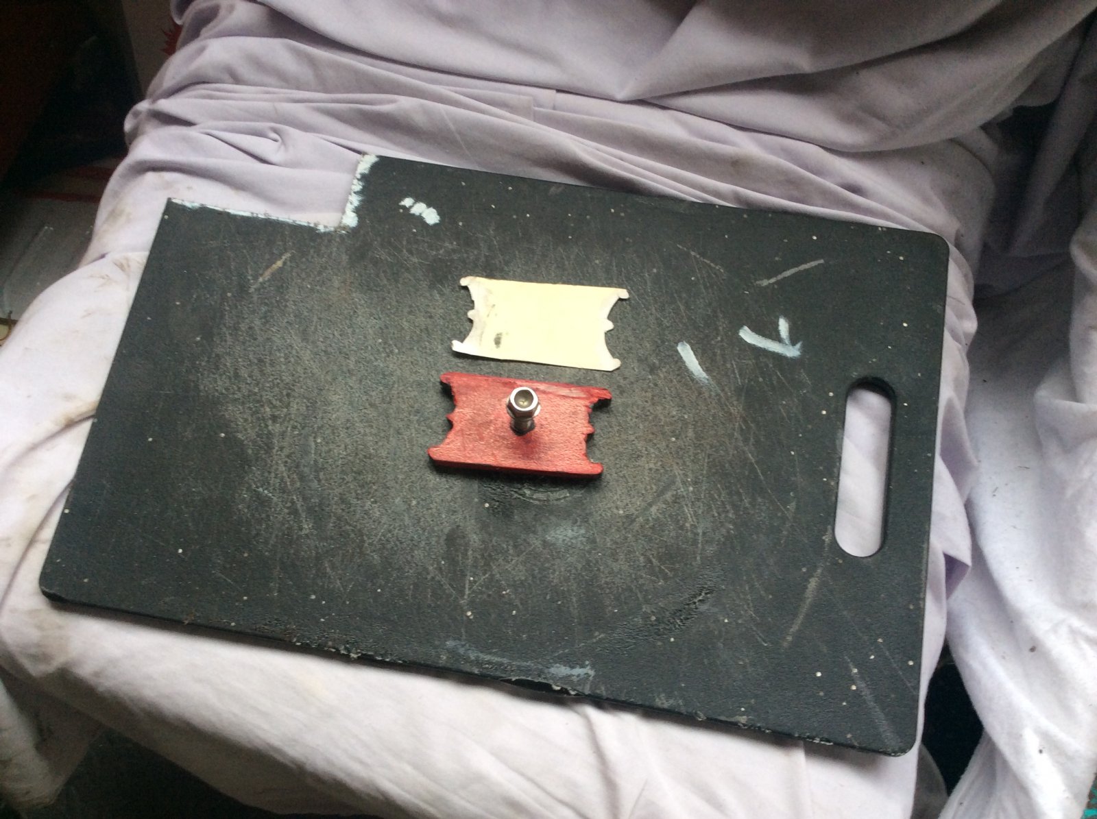

  5. Cheap cam holder tool.Steal or borrow wife's chopping board,Mark out a template out of card,cut plastic chopping board to the size that is needed,Mark out plastic use dermal and small round file to shape.Attach bolt for handle.
    IMPORTANT:return chopping board and say that you have been making space in kitchen to make wife's life easier.
