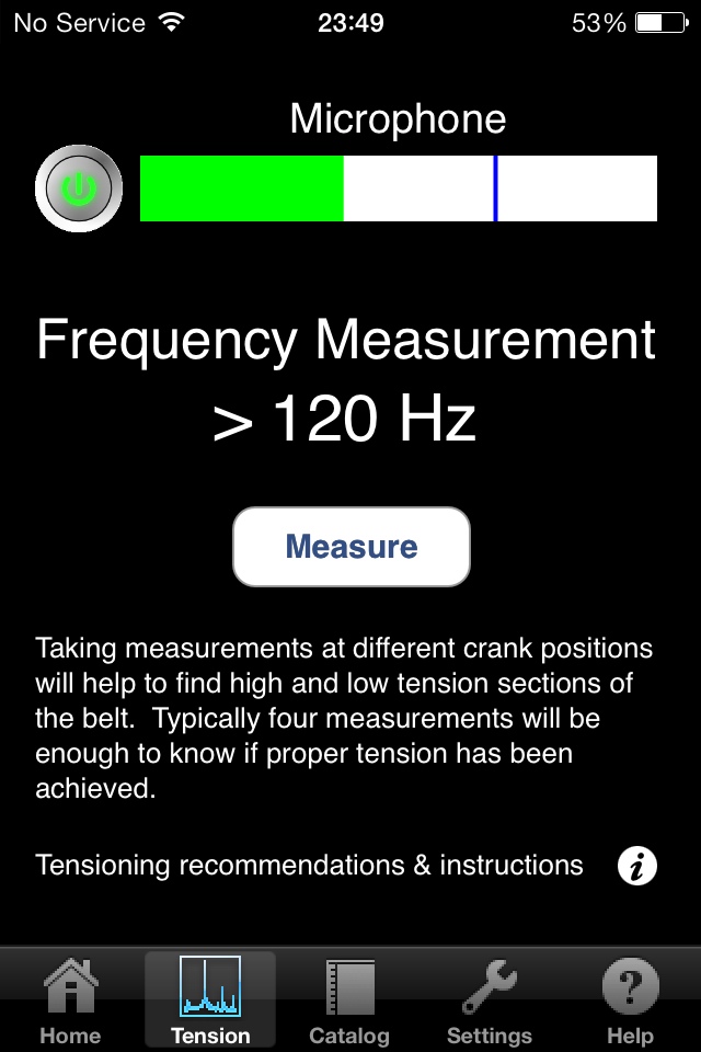

  1. The bar is for the microphone, not the frequency. The frequency readout is purely digital.
    The blue line on the microphone bar indicates the preset trigger level for a reading. If your plucking is too quiet for the green indication of the signal level to reach the blue bar, you can reduce the trigger level under 'settings'.
    If you want to alter the trigger level you will need to switch off the microphone with the virtual switch button to the left of the microphone bar first.
    My interpretation of the limited range of frequencies is that it is designed to exclude readings of irrelevant background noises, only taking readings from sounds within a range that is likely to be from your plucking of a drive belt.
  2. Thanks for your explanation Old rider. Got it now, thought I was missing a display of the wave form.
    Seems to work very well, and as you say no more sore thumbs.
  3. Fingers crossed...;)

  6. Make up your minds. Red998 is stalking about loudness and Old Rider about frequency :rolleyes:
    Presuming frequency, that for 2V engines is 145Hz so 120Hz is too low.
    And it doesn't matter what the display looks like as long as it reads the correct figure easily.
  7. Yes, I always used the Allen key method on my SS, so didn't realise how much higher the frequency is for a 2 valve. Sadly, this app won't work for the 2 valve motors then, as 120Hz is too low a limit.

  12. Managed to get my Iphone app working now, I needed to turn on the microphone in settings, so that's all sorted thanks.
