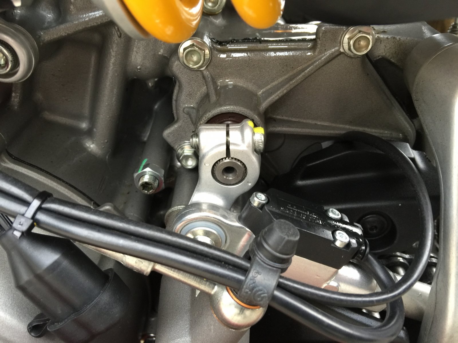

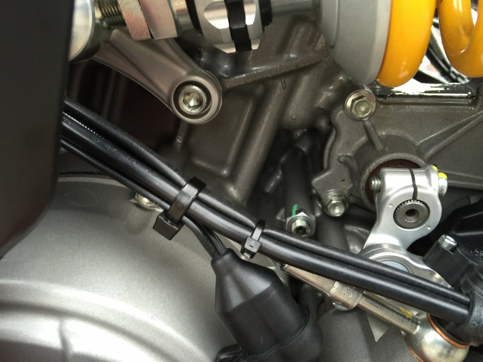

  1. Ok, so I took the bike out on Sunday and it got it's first proper run, A roads, some dual/motorway all under 6k revs but accelerating at a reasonable pace.
    When I got back I noticed that was oily residue on the left exhaust, a few on here suggested it was simply chain lube melting and dripping down.

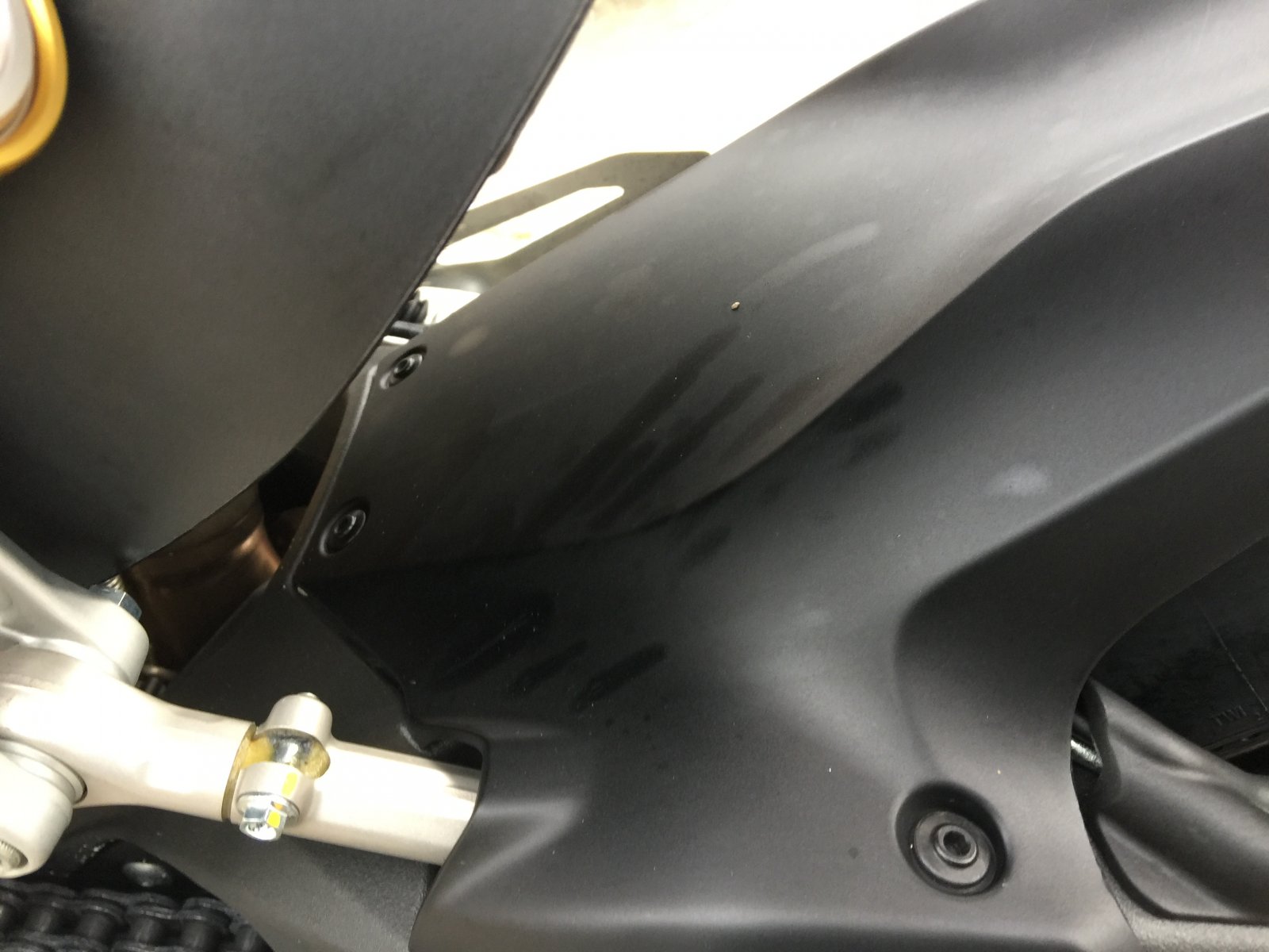

    I rode to work today and the bike was out in the sun and on my Blade i'd get some petrol escaping out of the overflow where the tank got so hot. Same thing I assumed today when I saw wet patches under bike. Rode home and noticed that there were drip marks all over the rear hugger, and could see oil dripping down under the bike. Closer look showed the whole engine case covered in oil!

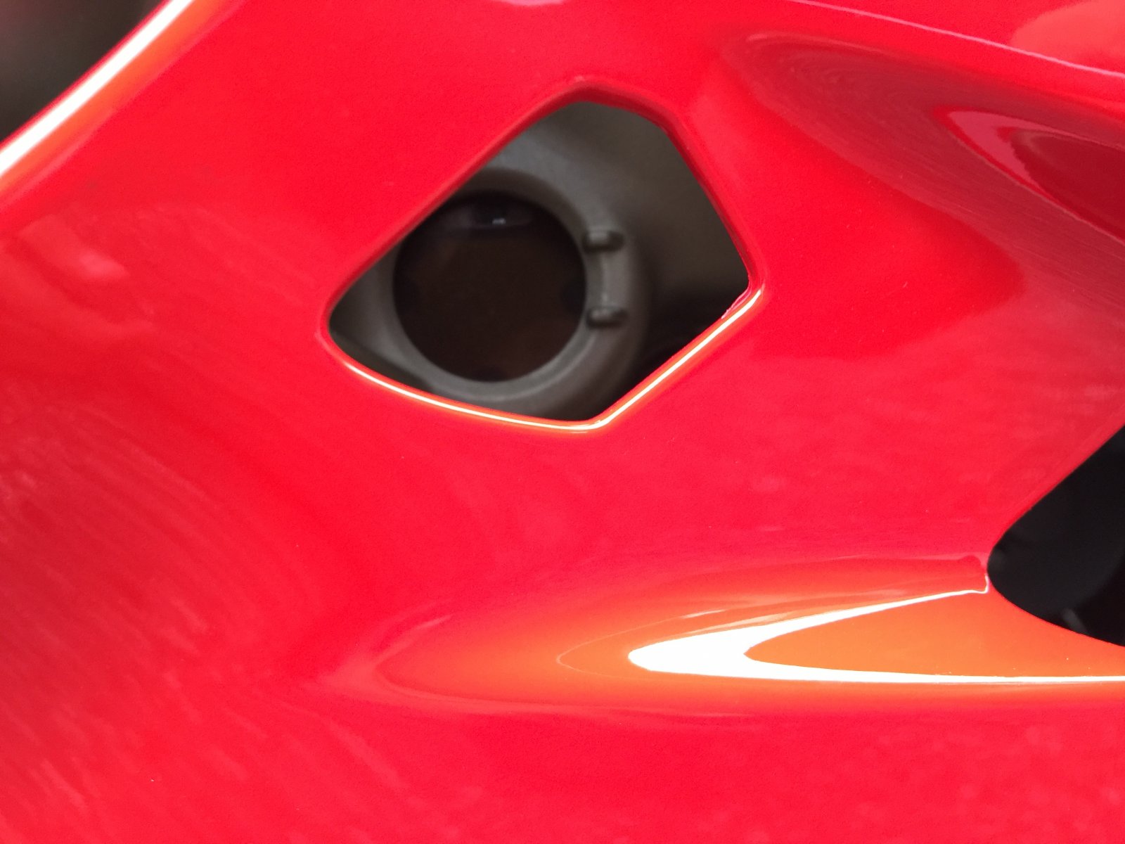

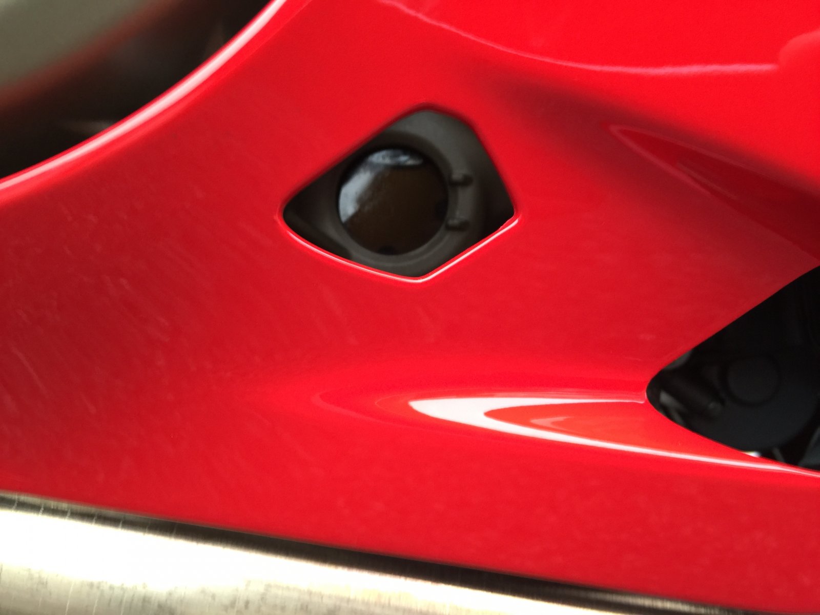

    Took a look at the oil level (admittedly for the 1st time) and it was at the top of the window! Over filled by the dealer on delivery I assume?! Could that have caused too much pressure and for a seal to break or worse?

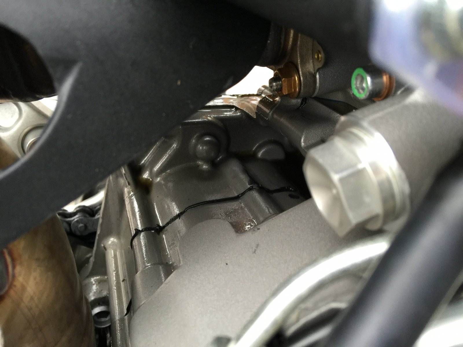

  2. Check that the rear cam cover hasn't been caught up or damaged during production. Its an easy fix by your dealer.

  5. I'll see how efficiently they handle this 1st... Part with £17k and 4 days and 160 miles I get this, I wasn't expecting Japanese reliability but...
  6. Easy fella; we as dealers don't take off the cam covers or anything like it at PDI. If a cam cover is nicked or not 100% in the correct position, it could easy take many dozens of miles for the oil to work its way through before it shows itself as a leak.
    We only take them for a run for 7 or 8 miles as part of a PDI.
    I don't know who the dealer is but IF this is what it is, the chances are that the dealer wouldn't have a chance in hell to spot it.
    So don't blame the dealer, blame the manufacturer; or in fact don't blame anyone until you know what the problem is; bikes are built by humans and sometimes humans make mistakes. It'll be fixed and that'll be the end of that.

  17. Probably overfilled with oil and its chucked some into the air box and its then found a leak path out and run down your rear cylinder.
    You could lift the tank and have a peek in the airbox just to check it out, would ease your mind a lot :confused:
    Lifting the tank is quite easy really, take you 15 mins, pm me if you want a step by step talk through how to do it.
