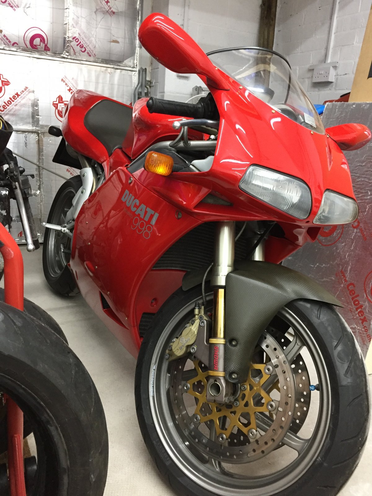

  6. :sunglasses:picked it up last night.....Bargain!
  7. Stick a link up then!
  8. Here it is!
    • Like Like x 9

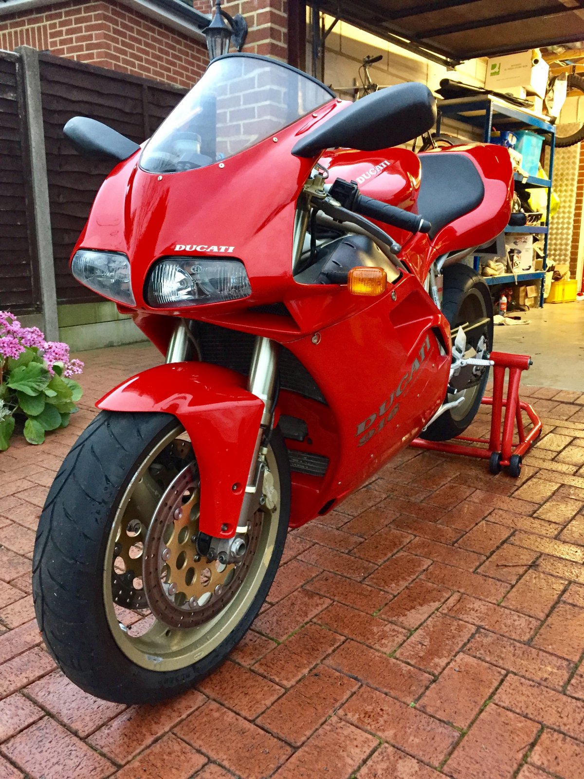

  16. I just used a bit of clean rag tied around a wooden spoon - sprayed a bit of window cleaner in there and it just wipes off - the right hand side is harder to get at, due to the smaller opening to get in at. But mine looked awful, now looks a lot better..
  17. Now that's a well loved bike,got to keep reminding myself how old these are!
