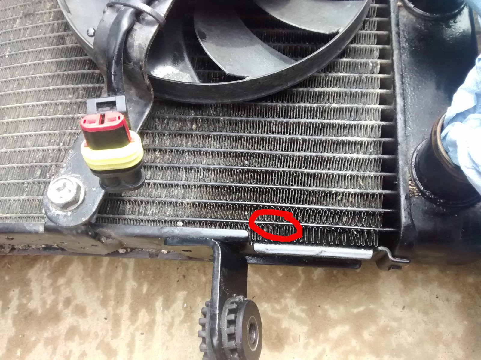

  1. I took my rad off today. I can see the wet patch but no actual hole ?
    Can someone ms paint an arrow to where it is leaking or show a pic of their repairs ?
    Much appreciated
  2. Usual suspect is the top left mounting bracket
  3. I have the top left mounting bracket pictured but cannot see a hole ?!
  4. It wont be a hole, but just a small split where the weld has gone, comes out a lot when running but not when not (at least mine did)

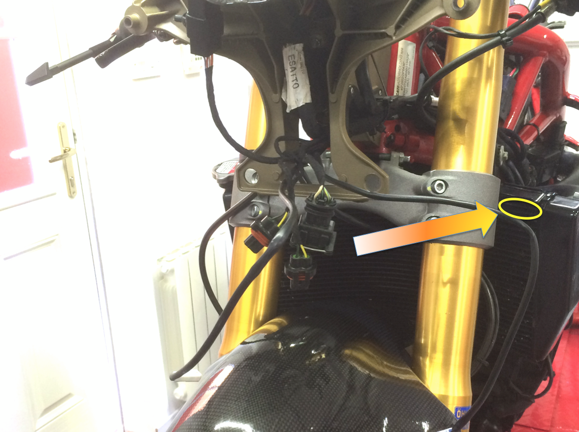

  5. It will be here:
    Cover it with a bit of soapy water, and with the cap on cover one pipe inlet. using a bit of rubber attach an airline to the other hose hole and you will see the bubbles.
  6. Mine has just gone. I can see moisture from the top row of fins on the core, but haven't removed it yet for a proper look. My new rad should be here tomorrow, so I'll take it off then and have a look.
    Have you tried a soapy water test? Get some fairy liquid with water in a bowl. Block the bottom hose outlet off, leave the radiator cap on and put some pressure into the radiator with a compressor. Brush the water / washing up liquid around the suspect area and you should see it bubble where air is escaping.

  7. Thank you Bob T.
    I don't have the facilities to do this test so I will just epoxy that whole area you circled for me :grinning:.
  8. Epoxy worked for me but not as in Araldite, but the epoxy metal that you mix together. As I don't expect it to stick very well, it is under pressure, I also put a thin bit of aluminium along that part with the epoxy gluing it on and held it in place with two short bits of locking wire through the radiator fins.
    I expect it to last forever. I was out all day today, and it was 25c here, with no sign of any problems.
