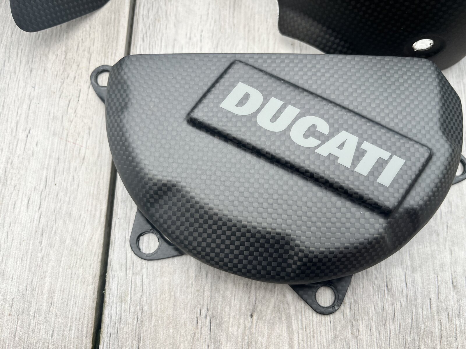

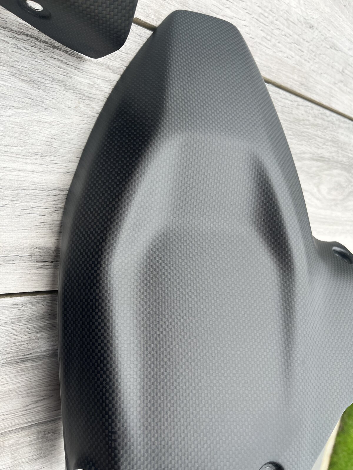

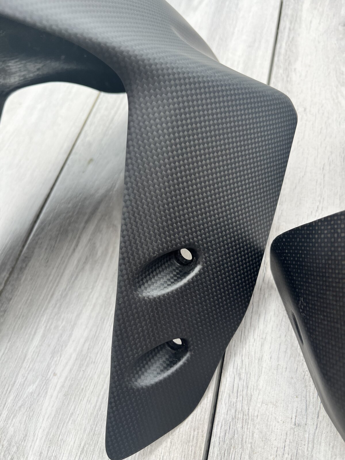

  1. The previous owners had polished some of the carbon on my Panigale R and even rattle can gloss lacquered the exhaust shroud which made me very unhappy . So, I stripped all of the original lacquer off the carbon parts, rubbed them down to a smooth finish then found some 2k Matt lacquer. There was some damage to the front mudguard, probably caused by a disc lock and some gouges in the clutch cover which I repaired with some clear araldite. I painted the carbon parts yesterday and I think the results are excellent. So much so that I had to paint the chain shark tooth guard and shock protector as they looked crap next to the newly painted parts.

  6. They look really good
  7. Yeah, really pleased with them. As good as a factory finish.

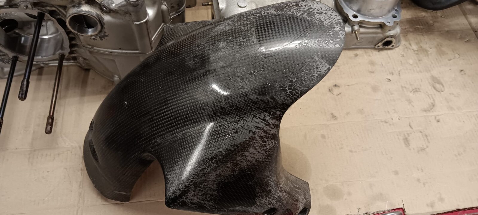

  8. wow wish I had the balls to try this on the 996. The original carbon is old and pitted. Would love to get it looking back like this... Jealous !
  9. Fortune favours the brave ,take your time and go for it
