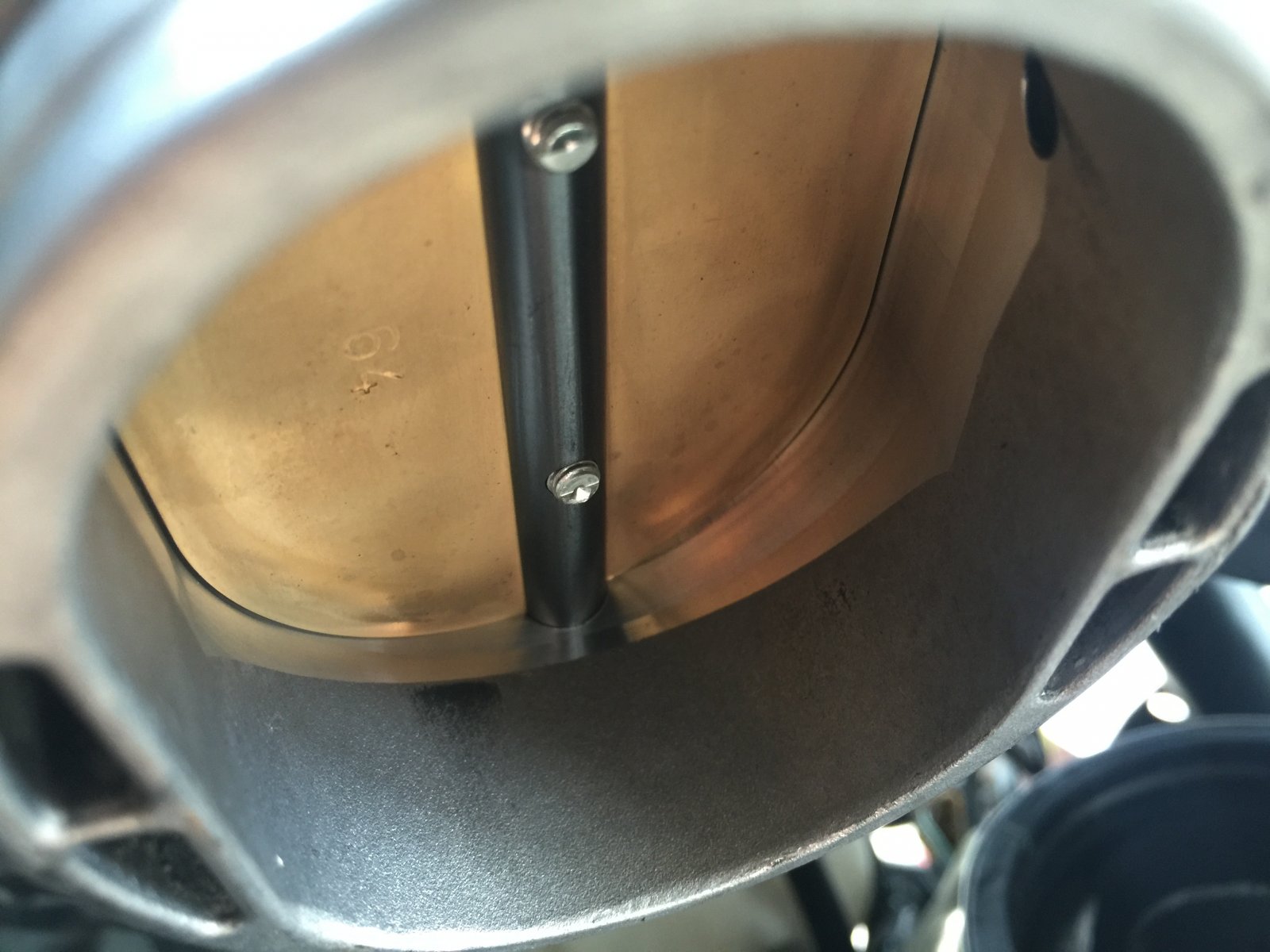

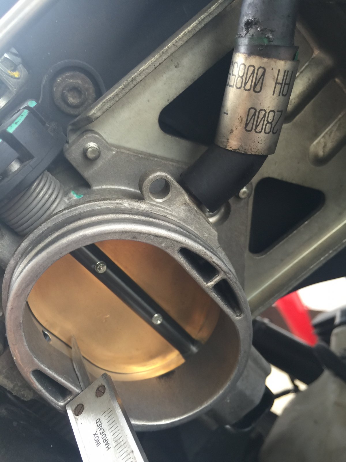

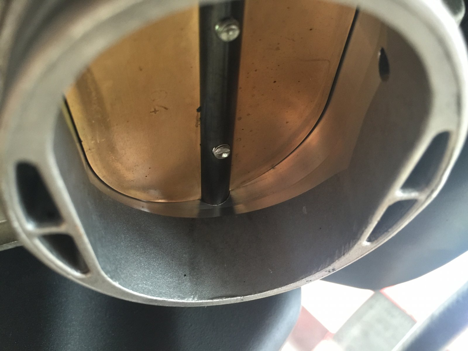

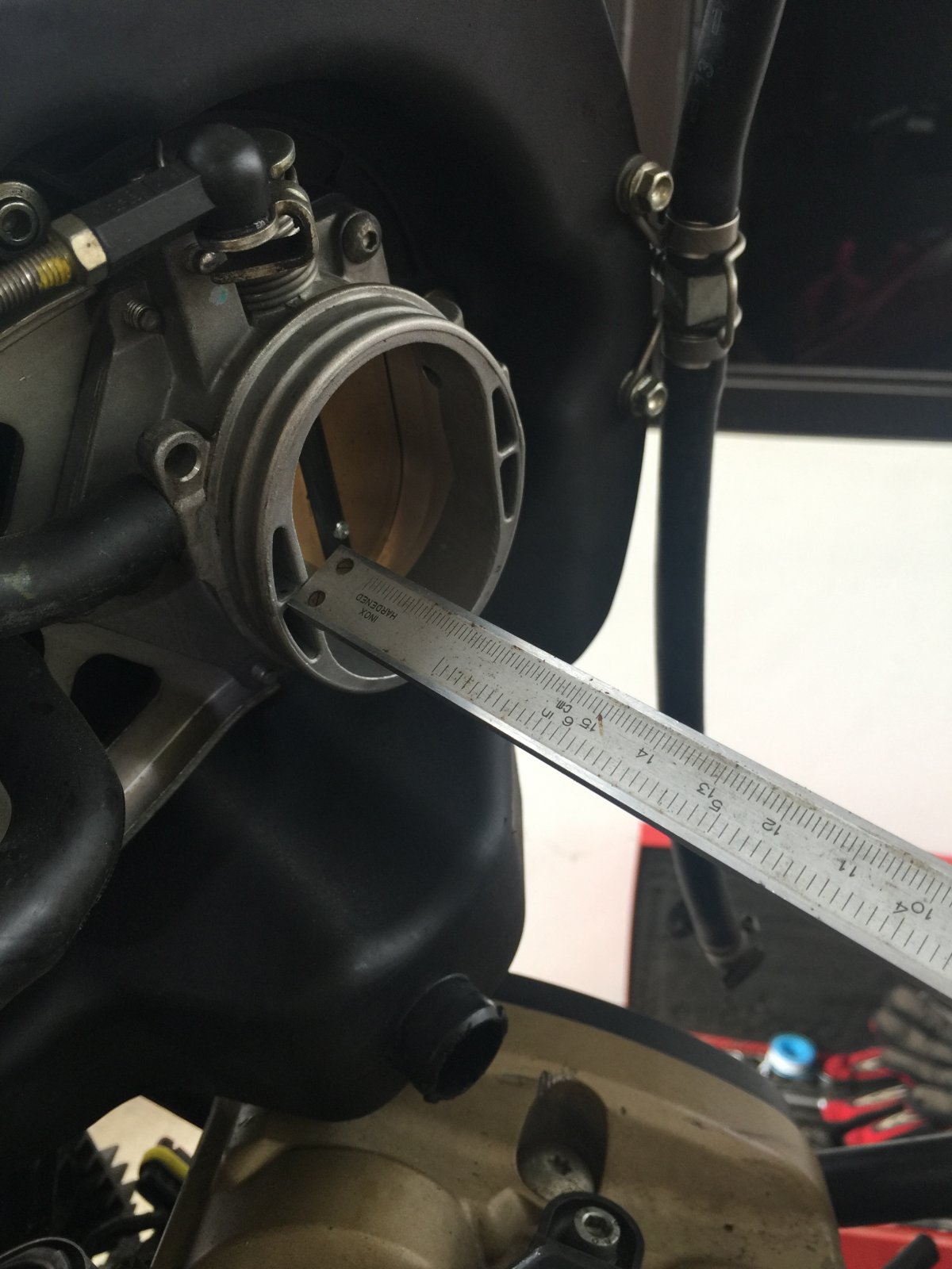

  17. I know it's not a hi tech way to do it but don't know how else to do it...
    The difference is:
    23.75mm
    22.25mm
    I tried to opload some pictures but don't think you can see so much on it...
    And to it seems that everything is running fine except the small difference...
    Hehe this is so difficult when I know nothing about what I'm doing but trying to keep the mood up because I need too get this bike running again....
  18. They both look to be closed properly. Work the twistgrip to see that they open and close properly and without any sticking. When shut, run a reset of the TPS with your diagnostics. If you're able to get a throttle reading with the diag program, open the throttle fully and you should see about 85 degrees.
    If that works out then the TPS should be working ok.
