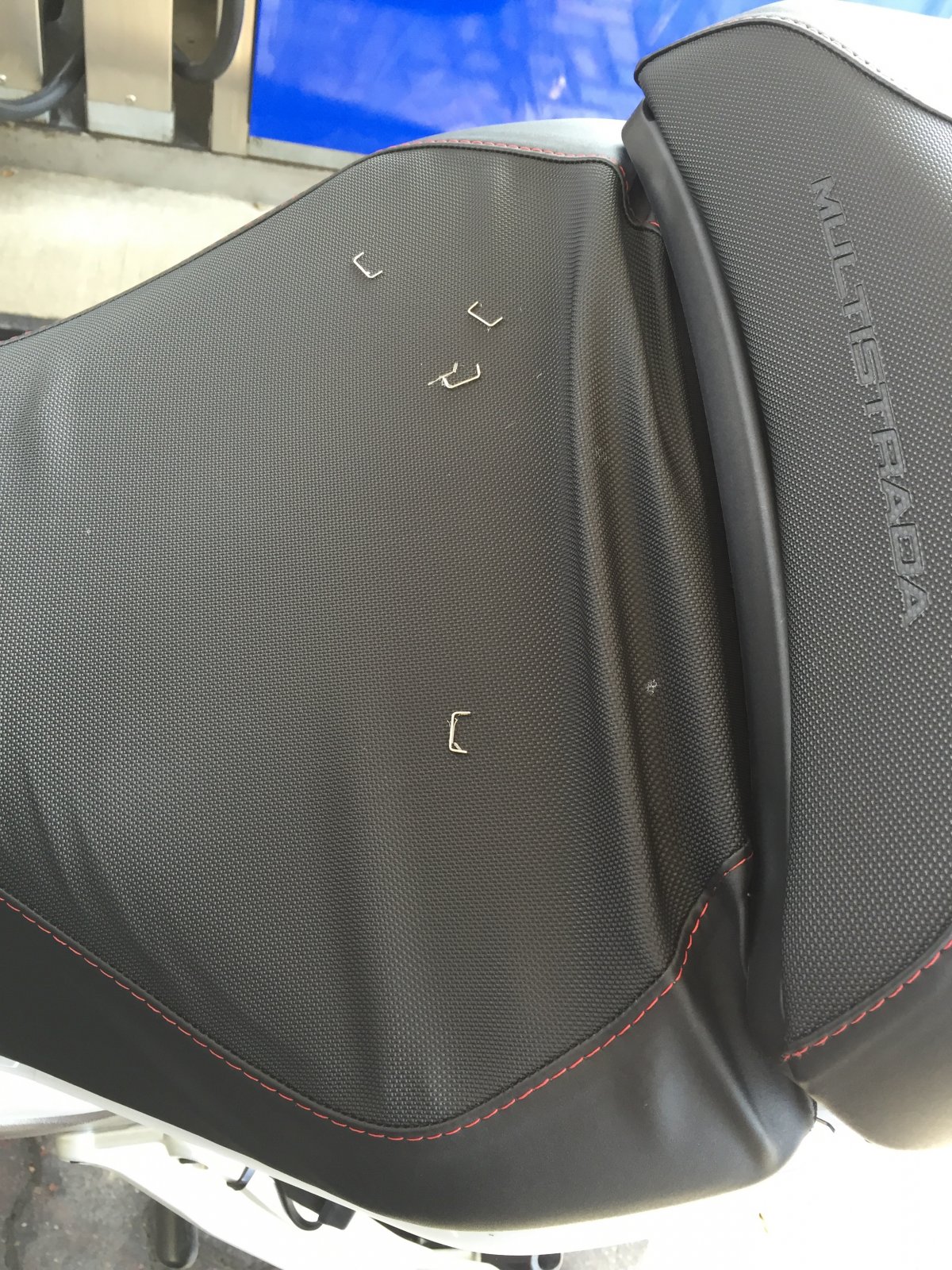

  9. Paid for my fuel n came out to see this....crap quality control, will mention it to the dealer on Monday when they fix the non working fuel guage!
  10. The DVT seat looks poorly designed, poorly made and not thought through to me.

  13. One of the major benefits I have found is the seating position. I usually get lower back pain after a day on the bike. Not on the DVT. I am 5' 8" and the riding position is spot on for me. I recently rode my mates GS LC and I felt as if I was perched on top of the bike instead of sitting in the bike, therefore during some spirited riding on excellent bendy roads in the north west of Scotland, the DVT was much more accurate when negotiating the bends in the correct line. The front end of the GS was also quite vague and certainly not as precise as the DVT. Again, it's an individual thing, but that is why it is so important to test as many bike options before parting with your hard earned. Jimvee's burst seat is a concern though. What on earth is going on with that. I've just checked my seat and it is fine?

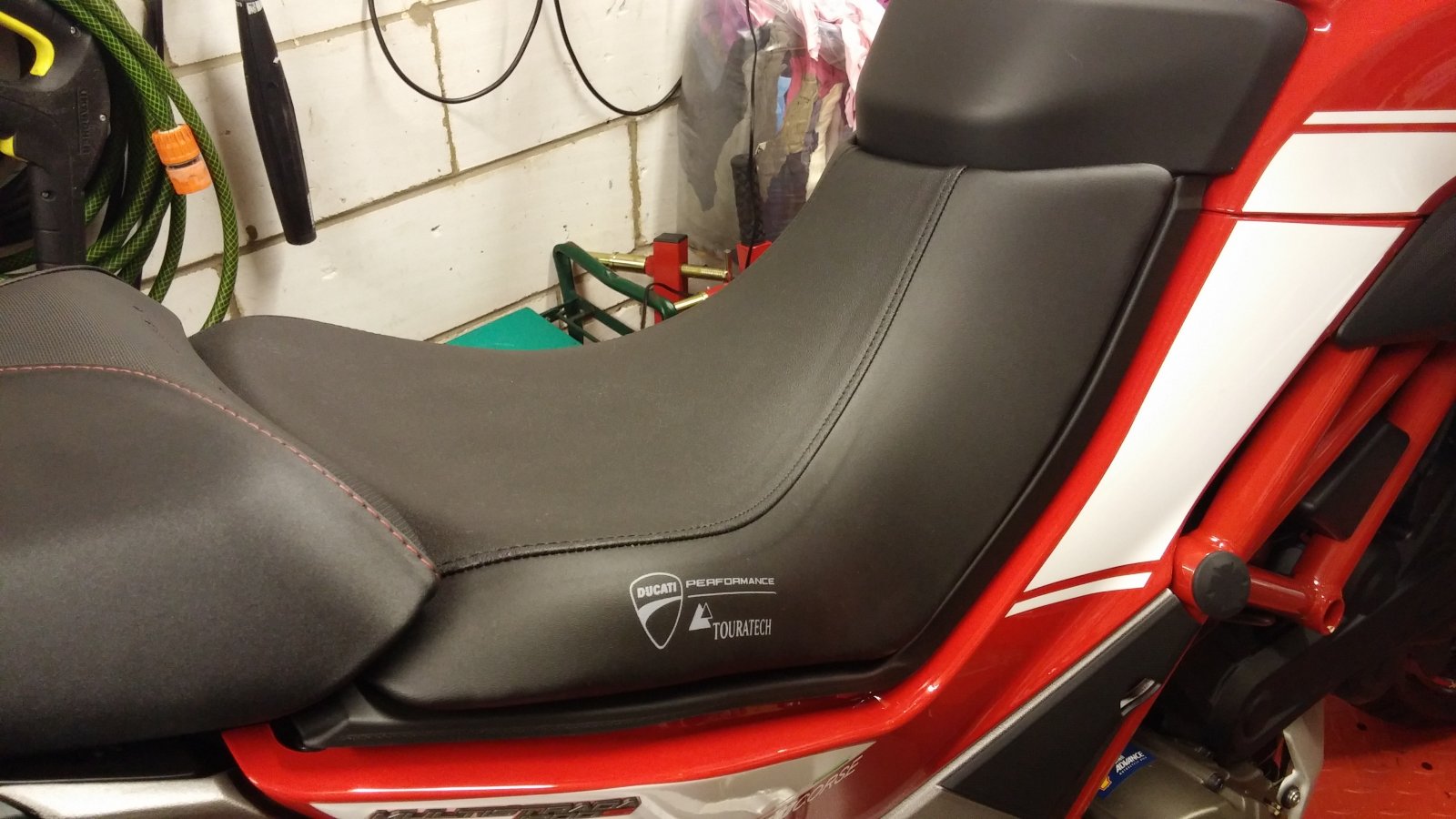

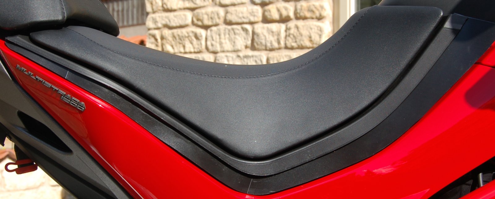

  15. View attachment 54425
    A very nit picking whine but you would have thought Ducati/Touratech would have used red stitching not black. Seat depth looks thicker though
  16. Are there any links to the Touratech seat?
  17. yes I'd say it's a inch thicker all over. Much better, but I'm getting mine remade with some extra memory foam and he said he'll mimic the original cover so it will match the rear seat. The top material on the touring seat is different. It feels more rubbery so you don't slide so much on it. That doesn't help me wearing Adventure Textile trousers and the materials stick and I slide around inside the trousers. With leathers it's fine.

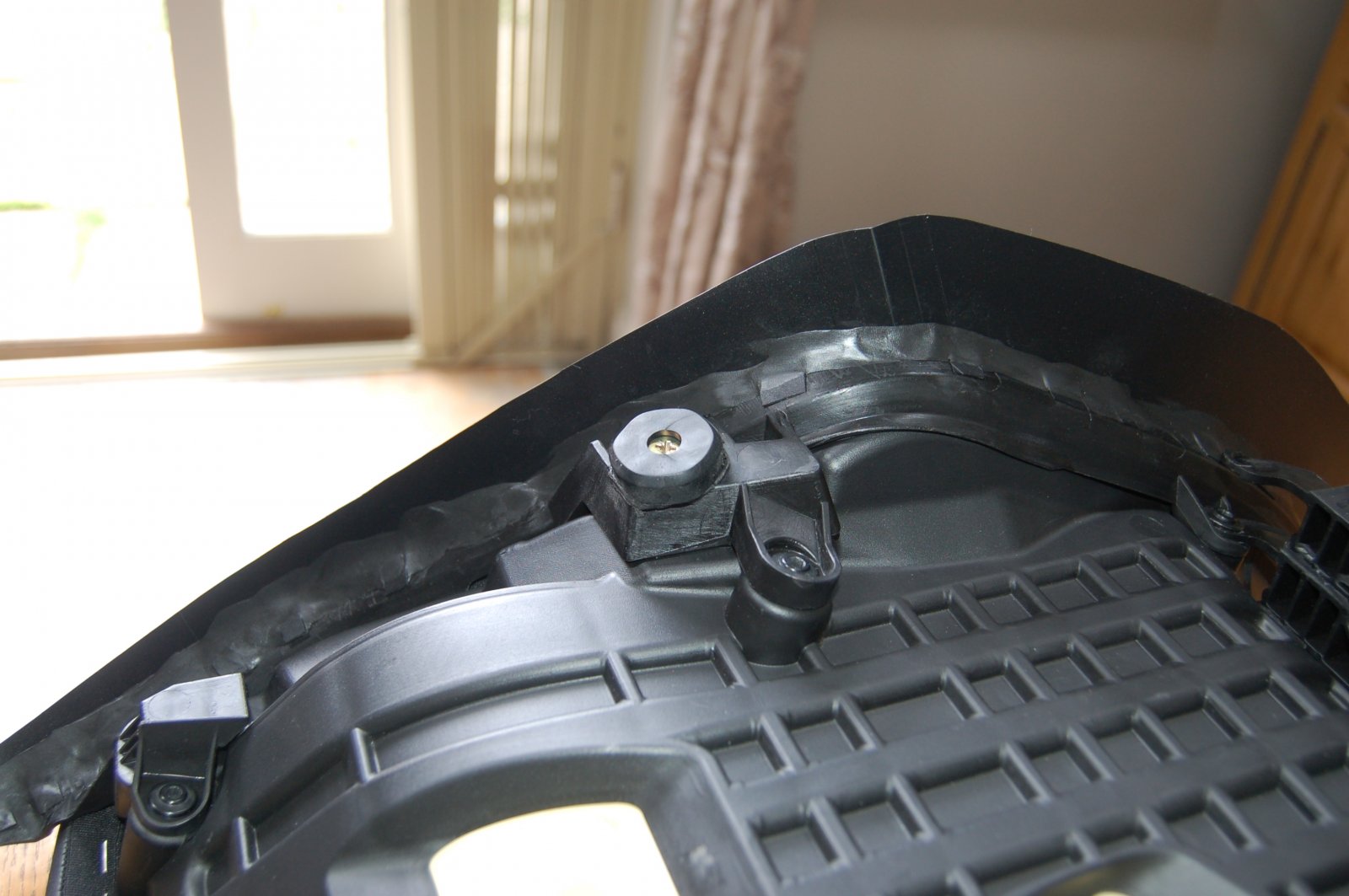

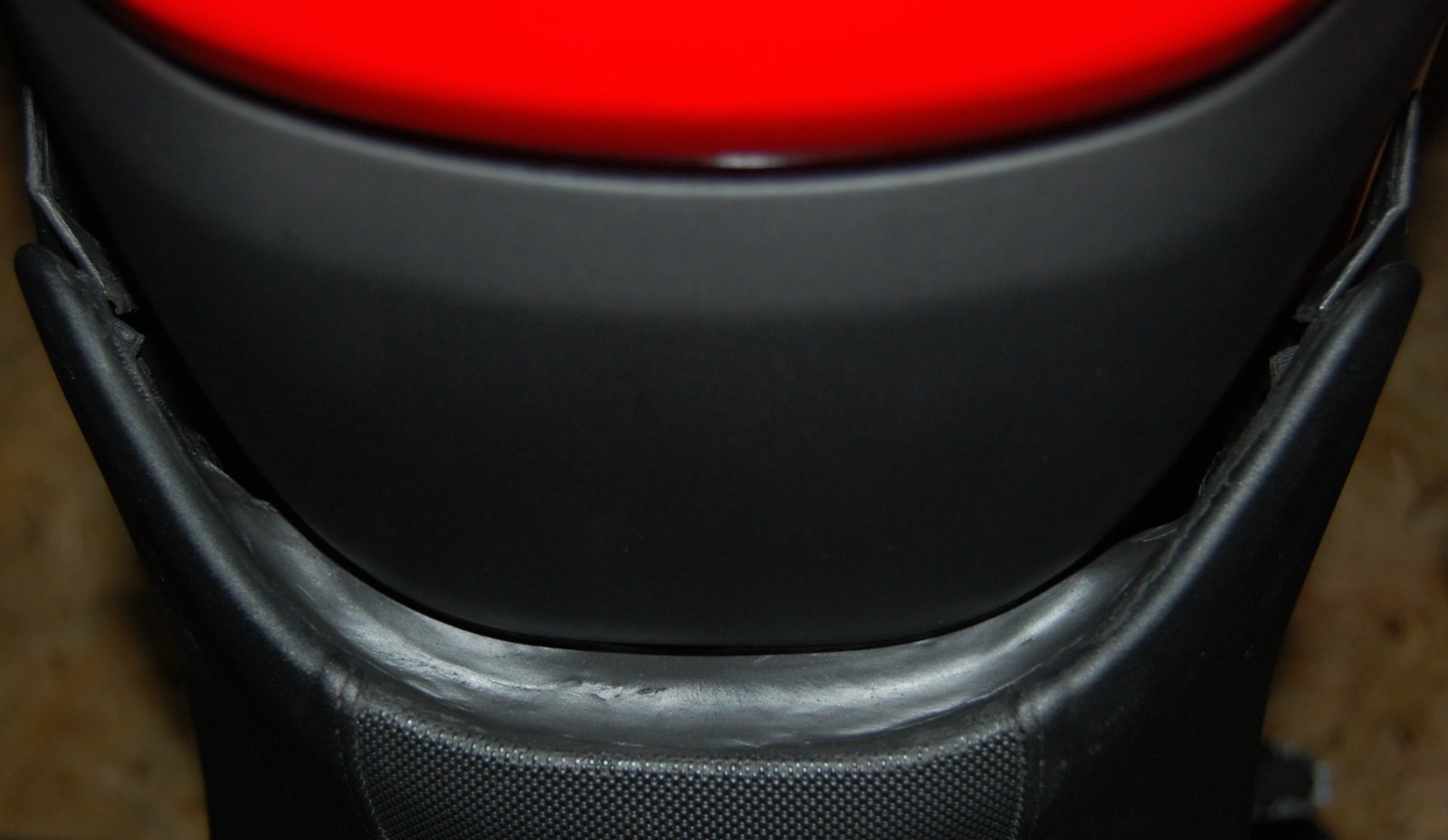

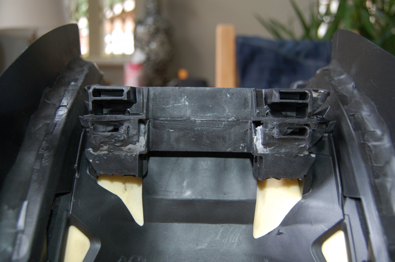

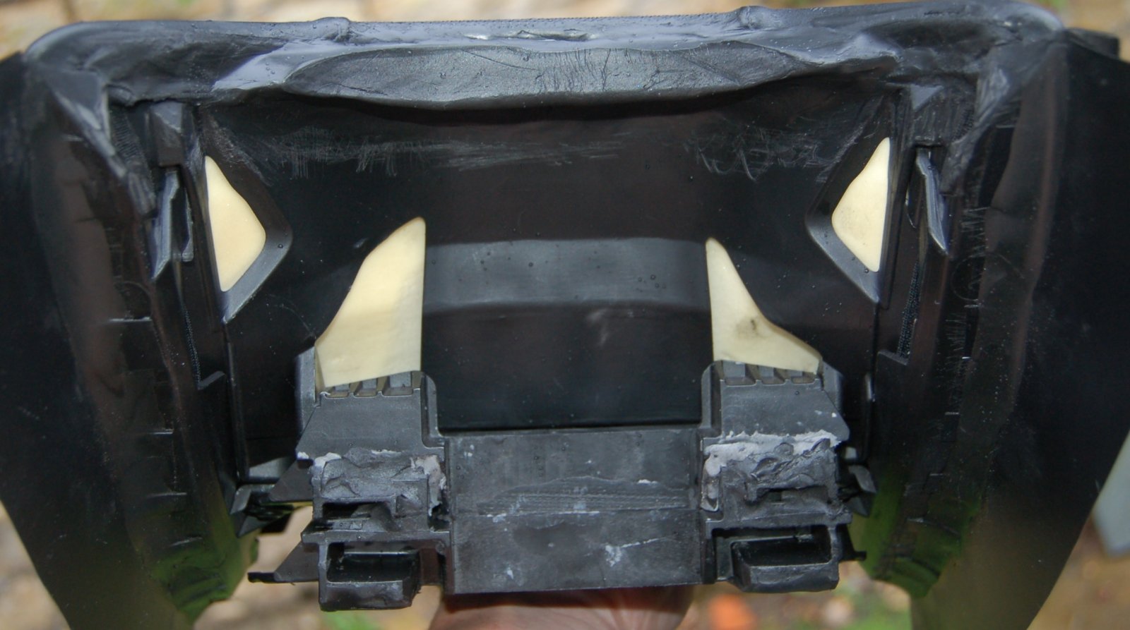

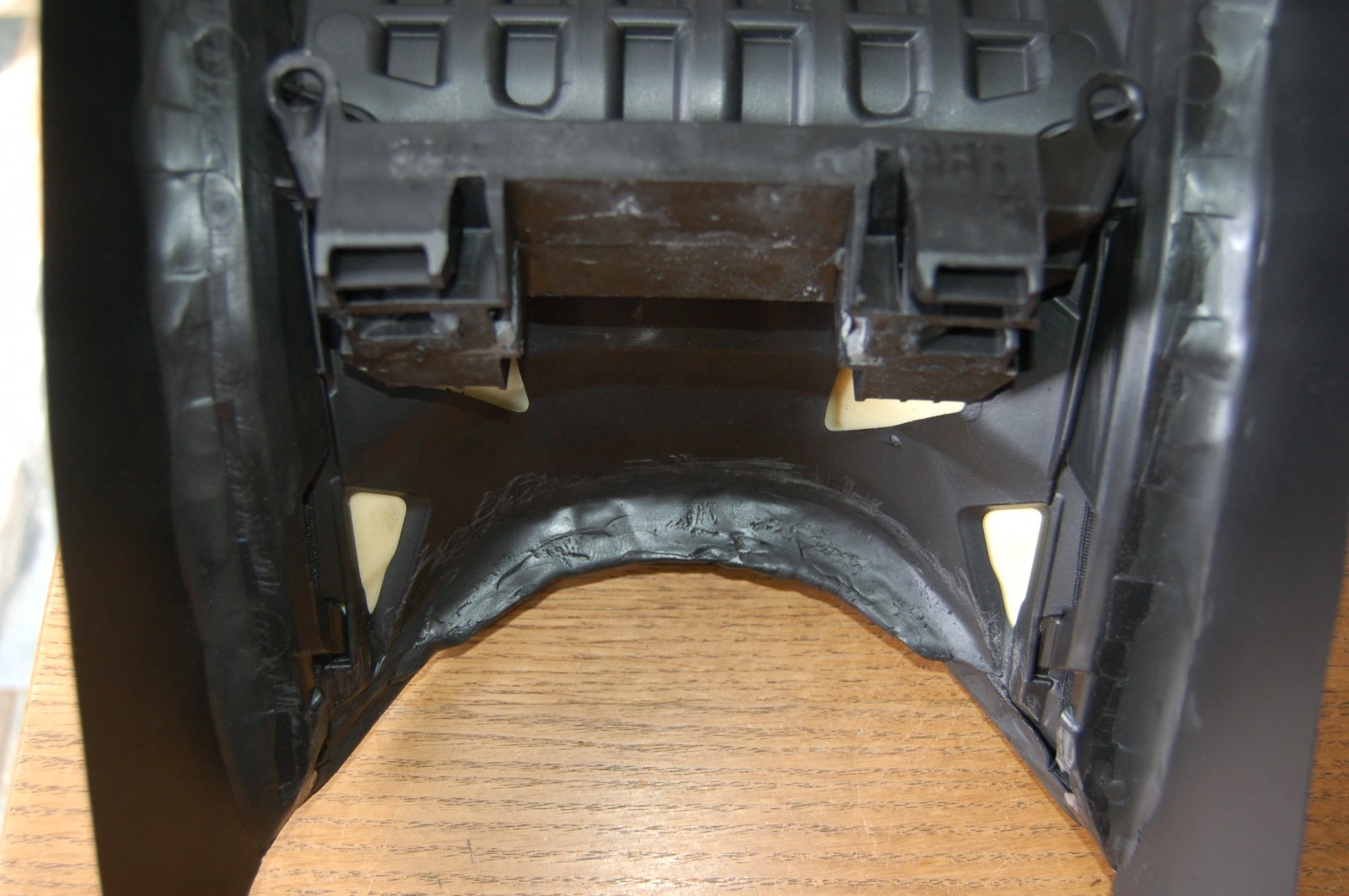

  18. I hated my DVT seat. Needed raising and flattening so I modified it myself by adding an extra front bracket (trimmed so it slotted into the existing one) and I made extra infill panels to cover the bigger gap. I also filled the hole between the tank and the seat using Sugru which moulded nicely to fit the profile. I also used Sugru to fix the 2 brackets together and to attach the new infill panels (these were cut from a black plastic A4 file sleeve from Staples). The mod took a day to carry out and the results are amazing - I can now ride all day without any sign of the numb ass I used to get after just an hour. Done about 600 miles since this mod and it is holding up fine. DSC_0493.JPG DSC_0488.JPG DSC_0488.JPG DSC_0493.JPG

    Glad you sorted it, I'm also concerned that the new seat tilts you forward (like the old seat did before I bought the comfort version)
    A few more pictures of the brackets etc would be appreciated...
  20. Here are more pics...
