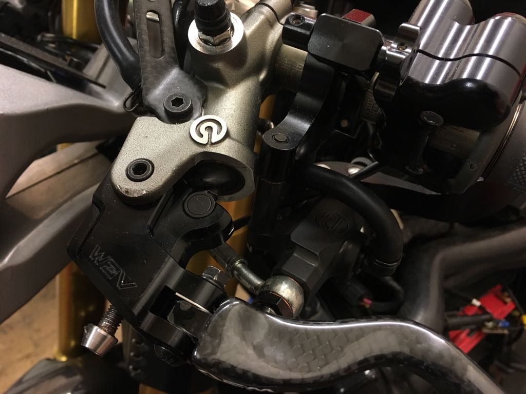

  5. I dunno, imo if changing levers you might as well convert them to folding types:
  6. Is that snake skin? Now everyone will want them! :p
  7. Carbon fibre dear boy
  8. :Finger::Watching:
