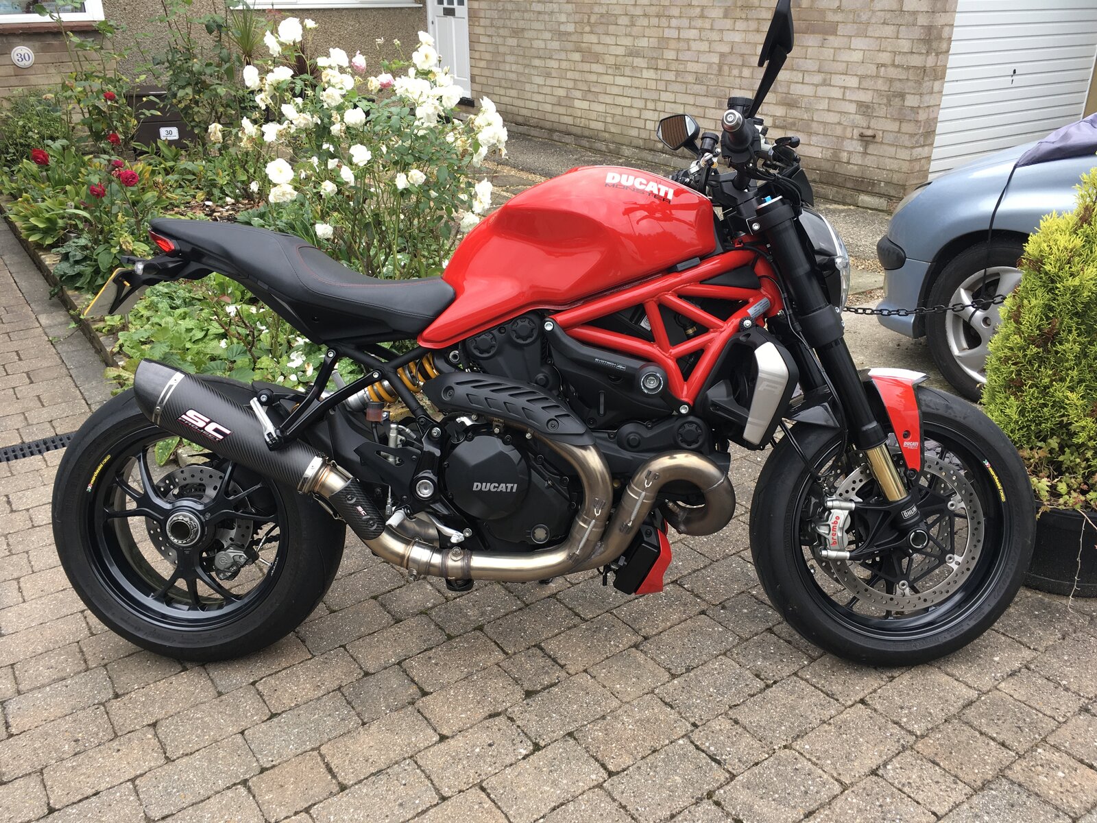

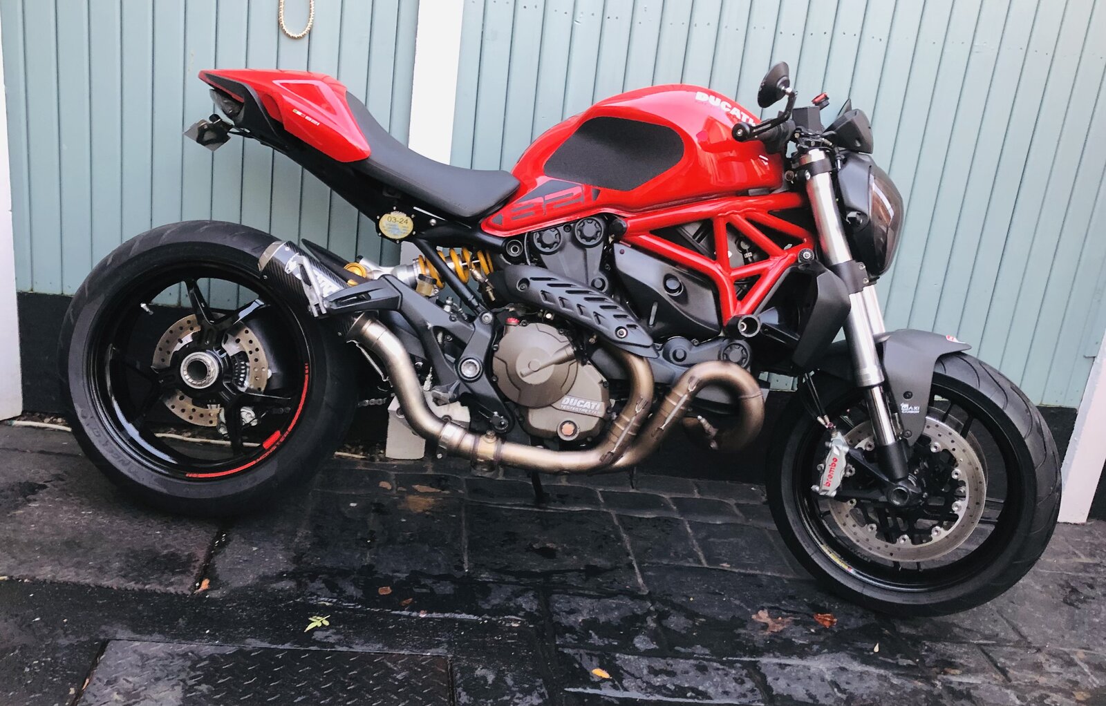

  2. I’ve got a Mivv on my 821 and it sounds great and they are a very good price 7C091533-D7B0-4FF3-8E9E-292FFEFAF079.jpeg IMG_3758.jpeg

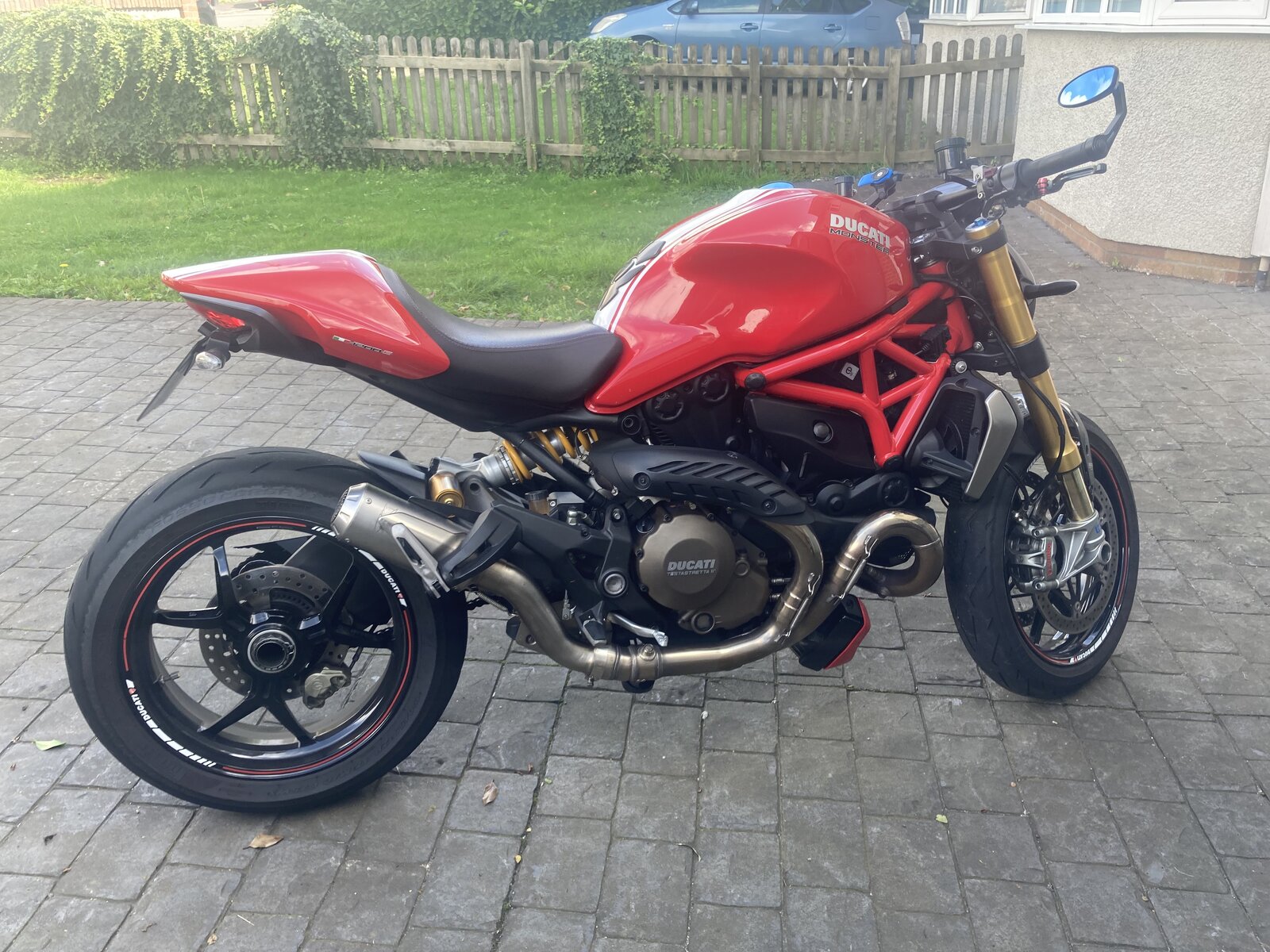

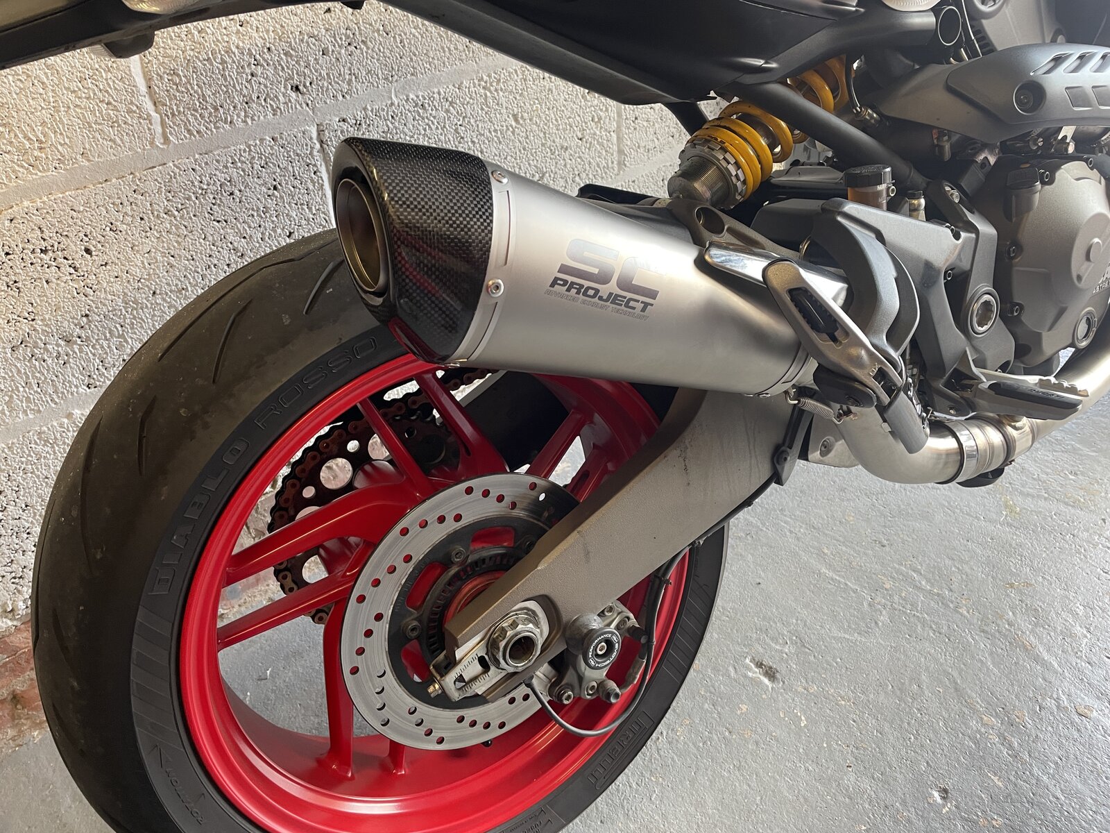

  8. Tidy pipes!

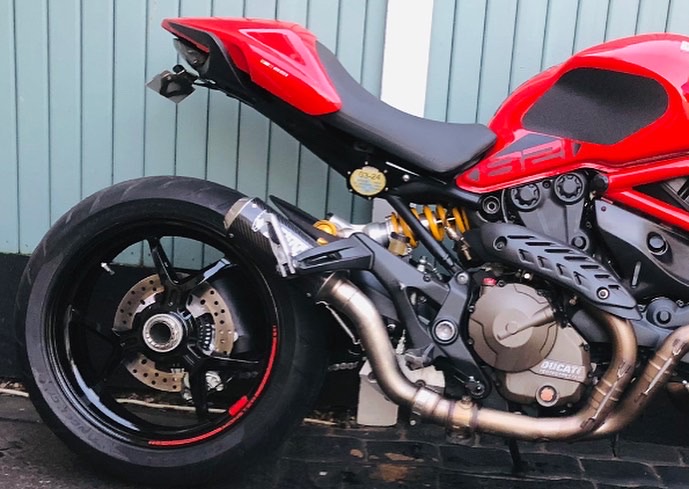

  9. An aquaintences bike, I hope you can zoom in.

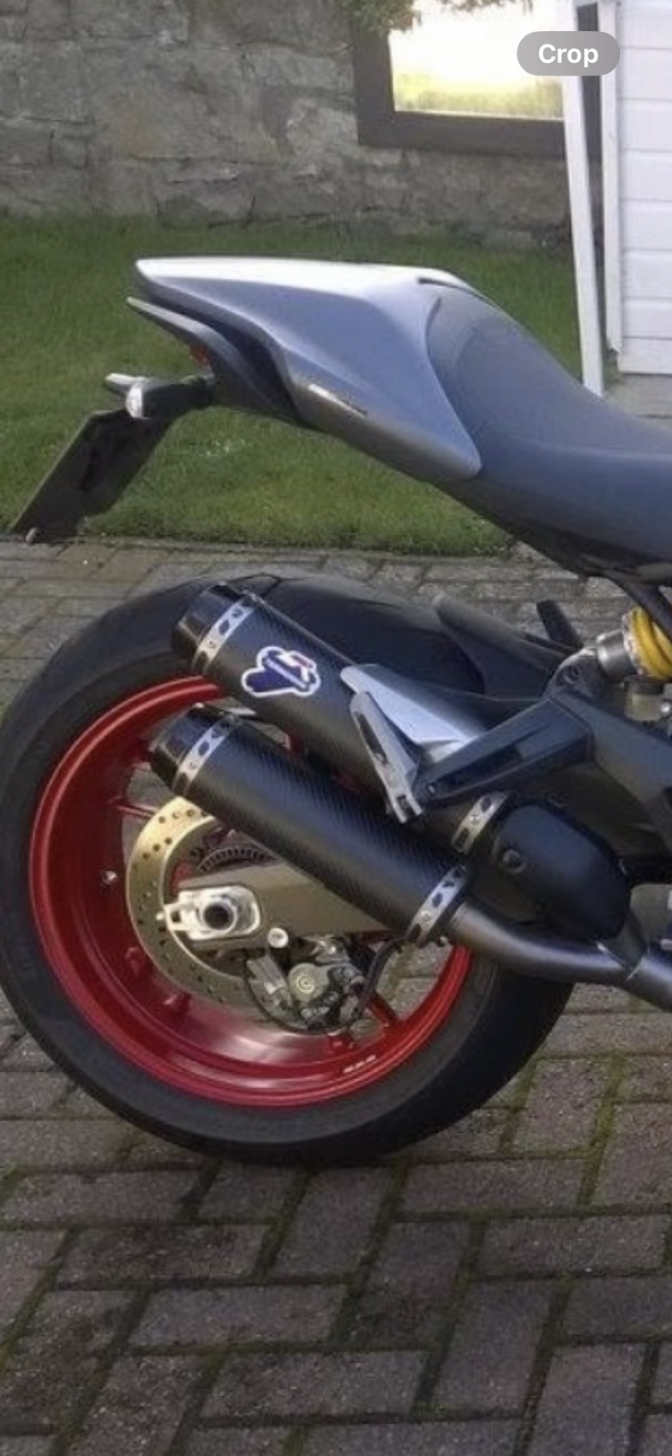

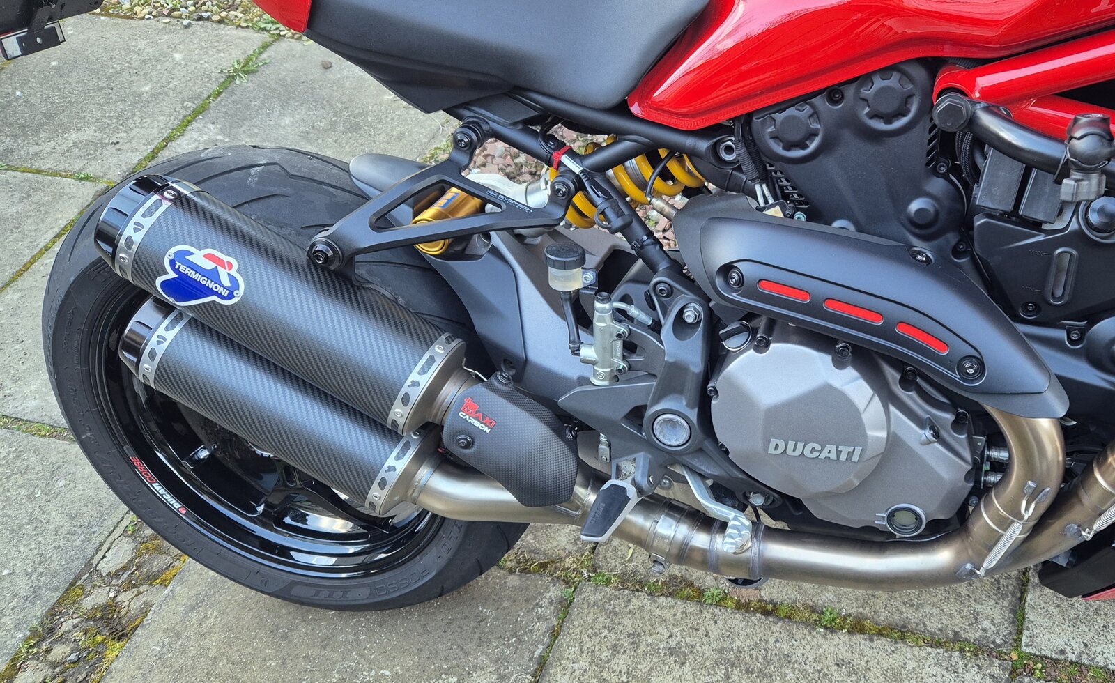

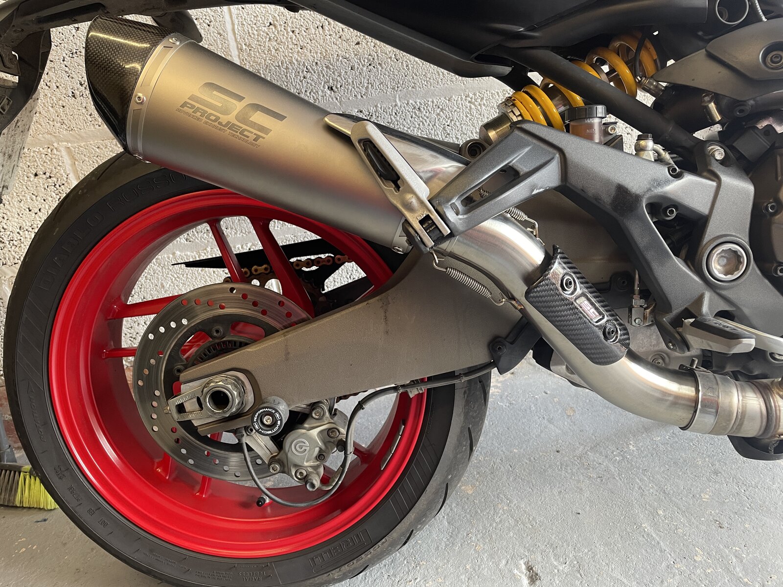

  10. Termi's on a 1200s. Another option for you maybe
  11. I would like some Termis, but getting hold of them is difficult, certainly for a 2015 821. They look great though.
