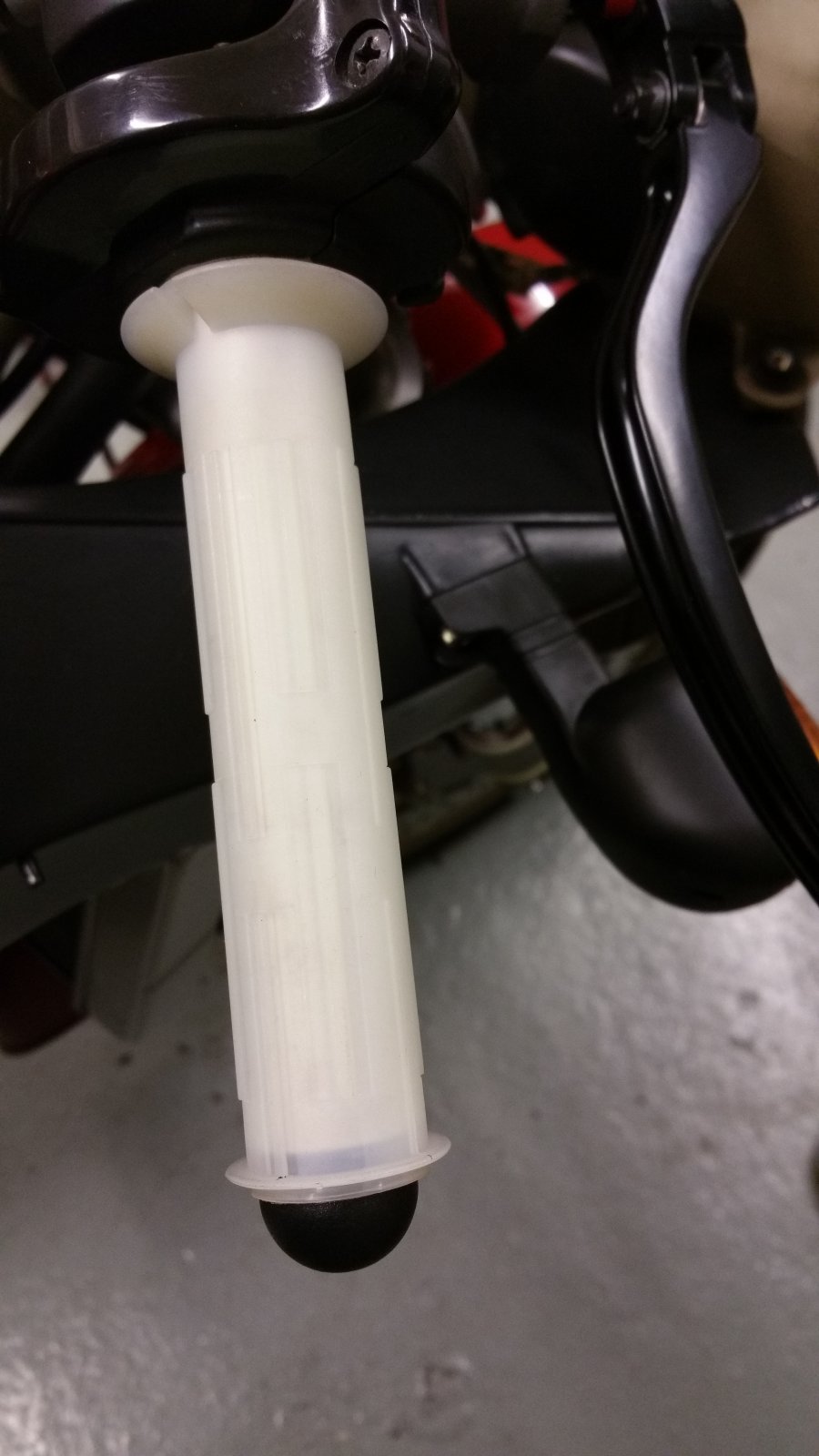

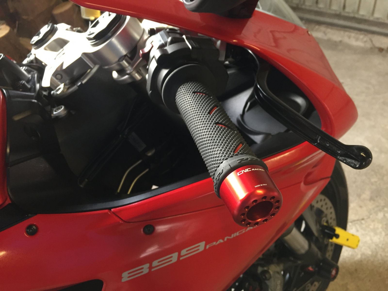

  1. I'm after some help please, fitting some new 717 progrip grips to my 996. Removed the old grips and
    now ready to install the new. On the throttle side, on the tube end, is a raised edge (see photo), I have never installed new ones before but that edge looks like a real pain to slide the new grip over. I have got some none adhesive fitting spray so this wil help.
  2. Soak the grip in hot water first to soften it. Andy
  3. and use the fitting spray? No need to cut that edge off?
  4. I fitted progrips to mine and can't remember having to trim that lip off.
