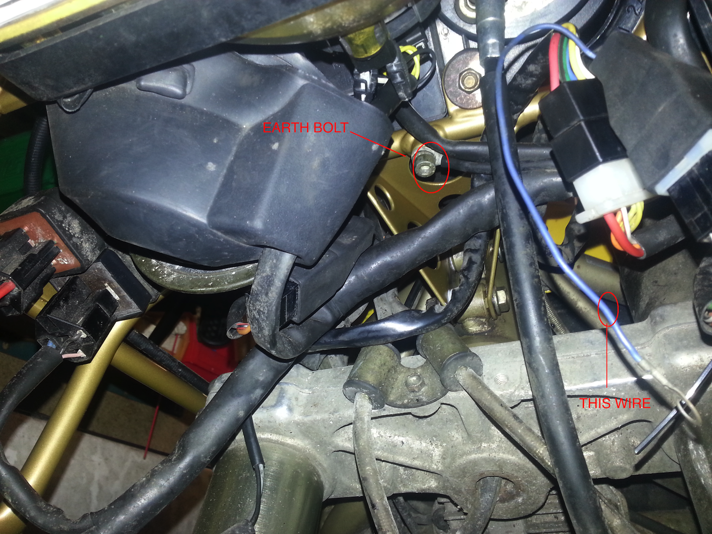

  1. Carbie 900ss I have had the front sub frame powder coated. Lovely, but I should have recorded the wiring when taking it apart. Theres a blue wire with a eye crimp on it , I think it goes on the sub frame earth bolt but I'd like to be sure . Can anyone confirm , Cheers.
    Theres supposed to be a picky with this but it wont go up the telephone wire , hang on ..

  2. Try it, see what works and what doesn't.............I'm pretty sure that's where I connected the blue wire on mine.
  3. Blue wire is the earth for the horn.
  4. Yes, it's from the lhs switchgear and goes to earth. Might wanna mmake sure the earth is bare metal and not coated over for a proper ground. Might be ok though.
    Mick..
  5. Great Thanks guys. Ye meant to say it goes to lh switch. I think think then the other wire on there brings earth from the battery. Ill measure it to make sure zero.
