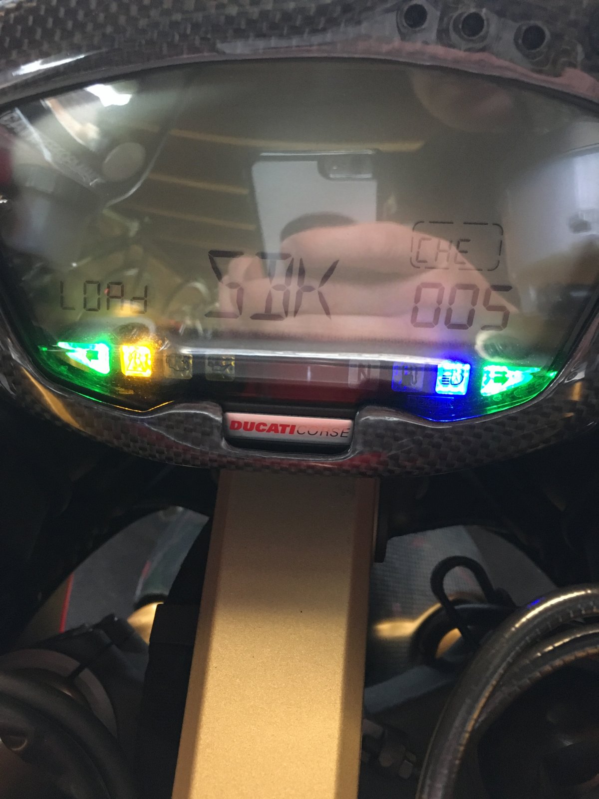

    Took bike out, filled up at petrol station and now it won't start.?
    Got what I think is a code saying load, chef in a box and then underneath 005...

    Just can't get my head around the dash display.?
    Also what is r/r.?

  7. Nothing at all happens, won't turn over. I Didn't check to see if it drops when I try and start it. The horn works and the light pass button but indicators and full beam don't.?
    Have checked the obvious side stand thing but not that.
    Can't understand why it says LOAD on the dash.?

  8. Those errors are certainly new to me!
    Do you have different battery to try? Remember V is the volts which isn't what starts the bike.
    Taking the battery on and off isn't going to reset anything.
    Have toggled the l/h switch to check for other errors?
  9. Have tried all the switches. The up and down mode switch doesn't move to any other codes all that is on the dash is what is in the picture with all the lights at the bottom running back and forth like the knight rider...

  11. What? The dash lights are actually flashing?
  12. Yep, running from both sides starting at the indicators, meeting in the middle and the going back out again... Just like knight rider...
