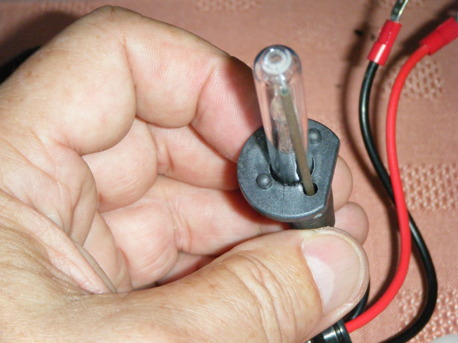

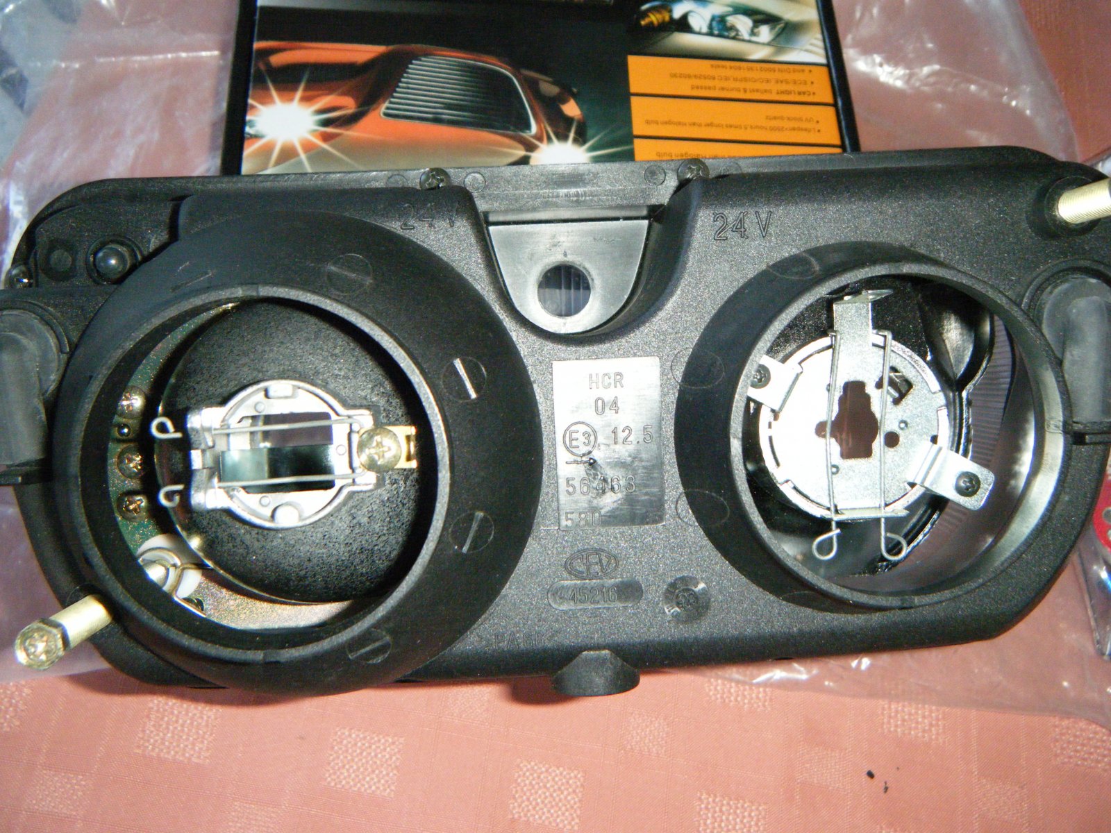

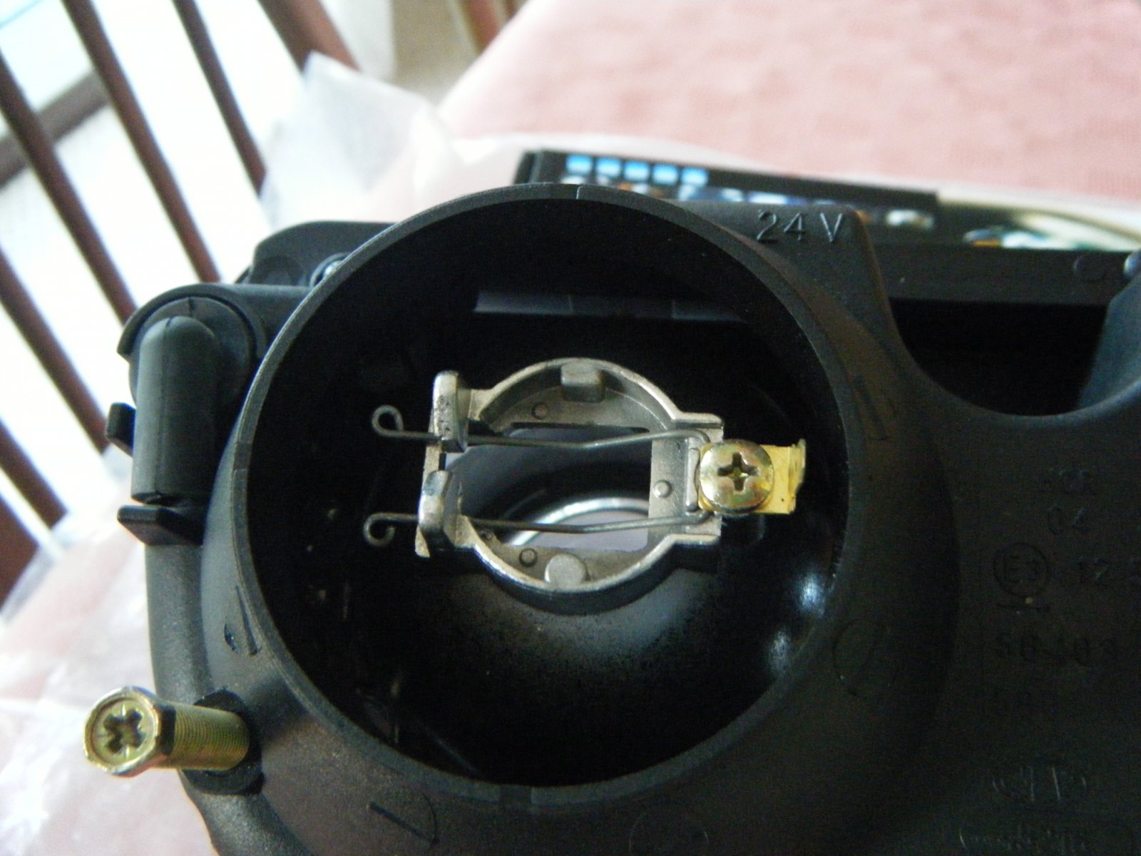

    New (i.e. different second hand) headlight unit purchased. I can see what you mean Bob about the main beam, there is no 'cut off' in the main (reflector) beam. I now have a problem with the bulbs. I got H1 bulbs as they said they were for ST4 but they do not appear to fit the dipped side of the light unit. (see pics of bulb, headlight unit, and the dipped beam side of the headlight fitting)
    Can someone tell me what the correct bulb fittings are for this light unit, dipped and main, please?
    Cheers B :)

  18. Your standard dip beam projector looks like a H3 to me, the main beam is H1. Try Google image search on H3 and you will see.
    If I were you then I would just pop a Bi-xenon projector in there and that will use a H1, but will give you a HID dip and main beam while ignoring the other side.
    I have just written an article HERE.
