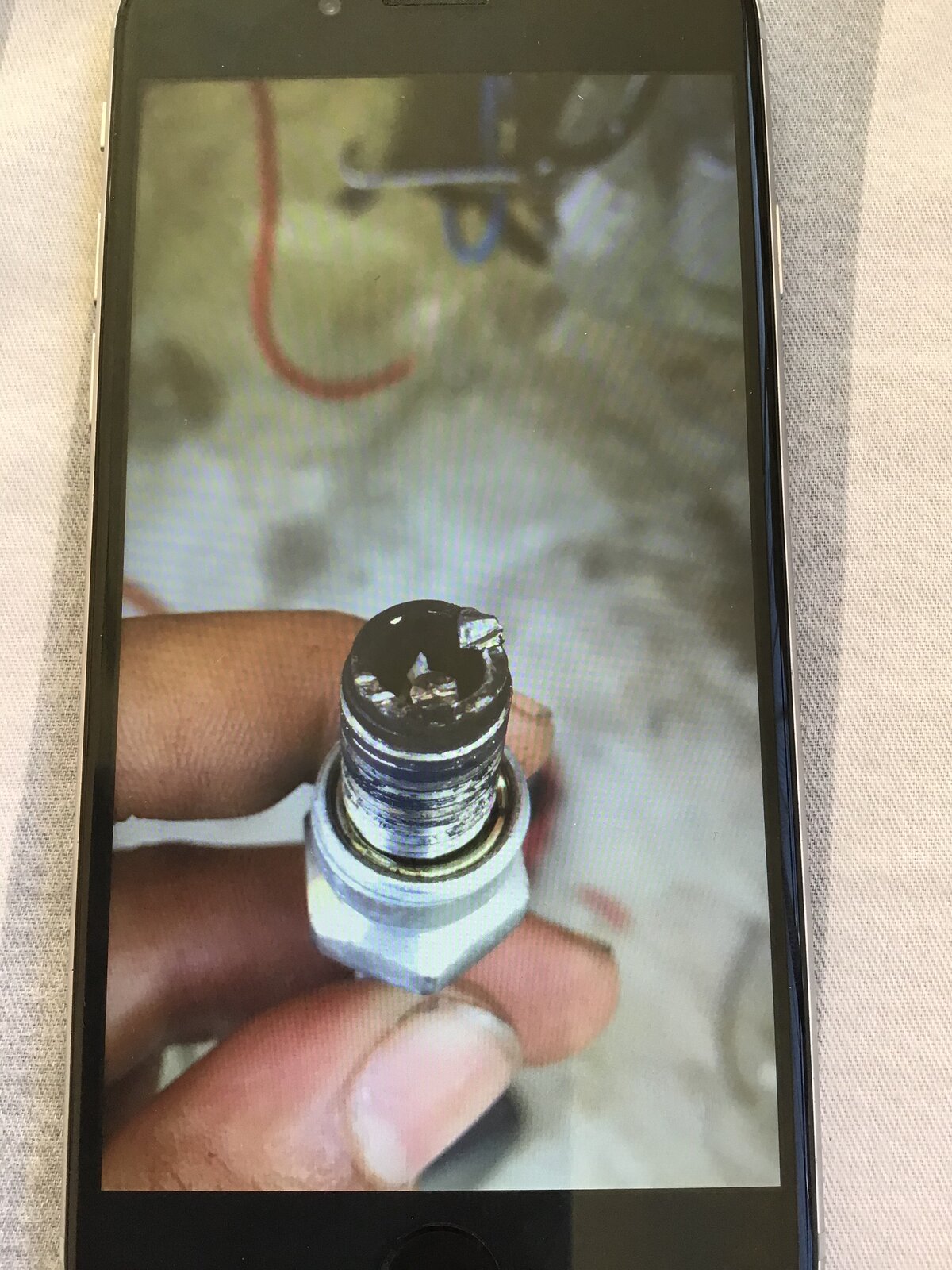

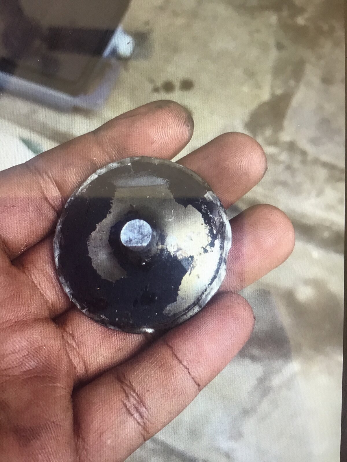

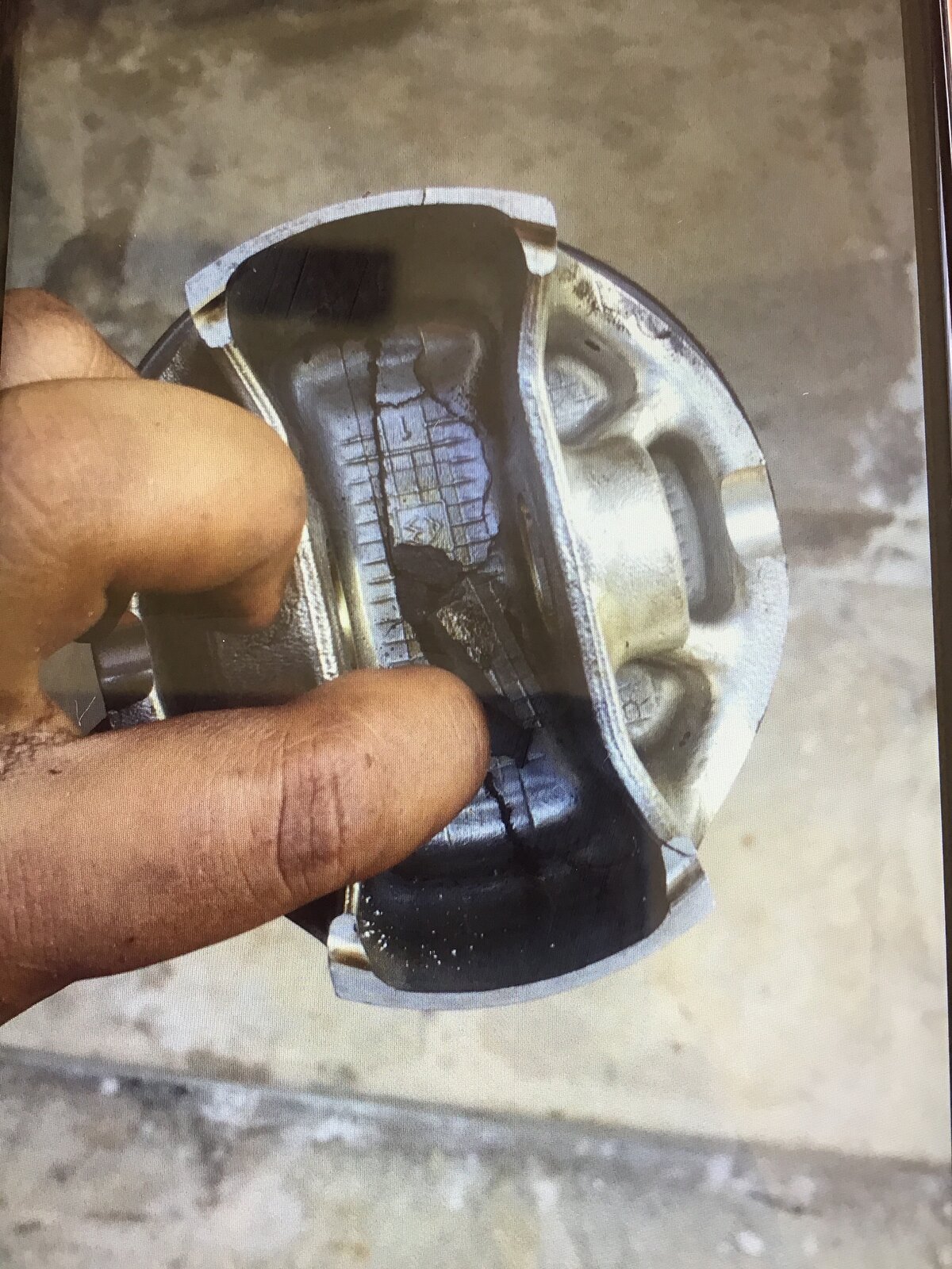

  13. Engine does not crank at all,I tried putting the positive cable still now movement.I checked the plugs one of the cyclinder broke both of the spark plug.and the particles some were melted on the piston.I have removed all the plugs still no cranking.tomorrow am planning to open the cylinder head see what’s damaged.
  14. looks bad maybe dropped a valve or bent con rod , hope it's not to bad
  15. Bad news ,piston and valve is damaged.any idea how much it cost?I live in Kenya and there is no Ducati dealer at all. image.jpg image.jpg
