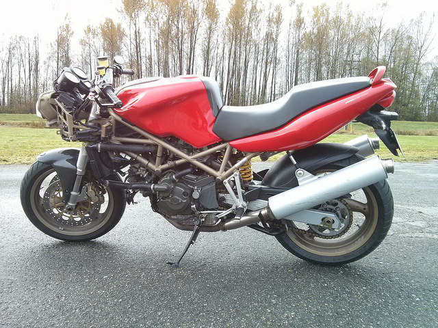

    Last year I purchased a 2000 St2 with 6300 miles and a story. It came to Canada via the US and was stolen early in its life and written off. I rode it all summer and fall doing mods and upgrades and generally enjoying the bike. ST's are crap from the factory. Period. The fueling is completely messed up, so I added a DP Chip, opened up the airbox and that helped resolve most of the issues. Late fall I was doing a service on her and took it for a spin without the fairings. It was a bit of a revelation for me. I enjoyed the lightness and how quickly it wanted to drop into corners and thought... hmm naked bike.
    This being my first real project I simply took it one step at a time. The ST has tonnes of junk to hide. It was a real challenge to get it all tucked away nicely and most importantly neatly. Here is the before:
    This was the fateful day I rode it naked:

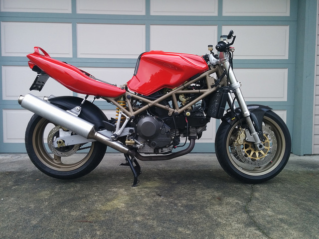

    Picked up a set of Rizoma bar end mirrors and the battery removed. Fabricated some hangers for the mufflers.
    [​IMG]ST2 Leggera Project by Brubache, on Flickr

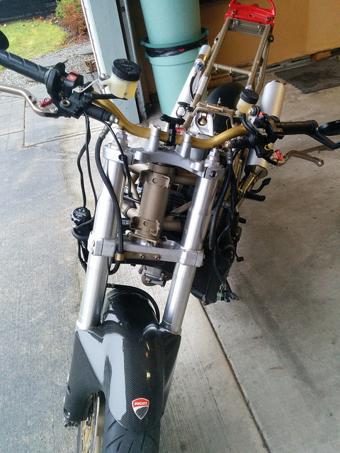

    Purchased a Monster 620 upper yoke and a Renthal Bar. Fabricated a nasty fender eliminator

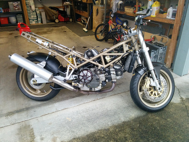

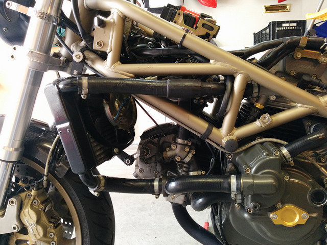

    Stripped for wiring

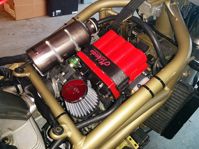

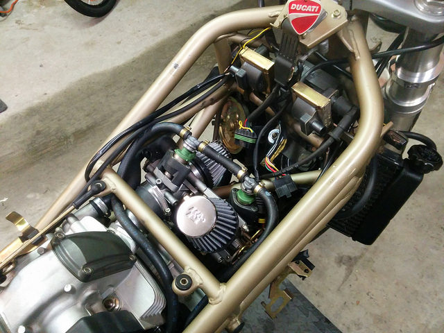

    Relocated coils, rectifier, air sensor, temp sensor
    Getting a feeling for it. Found a used DP Open exhaust. FUN!

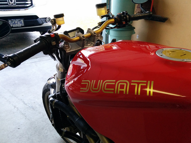

  6. Added some classid Ducati lettering

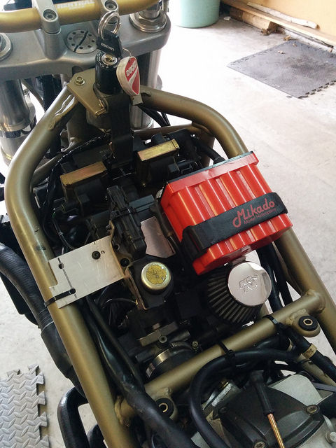

    8 Cell lithium battery and overflow bottle under the tank.

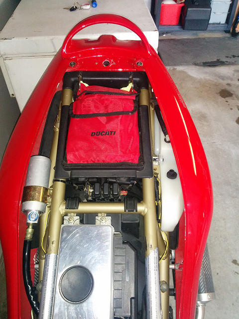

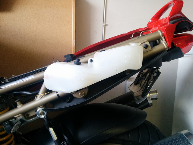

    I got nervous about the overflow sitting under that tank and decided it would be awesome moved to the tail. I mangled the fender eliminator in this pic... opps.
    Fits nicely and neatly away

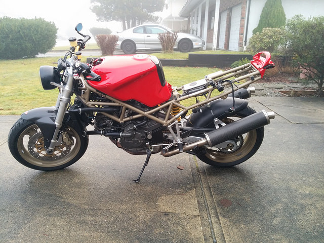

  7. More details to tackle. As I ride her now every day it is a process that will take time and will go slow, but it is progress never the less.

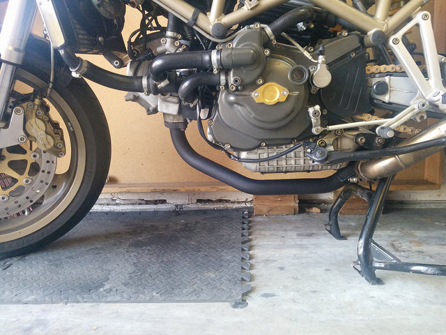

    Ceramic coated the headers on a weekend.
    Slimmed down the rear hugger

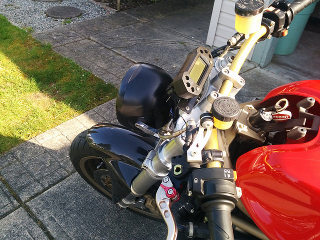

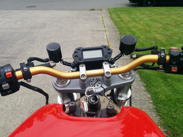

    Fabricated new bracket and moved the Koso up higher on the tripple. Much better.
    Yup better location for sure!

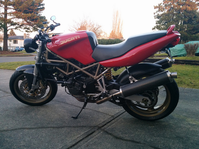

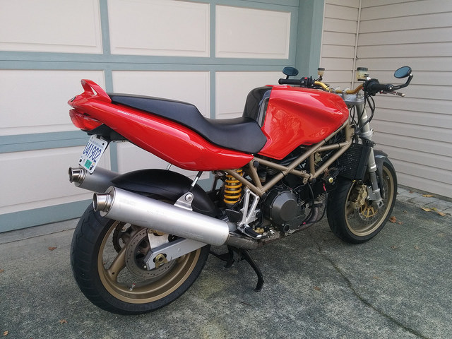

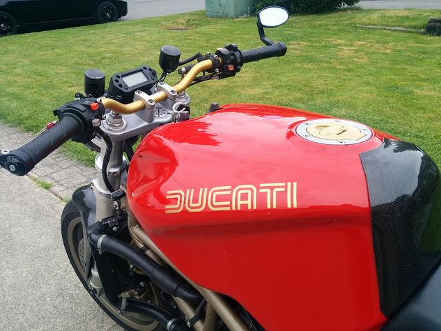

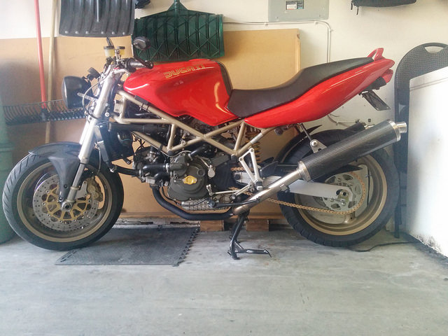

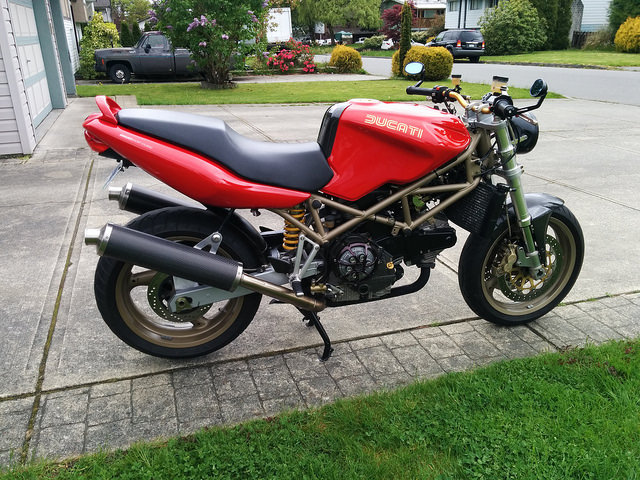

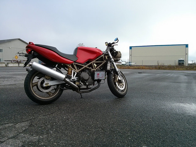

  8. Finally found a set of Rizoma tanks I could afford. Nice and clean now!
    And thats where she sits today. I am now working on some visual fixes to lighten up the tail a bit. Because I have not tampered with the rear it looks a tad heavy in the back. I have some ideas about what to do so thats next up on the agenda.
    Thanks for reading. Feel free to comment slag or otherwise. I know many will say, just get a monster. You miss the point. Monster does not have these ergos, or watercooled 2v motor. Now that it weighs closer to 400lbs it absolutely is a rip roaring blast to ride. Lastly... everyone has a monster :) This was and is much more fun to build and play with.

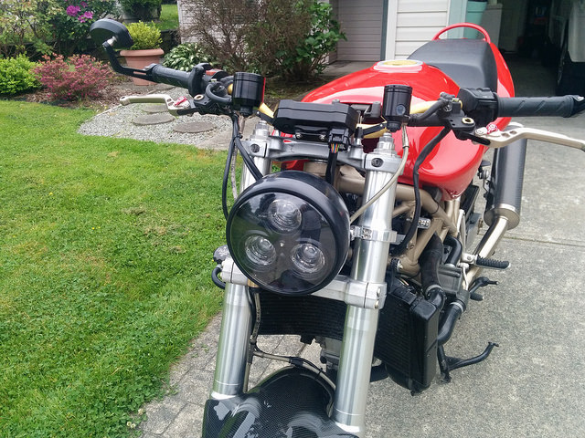

  9. Interesting LED headlamp unit, tell me more.
    Is it much better? What size is it I could do with something for my Guzzi
    John
  10. nice job need to radicalize the exhaust and sort outs its fat ass but nice front end
  11. Need to tidy that l/h switch wiring.
    Looking good.
  12. nice work!
  13. nice work discreet mods,shorter exhausts and seat are a must.
  14. The stock light is so bad that anything is an improvement. Its great for being seen with. There are definitely better higher end units if you actually ride at night. So.. I would say its OK but not super. That said it was cheap.
