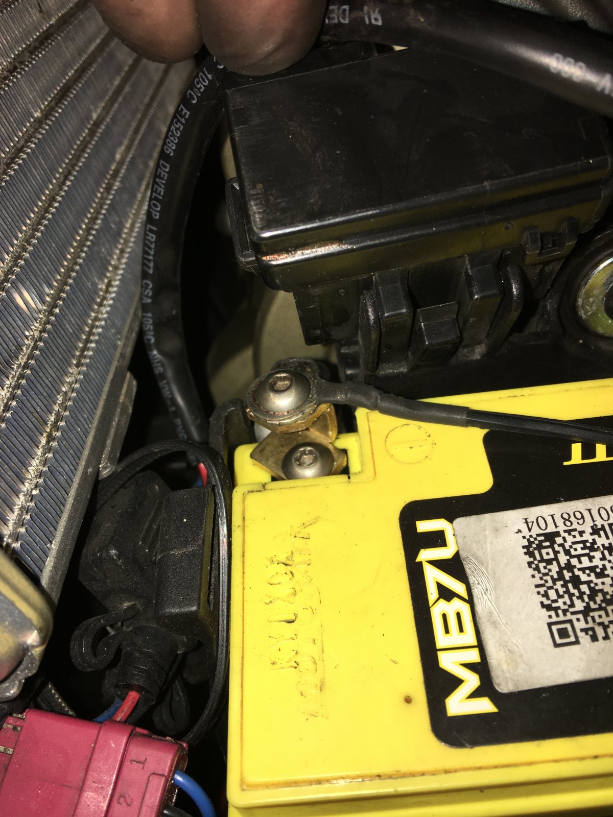

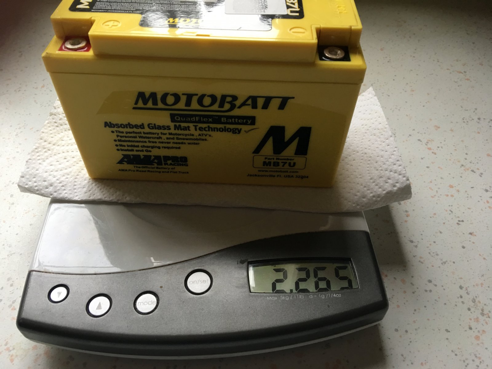

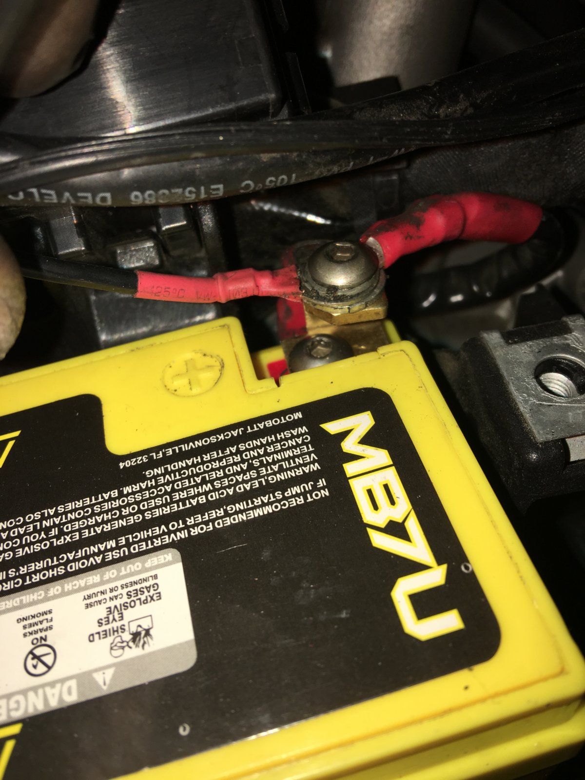

  1. Fitted a new Motobatt battery to the Panigale. Should have been dead easy but was painful. The posts that came with the battery were fractionally too high. I could pull up the positive cable to the terminal but the negative is very short and was a swine.
    This was the awkward one. There just wasn't enough length on the neg cable. It wouldn't move up and it wouldn't move down. Got there in the end and saved a few grams. Not that I'll ever notice it, that's why I didn't go for the lithium one.
    In the end I had to make the connections at the top first then screw the post into the battery.
    Anybody else found this with a Motobatt battery?

  3. That doesn't surprise me. As I was finally tightening it up I thought 'There may be trouble ahead.'
    I wondered if a drop of locktight was a good idea but figured it might effect the current flow.
  4. Loctite would be fine as long as it doesn't get on the mating surfaces of the post and terminal adaptor.
    You may have been better bolting the cables directly to the posts?.
    A quick wiggle every now and then to make sure they're still tight and you should be ok.

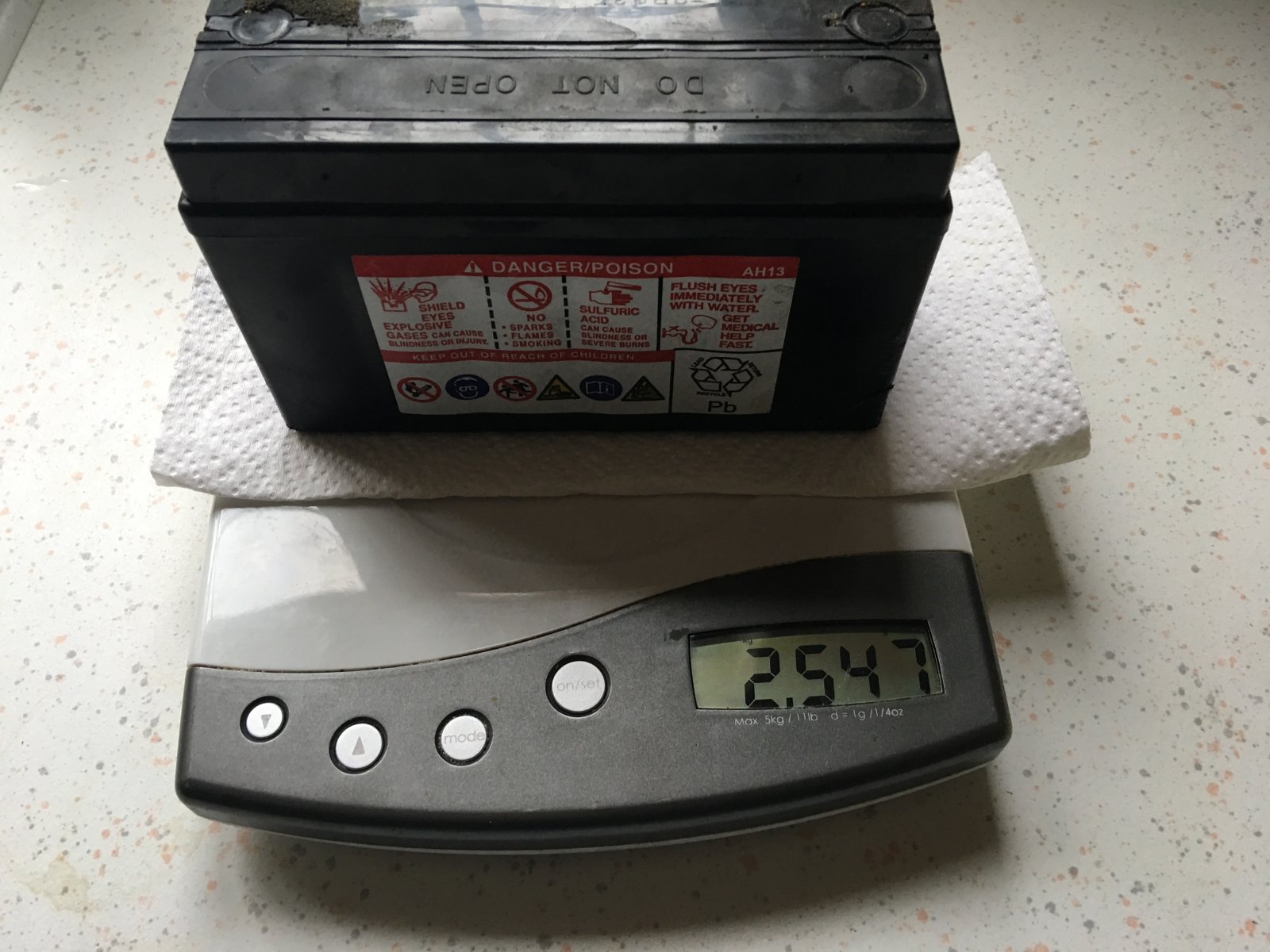

  6. My Lithium that I fitted to the 848 weighed in at 600 grams - just saying.
