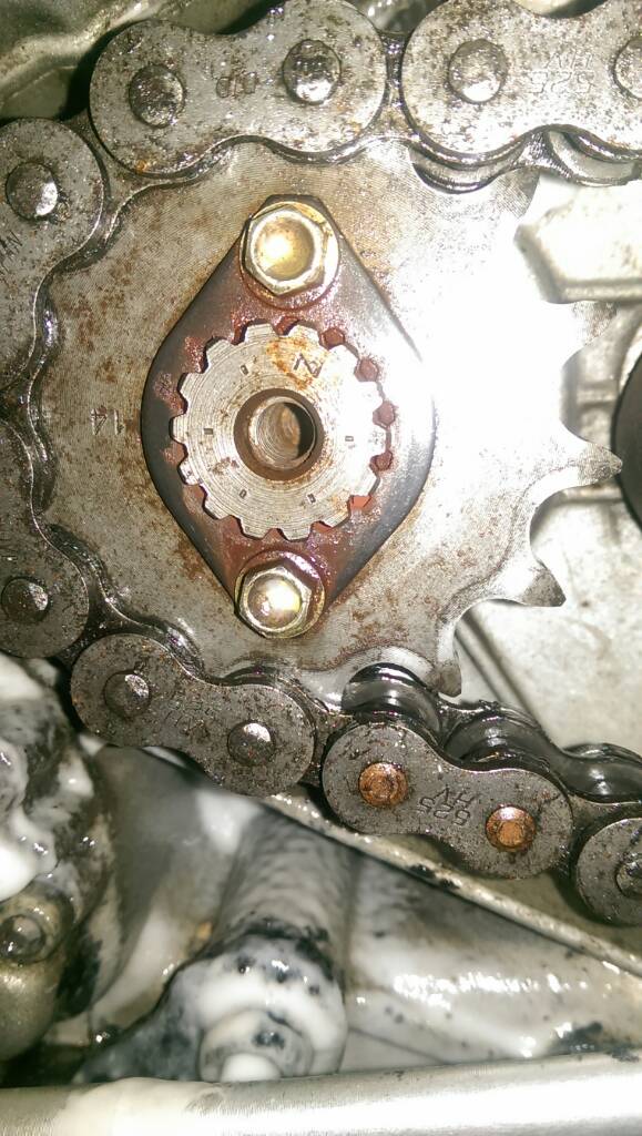

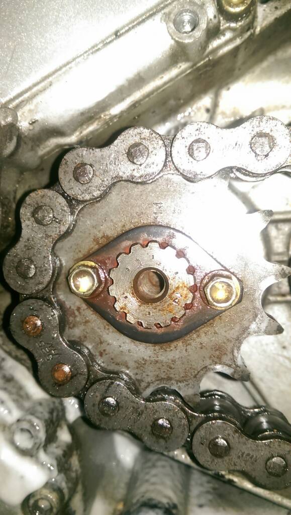

    996. Does this front look worn? I have no idea on mileage it's done or age. (Its not so rusty in real life before anyone starts).
    Chain needs adjusting too, do I just measure distance between X lengths as per Mr Haynes?
    Cheers

  4. The front sprocket teeth don't look excessively worn if that's what you mean. I'd look closer at the rear sprocket but it seems rare these days to use them until the teeth are visibly asymmetric (let alone "hooked"), and usually it is chain wear that determines replacement. Three things I'd take into account are:
    - Are you able to tension the chain properly within the range of adjustment provided for the rear wheel? Sorry, but I don't know how that's done with the 996.
    - Is there any significant "tight spot"? Last time I changed a chain there was some rear wheel adjustment left, but if you had the right tension in one place, it was like a bow-string once the wheel had been turned to a different position.
    - Can you, at the rear sprocket, half way between the two points at which the chain joins and leaves the sprocket, pull a link away from the sprocket to any extent? If so, it could well be worn enough to deserve replacement.

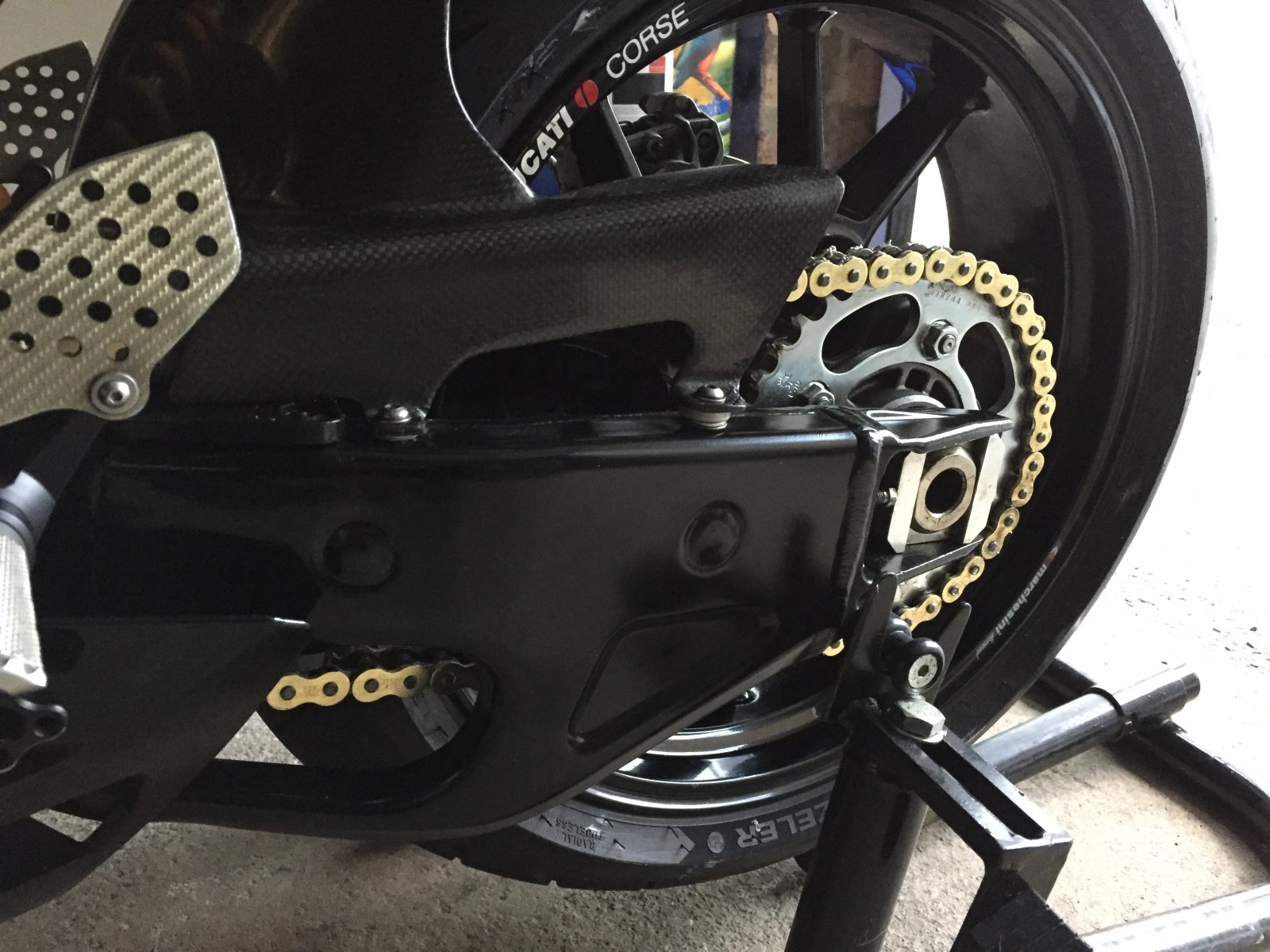

  9. New CnS looks lovely. Harder to judge stretch on SSSA than twin as no marking on hub.

  10. CR your sprocket is hooked every second tooth, check the top edge of the tooth at 4 o'clock in picture 1 and every second tooth from there round. It needs changing otherwise it will prematurely wear the chain and rear sprocket. For £15 to £20 not changing it is a false economy. Also I would recommend trying to change the ratio slightly and strongly recommend a 15T as the 14T one that is partly why the wear is asymmetric - the chain is engaging the same way every cycle which means accelerated wear on every second tooth as the sprockets wear and eventually the load is only taken on every second tooth (which is what is happening now). If you get a new one compare the drive side of unworn and worn, look at the side wear pattern and you will see what I am on about.

  11. Hhuumm. Just checked and pull off rear sprocket not too bad and no real bad tight spot.
    She is running 14/36 so if I go 15 up front I'll lose rideability and acceleration unless I change the back +2 or +3. In which case I may as well just buy a new CnS set and start afresh?
    Can the front sprocket be spun round the other way and moved on a link? Or should I just by another 14T till next winter and then fit a new set? I only do 1500mls max a year on her.
    • Nuke Post Nuke Post x 1
