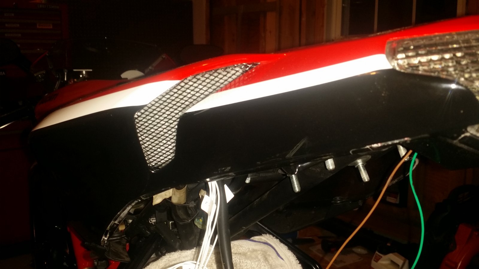

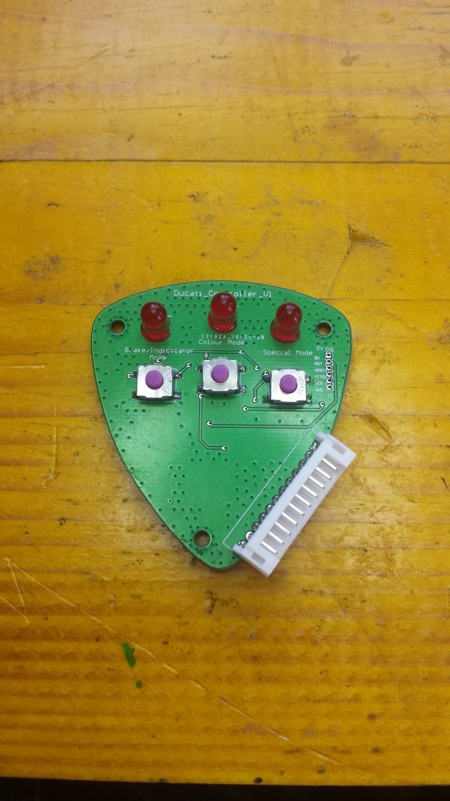

    My name is Brian and I am from Boston, MA USA. I love Ducati's and have always wanted some custom lights for the inside of my grills on the back of the tail of my 848 corse.
    After a few years and nobody making such a light, i decided to make them myself!
    My website (www.brakers.com) has a video of the functionality and i have attached some photos of me messing around with a test unit.
    What do you guys think??? Trying to make these things a reality if people think they are cool.
    Appreciate the feedback, cheers![​IMG]
    PS - Love the forum, very slick and responsive interface unlike any site i have been on before!!!
  2. They look very interesting but more information is needed. What sort of price are they? Can they function as brake lights (red) and indicators (orange in Europe) at the same time. Are the LEDs angled to point to the rear or are they flush with the board/grill?
    They look just the sort of thing that I would be happy to fit and at a decent price would save me from making them and then blogging how to make them!

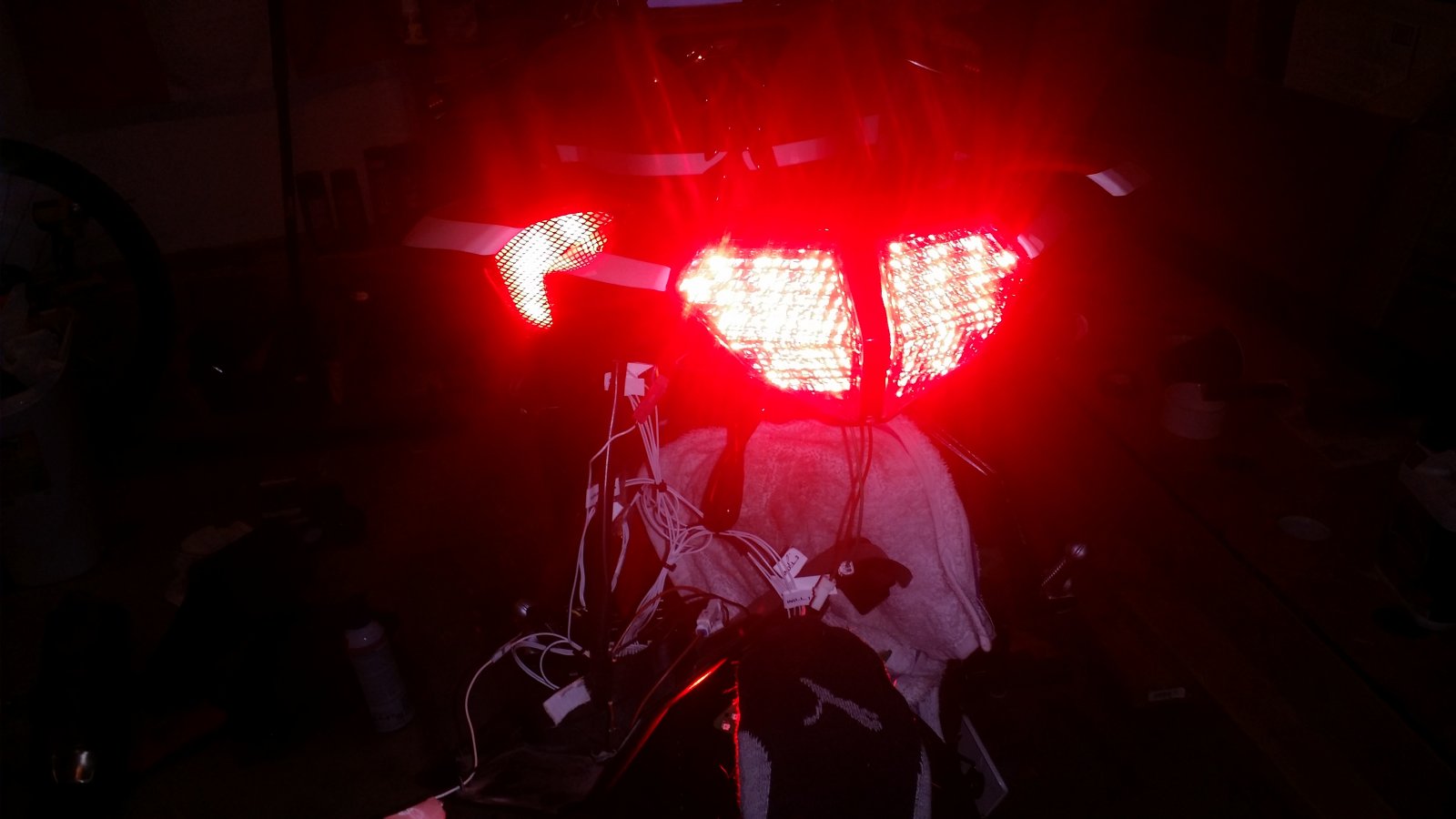

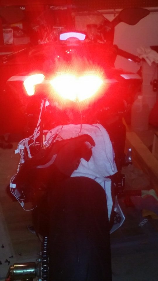

    They have 3 main modes which are shown on the youtube video on my site:
    -Brakes only (special modes: solid red or 3 burst flash then solid)
    -Indicators only (special modes: solid orange or sequential blink)
    -Brakes and Indicators
    They are also compatible with aftermarket tail lights like TST industries integrated tail light, so you can run them in parallel with your existing lights for greater visibility.
    Great detail also being paid attention to the angle which the LEDS throw out their light. These things are super bright already!!!!

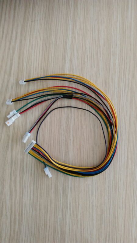

    Wire harness will come with it so ZERO splicing. :)

  8. These look very smart indeed and I really like the flexibility built into the product, very thoughtfully made piece of quality kit.
    Just loving the Ducati shaped controller board too

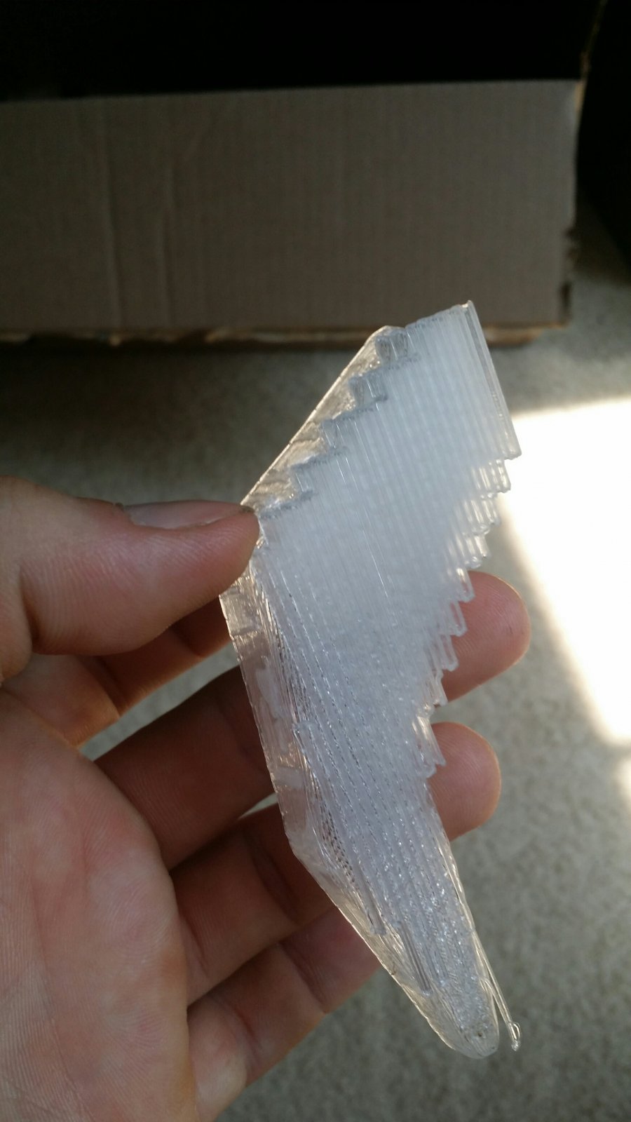

    My only aesthetic query is that I don't like that you can see the LED plastic cover (think that's what it is) through the vents. That might just be the way it was photographed though. Can that be smoked plastic so it looks dark, or the lights fitted further back?
  10. Estimated price range is in my previous post.

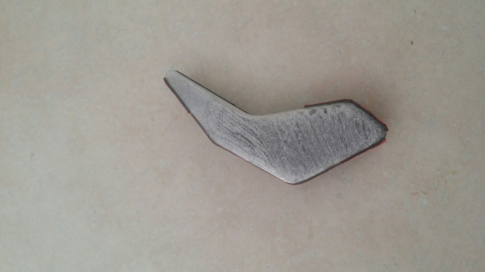

    The example photo you are seeing is of a 3d printed "clear" cover, which is why its so obvious behind the grill. Here is another photo of the same part to give you a better idea of why i have "clear" in parens. Due to the angles of the face and some limitations of my 3d printer, i was not able to get a nice clear print so it comes out white-ish in photos. All that crap you see on the top is "bridge" material that gets broken off when the print is done.
    The final product will be injection molded plastic like the tail light on the bike (smooth finish), likely smoked black to blend in even more behind the metal mesh. I will be sure to post up some pictures of different color options for the plastic to get everyones feedback once i meet with my injection mold guy again and get samples.
